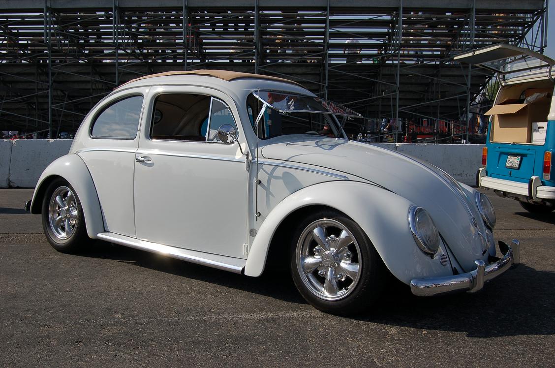

where can i get one are they reopo OG or home made i have a 59 bug

im in the process of makeing aa front safari for my bug. I used two late model popouts, i cleaned them of all the old rubber and then cooked them in my oven at 500 for about 30 min than my wife and i formed it around the windsheild. looks bad as* . if you figure in the cost of the windsheild ($79) used pop-outs ($50) front latches ($80) sliders ($30)
Seals ($30) hardware and hinges ($120). (total of about 400)
It all adds up after some time. Their was a rumor that someware in the UK they had a kit that sold for around 650 and everyone said that was way to high but after building one i can see why. i have yet to finish mine still broke from christmas Very Happy

Actually my friend is in the final stages of finishing his front safari's up as well.. He should have his finished for this years events... He also used pop out frames but he slowly hand bent them around the glass.. still looks killer!! good luck to all that try lol... it takes a heluva lot of time.

i tried that the first time it was just much easier to heat it up to bend it around didnt have to force it at all only took me about one and a half hour to build the frame.

how did you finish off the gaps? did you braze it or just bolt it together, and did you cut into the top of your headliner frame or do the hinge a different way..

PostPosted: Mon Jan 07, 2008 9:18 pm    Post subject: Reply with quote
bolted together using three factory hinges along the top is how I am doing it that way all i have to do is drill 15 holes in my window lip just like the 1/4 window popouts. if your cuts are good and flush the frame will come together just like the factory seam. you also have to notch the lip on each side for the sliders

yea just two pop-out will do cut off both 90 degree corners i cut min at 54 inches and used a sharpie to mark a center line on the winsheild when i formed each side i started about an inch past the center line once both halves are formed then make your final cuts so that they sit flush to each other you dont want any gap what so ever. the sliders and latches are the same that are used on bus safaries minus the center mount( not needed of course) hope this helps
