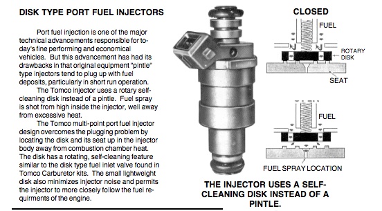

Nice surprize. I just got some of my Tomco injectors. They are a different, and some say better design than the original Bosch injectors. These are "rotory disc" injectors not the standard "pintle" design. Rotory disc designed injectors are less effected by materials that would clog pintel injectors. Here's what one site had to say......
"These injectors incorporate a disk design rather than a pintle design. This gives the injector better spraying capability and resists clogging over the other design. Others claim that a pintle injector will lose up to 47% of its flow capability while the disk design will lose only up to 2%." http://www.gnttype.org/techarea/pictureguides/injectors/32lb.html
The injectors are most likely made by Lucas. They are heavily built, the hoses are crimped on, and the tips are metal not plastic.
Witch hunter said they would test them for me for $32.00. I'll let you know what I find out.

PostPosted: Thu Jan 24, 2008 10:41 pm    Post subject: Reply with quote
More info from the Tomco files.

mattcfish wrote:
Nic These are "rotory disc" injectors not the standard "pintle" design. Rotory disc designed injectors are less effected by materials that would clog pintel injectors.
I was wondering WHY they are less "effected"
Rotary disk design features a self-cleaning disk (no pintle) to prevent carbon deposits and clogged injectors.
I noted the flow rate is a bit higher
Tomco support:
18.13 lbs per hour at 36.25 psi
spec for bosch is
16.1lbs/hr, 36.3 psi
Actual Witch Hunter results:Tomco 15501/Lucas 5202003 (thx matt)
lbs/hr=16.7
rating PSI=36.25
not really much in it Bosch rating is 16.0 tomco/lucas 16.7 & really only an issue during warmup b4 o2 sensor/lamaba starts to take control

Quality comparisons aside (and there's no reason to reject these out of hand on that basis except perhaps for jingoistic superstition), and assuming the fit and spray pattern match OEM, tclark has hit on the main factor in compatibility: flow rate. The stock ECU determines injector duty cycle on the assumption that the injectors flow at a given rate at a given pressure. If the injector flow rate is higher, the actual fuel delivered to the intakes would be more under a given set of conditions. If that were all there was to it, you would find your fuel consumption going up by a factor of 18.13/16.1.
But that's not all there is to it. The lambda control system is going to take over and bring the warm-running mixture back to stoich, easily correcting for the higher flow rate, provided your o2 sensor is doing its job.
Where you might see a difference is during warmup, when the ECU runs open-loop, and at WOT when it does the same. Under WOT conditions the extra flow might be a benefit if your engine can utilise the fuel; that's an open question dependent on the state of tune and overall condition of your engine, but my guess is that the extra fuel would just be wasted. Fuel utilisation by these engines in stock tune is already pretty poor.
While warming up, the mixture will be richer, so that is something to watch for if it makes the motor run poorly until it hits the coolant temp threshhold where lambda takes over. Merely adjusting your CO screw is not likely to provide enough correction here; you may actually need to alter the basic AFM setting.
Other than those things, I can't see any good reasons not to give them a try.
spec for bosch is
I've been told on the EFI Forum that Lucas usually overstates the flow rate. I'll give Witch hunter this information when they test them for me ($8.00/injector).
Tomco says they meet the OE spec. We'll see.
