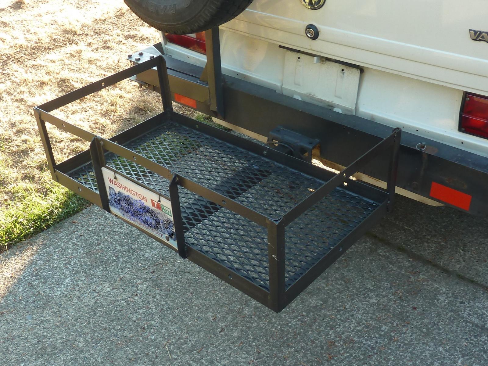

This summer my wife and I took the plunge and picked up some inflatable paddle boards. I quickly learned that we didn’t have a very good way to transport two paddle boards. Two don’t really fit very well in the luggage rack over the cab and paddle boards can be a bit messing to haul inside after using them especially after salt water use.
So I figured a cargo tray for the hitch would be the way to go. All the cargo trays I looked were wider than the tail lights which could be okay if you don’t stack stuff in front the tail lights. I studied the harbor freight trays to see if I could cut them down to size but gave up on that and decided to just make a custom one.
I think mine is a bit over built but I guess it can get banged around and I don’t have to worry about it. It’s a 20” x 36” platform so it fits neatly between the tail lights. Here is what I used:
-1/8” wall thickness for 2” receiver tube
-1/8’ 2”x2” angle for bottom of tray frame
-1/8” 1”x1” angle for top rail uprights
-1/8” 1.25” flat bar for top rail
-flat/smooth expanded metal for bottom, I don’t remember the thickness but it’s less than 1/8”
Two deflated paddle boards stack nicely on the tray. I decided to leave the top rail off the front of the tray facing the bumper to allow for oversize stuff to hang forward of the tray. I can’t imagine the need to use heavier metal than 1/8” and a lighter gauge would probably be fine. Both our paddle boards together weigh about 45-50 pounds. I’ve also used it to haul some firewood and totes which work fine. I do need to wire up a license plate light and I think I’ll add some reflectors to play it safe. My 2wd westy has gowesty lift springs and 27x8.5 grabbers which has kept the tray plenty high off the ground. I don't see any issues with it dragging with on road use or forest service road use. Enjoy some pics.

I have been considering a hitch cargo tray as well, and had the same issue - they tend to block the tail lights.
Thanks for the pics - I think I may want more space, and will go with a small trailer that I can tow probably. Or is it possible to go with a larger cargo tray and wire up some external brake lights??

We had the same concerns about blocking the rear lamps, so we wired up some trailer lights on our cargo carrier. We found this to be easy and inexpensive. As always, it is better to be safe than sorry.
Nice you have the ability to go the custom route. Pro-looking job there! Cool
I've got the standard Hitch Haul, but use a Recon Tailgate Light Bar on it for added safety.
It's also used on my Thule bike rack (initial reason for buying it).

If you're worried about blocking the lights, then you can try and raise up the platform to sit above that level. An added bonus is that it's also less likely to drag into and out of steep driveways. I converted a cheap used swingdown bike carrier for our new cargo carrier. It clears both the lights and hatch, and will work with my T3 and T4.

No roof bars yet however at some point I am going make a pirogue and will need bars up there to haul it around. I did think about doing foam pads/blocks and rain gutter straps to all the paddle boards on the top. Those inflatable paddle boards are some exercise to inflate each time.
As for the spare tire blocking the tail lights, the spare sits well above the lights. I set the height of the spare above the height of a passenger car hood like a Camry so if I get bumped by a car it may prevent the spare from taking out the back hatch. An SUV or truck would definitely push the spare into the hatch.
Kamz I like the way the reflectors on your tray wrap around the sides, I think I'll copy that. I have also thought of either running lights back there or a brake light just to people catch on that something is stick out the back.
As for platform height I did think about going higher but I didn't want to block opening the hatch with the paddle boards back there. I also thought about doing a swing out but had to get this thing built for a trip so it ended up be a basic tray. These trays seem like a good way to carry extra stuff, I can see adding a big tote for dry storage of gear.
