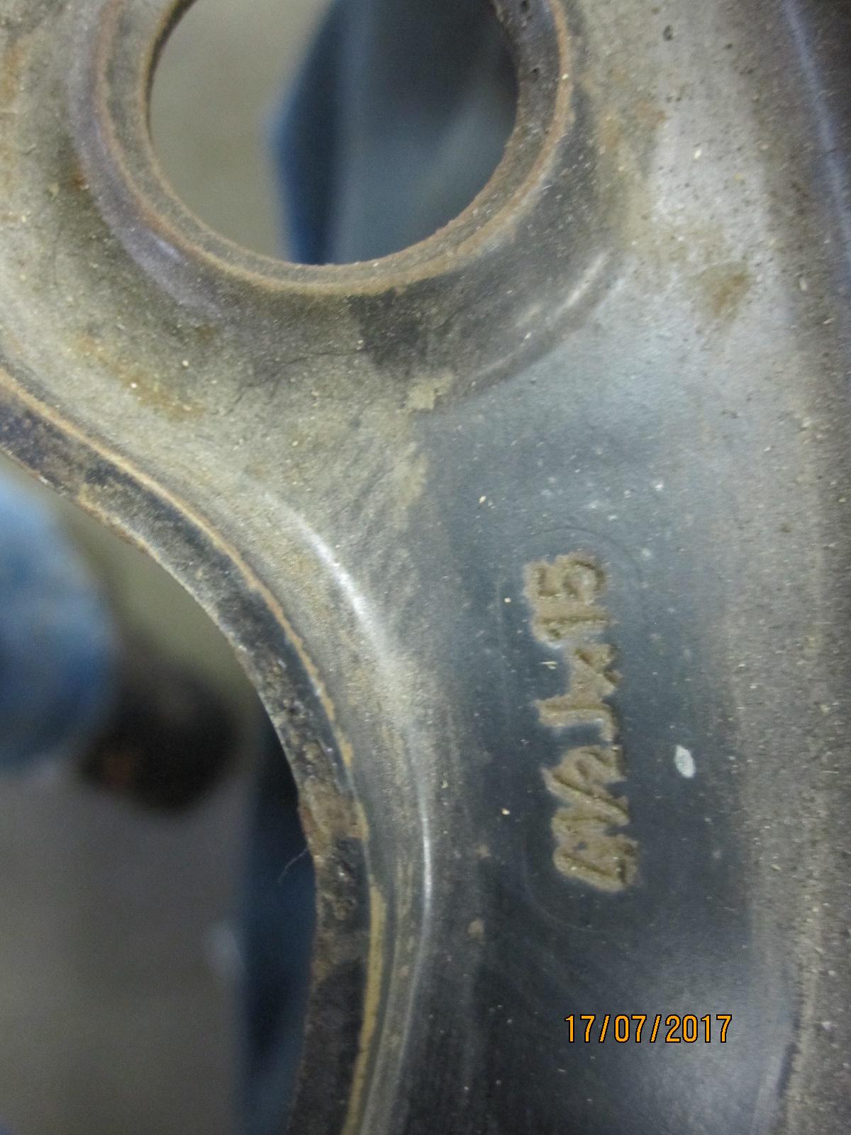

So, if i have 2 rims that are stamped 5jk 14, both with a date stamp of 10 67, does that mean these were some of the earliest 68 thing rims? Or did something else use 5jk14 wheels? Thanks, rob

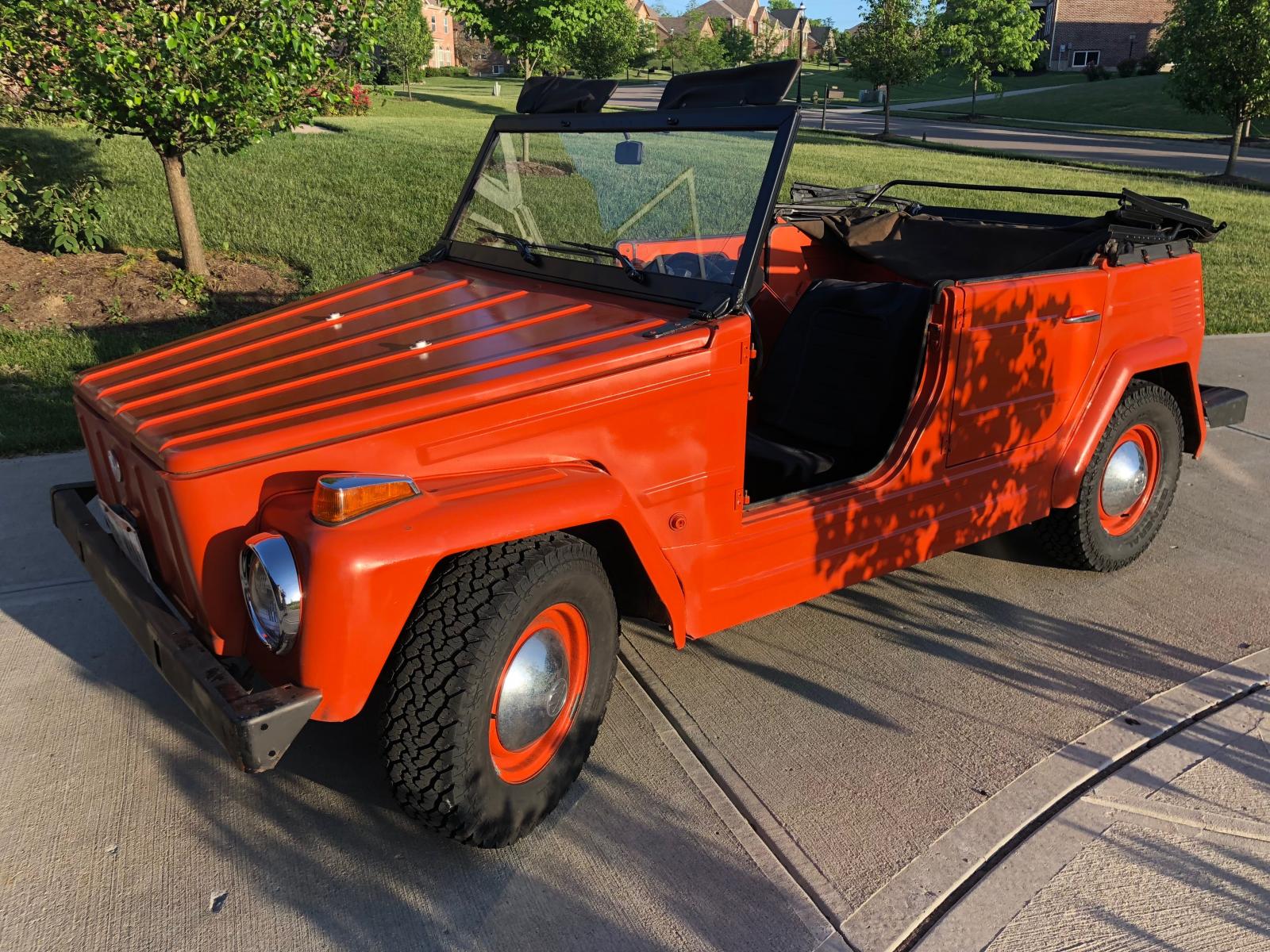

klokard wrote:
I am running stock 181 wheels, powder coated stock silver with original style hubcaps. I have the McCreary G78X14 all terraine tires on them.
What was the powder coat color code you used?

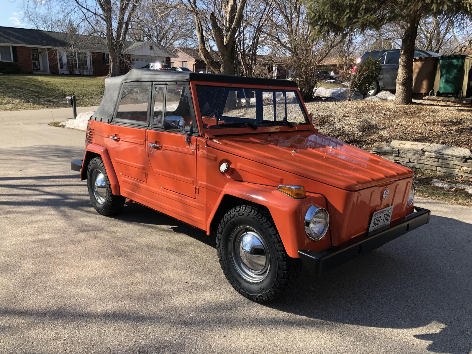

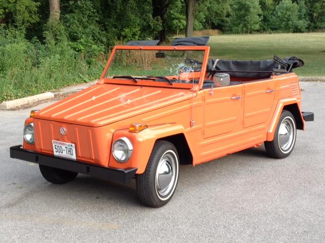

PostPosted: Sun Mar 17, 2019 5:50 pm    Post subject: Re: Wheel/Tire FAQs-Wheel/Tire questions/answers? Start here! Reply with quote
Just had my wheels powder coated. Took off the skinny old white stripes and had a set of General Grabber ATx’s fitted (27x8.5 R14). No rubbing even at the stops, drives straight and true at 60+ mph.
Before:
After:
