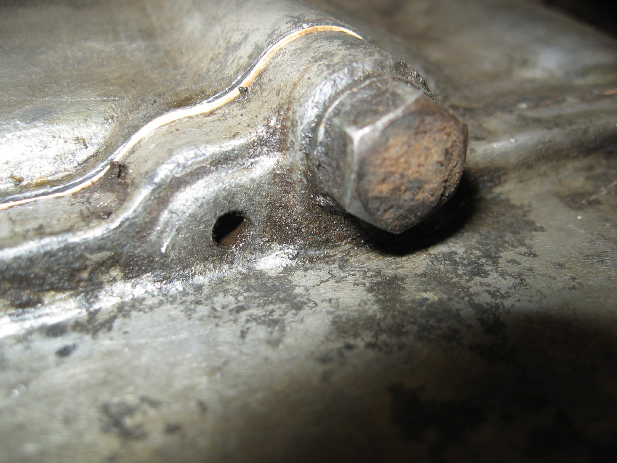

Having just done some work on my nosecone, I can tell you mine was clogged solid with a mixture of grease, oil, and mud. I cleaned it up, and when I put a new gasket in, I notice that the gasket covers and blocks this vent hole. Is that supposed to be the case? It would seem to go against the reason for having the hole in the first place. There is no punch out or matching hole in the gasket (came from Long Enterprises). Or, will it still provide adequate ventilation?

Hi Joey - there was no hole in the original gasket (although I wasn't particularly looking for one), and there is no hole through on the other side of the flange. The hole goes straight through to the other side on the nose cone, and doesn't angle downwards at all.

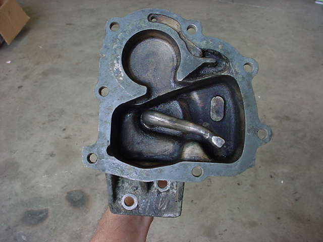

There should be a slot on the nose cone for the hole. No hole in the gasket or the other housing side.
This pic is not a bay bus nosecone but you can see the small hole at the top to get the idea of the breather hole.
If you have oil in the trans, stand it up on end & the oil will come out... breather is not blocked. Or just roll it over, upside down, oil will come out, not blocked. I usually unblock the hole with the trans upside down to make sure the dirt flows out & not poked into the trans.
By this time most breather holes are clogged & as the oil heats up & expands there is no where to releave the pressure. It will leak out of the next easiest place. Usually the flange seals & fling all over the under carriage. Or into the bellhousing from the input shaft seal & get all over the clutch.

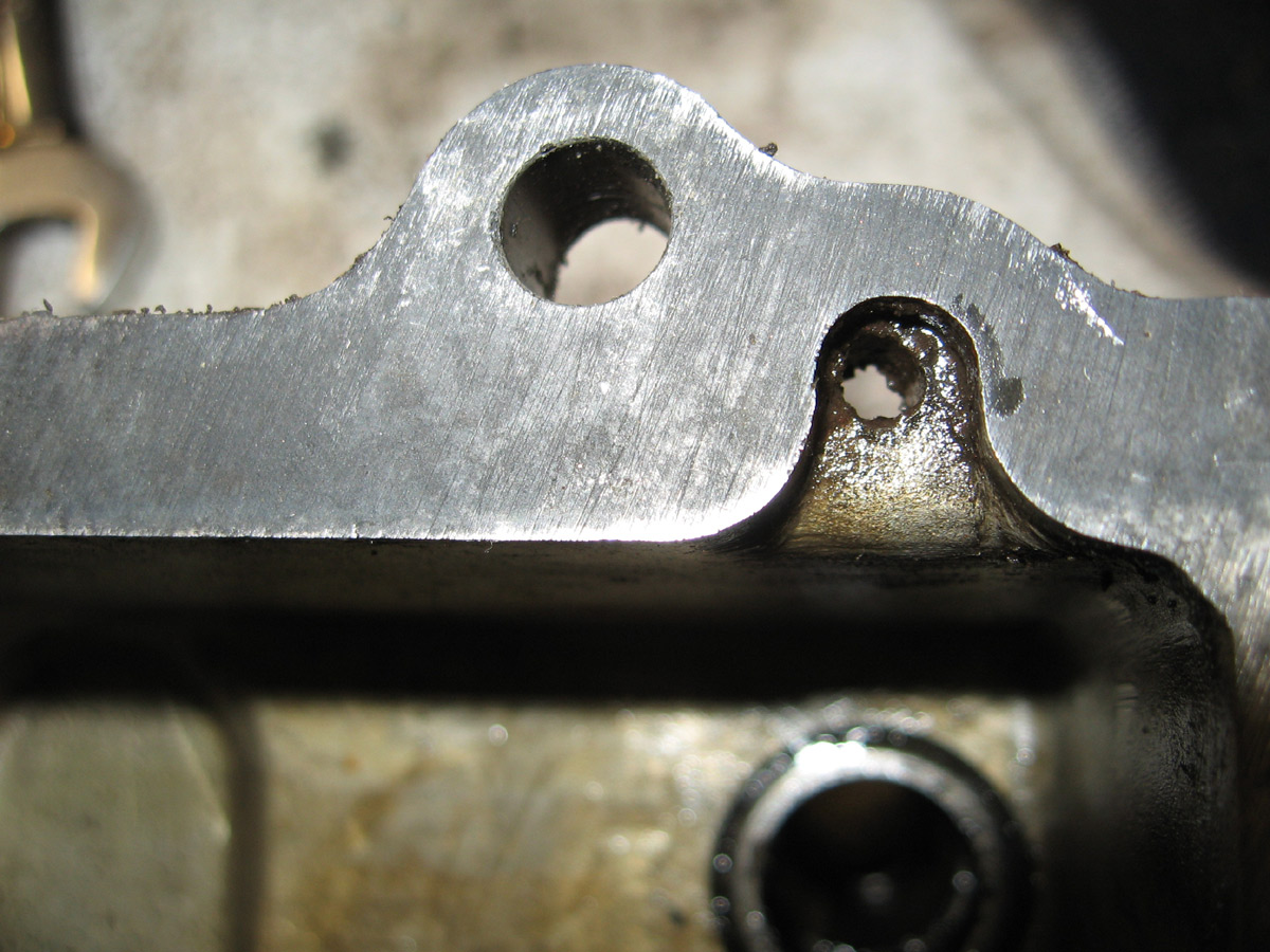

Thanks for everyone's help. I took the nose cone off again just to check it out. I didn't notice it when I had it off before. There is indeed a "recess".

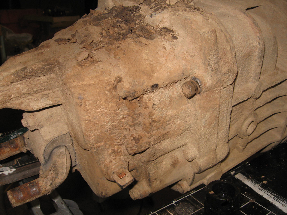

My nose cone has been cleaned up considerably. It was covered in caked on mud, grease and oil, although I guess it doesn't look like it in the above photos. Below is what it looked like when I started. Those flakes on top are where I started with a screwdriver to get some of the gunk off - about 1/8" to 1/4" inch of stuff. See the vent hole? Exactly. Laughing Can't even see the nose cone bolts. Shocked

Darryl, that was a dirty transmission... dirty but dry from oil leaks. Maybe you better stay off those logging roads..... nah!
