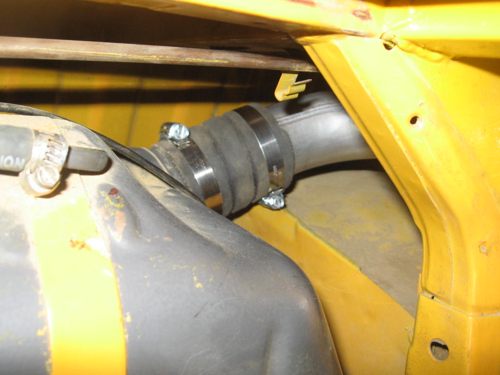

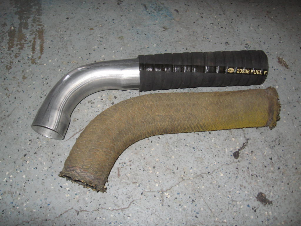

PostPosted: Mon Apr 28, 2008 8:04 pm    Post subject: Reply with quote
here are pics of filler hose
i took the OG filler hose with me to muffler shop & asked for exhaust tube with same bend as hose ($15)
then added 1ft strait filler hose ($20)cut into 2 pieces
[img]
[/img]
[img]
[/img]
[img]
[/img]

PostPosted: Mon Apr 28, 2008 8:55 pm    Post subject: Reply with quote
Nice work, that's nearly exactly what I ended up doing, except the flexible hose was a different variety. No leaks & no fumes.
i took the OG filler hose with me to muffler shop & asked for exhaust tube with same bend as hose ($15), then added 1ft strait (I think you mean straight; a strait is a geographical feature!) filler hose ($20)cut into 2 pieces
[img]
[/img]
[img]
[/img]
[img]
[/img]
That's an elegant solution which I had been contemplating and which I think I shall try sometime, if and when I can find a curved metal tube of the appropriate size and configuration. It allows one to use straight sections of generic fuel hose, bought from industrial-hose suppliers.

PostPosted: Mon Jun 23, 2008 9:10 pm    Post subject: Reply with quote
just buy the strait gas filler hose
then take old hose & new strait hose with you to your local
exhaust shop tell them you want a elbow with the same bend
as old hose that will be a perfect fit inside new hose.
before they bend pipe check the fit yourself ,making sure its a snug fit
explain what you are doing & they will handle the rest in about 5 min
