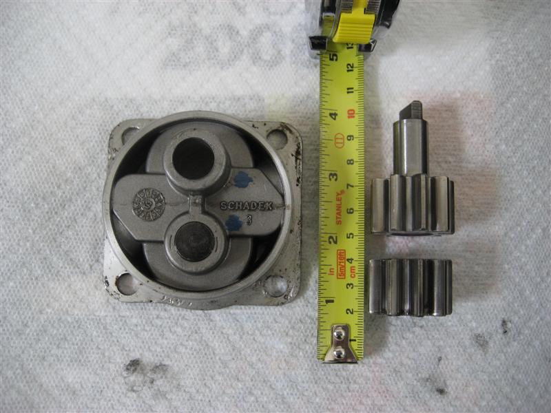

This is the pump that came out of the engine:
Seems to be a Schadek 21mm, with 8mm stud holes and 15mm oil passages.
It is a dual pressure relief case, and I run Castrol 20W50 oil. Because of the winters up here (it snowed last night, 5th of april - couple of inches of snow on the ground!) - the car doesn't get driven during the winter. I mostly drive it when the outside temp is between 50-100 F (10-50 C).

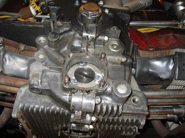

I did pull out the two pressure relief springs+pistons. The flywheel side spring has a little bit of a bend on it (not a sharp kink, just seems to be a little crooked top to bottom). The piston surfaces look fine. Is there a specific way to tell if those parts are below spec, or the springs weak?

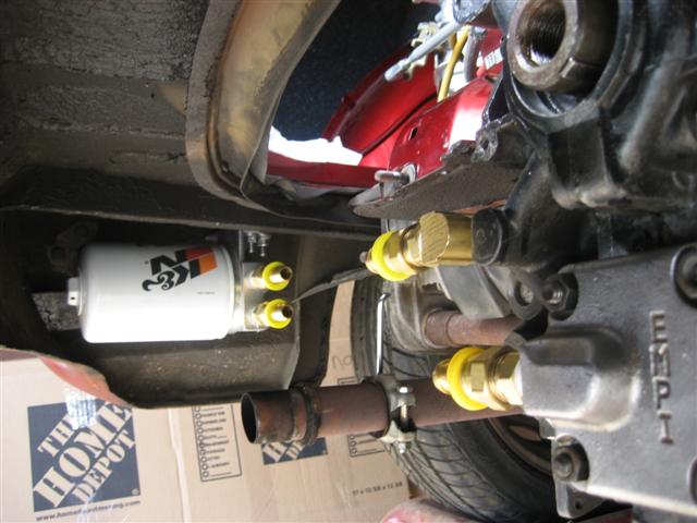

The full flow oil kit arrived from aircooled.net, and I installed it over the weekend.
It came with:
- 26 schadek oil pump, plugged for full flow.
- empi oil pump cover
- oil-filter mount
- hoses, and fire-braid insulation.
I blue-printed the pump as per the instructions provided by aircooled.net. Rubbing the pump and pump cover face on 150grit sand paper, on glass surface (to ensure flatness).
Oil pump was installed, and secured.

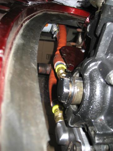

I fabricated a bracked out of some thick steel, so the filter mounts up and away under the rear left hand side of the ghia, using the mounts for the bumper bracket.
I chose the option where the kit comes with couplings, so the houses etc can be disassembled easily.
The hoses were cut to size, with the firebraid installed (orange). Hose clamps on the ends.
I left enough length of the hose so it has some room to move, and also bend in between the exhaust headers, with as much clearance away from the pipes as possible.

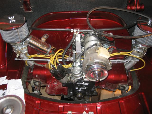

Full setup looks like this:
(I did decide to add an extra brace to the filter bracket, which is bent down and rests on the little lip on the under carriage. The result was a solid mount where if I tried to shake the oil-filter loose - the whole car would shake)
Now to putting some oil in, cranking it until oil pressure builds up (i saw a suggestion to remove the oil pressure sender, and wait until oil starts coming out of there), before firing up the engine.
