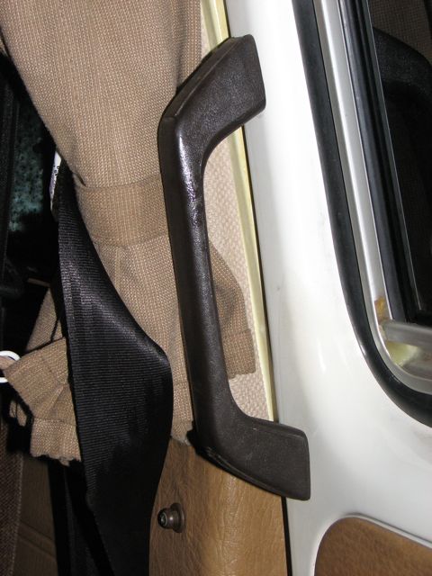

Posted: Thu Feb 04, 2010 9:37 pm Post subject: |
Not mounted on the curve, but gives you a good idea of how it might turn out. I opted against using the curved wedges since the curve on the back of the b-pillar (where the curved bases originally mounted) is larger than the curve alongside the slider window. Just didn't seem like it was going to match up the way I wanted it to. Also found the flat mounting pieces to be too wide for the upper mounting point beside the window, so I went without. On the flat works out great, and I find using the grab handle makes opening and closing the slider a simpler task. YMMV.

Posted: Thu Feb 04, 2010 9:55 pm Post subject: |
Thanks for the pic. I have been meaning to stick a handle there for the kids and it looks exactly like I pictured it in my head. Gotta do it now. |

Here are a couple pictures of mine. Sorry for the iphone quality pics.
I did mount mine on the curve with the wedge base pieces...I think just a little higher than the one in 1621's photo. Mine came from the vertical section just forward of the slider (from an '87 passenger van), so the bases had the right shape to fit on the door. Not sure if bases from the front pillars would have the right curve or not.
Great upgrade, we use it every time we're in the van! _________________ '86 Wolfy Westy Weekender

1621 wrote: |
Not mounted on the curve, but gives you a good idea of how it might turn out. I opted against using the curved wedges since the curve on the back of the b-pillar (where the curved bases originally mounted) is larger than the curve alongside the slider window. Just didn't seem like it was going to match up the way I wanted it to. Also found the flat mounting pieces to be too wide for the upper mounting point beside the window, so I went without. On the flat works out great, and I find using the grab handle makes opening and closing the slider a simpler task. YMMV. |
What do you have the handle screwed into to keep it from coming off the door? Did you you a nylon screw grommet or spreader nut? _________________ '15 Audi A3 Quattro

1621 Samba Member
Joined: May 15, 2006 Posts: 2174
Posted: Fri Feb 05, 2010 9:00 am Post subject: |
Timwhy wrote: |
1621 wrote: |
What do you have the handle screwed into to keep it from coming off the door? Did you you a nylon screw grommet or spreader nut? |
No spreader nuts or grommets necessary. Drilled a pilot hole and used the stock screws to hold it in place. Plenty strong enough, even with yanking the door open and closed all the time. _________________ '85 Westy |
