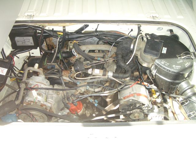

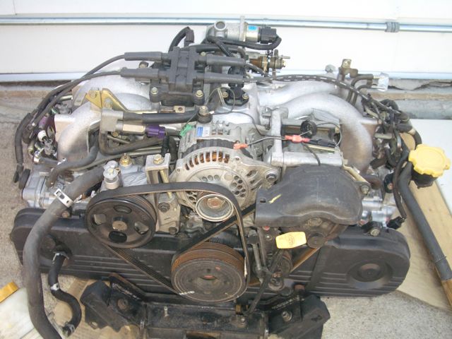

OK, here is the start of another Subaru swap thread. I hope it proves useful for someone. I’ve already received some great advice from Seth Hatfield, Tom Shiels, and numerous posters on the subaruvanagon list . It would be hard to top Chester’s excellent thread (http://www.thesamba.com/vw/forum/viewtopic.php?t=237938) or Mr. Weide’s great website (http://www.weidefamily.net/vanagon/) , so I’ll offer the reality TV version, blood, guts, disappointment and all. With any luck we can throw in some brief nudity for a PG-13 rating as well. I’ll get back to you on that.
My goal is to do a complete (relatively speaking) swap of a 2001 EJ25 into a 1990 Syncro in 31 days. I’ll be doing this in true partsmonkey fashion – l’ll have the engine prepped and have all the parts (I think), including harness on hand before I start the swap. I plan to begin on May 1st. Of the range of possible swap methods from true homebrew of everything to the Vanaru.com turn-key conversion, this is closer to the Vanaru turn-key, but not quite.
After having purchased what I believe to be all of the major parts, I think the Vanaru method will turn out to be a bargain, but I’ll do a post on my parts costs on another day. I’m sure that other than the great deal I got from Seth on the engine and a few conversion goodies, my parts cost will be on the high side. Maybe not.
Will I be able to accomplish this task? The smart money (my wife) says no. Two months at least she says. I think I can. Before you make your bets, I should also disclose that I don’t have a garage. I’ll be doing the swap in the location of my future garage. Not even a carport. Heck not even pavement. Otherwise, I have a full set of tools. I do have a solid spot for jackstands and have devised a way to roll jacks and an engine hoist around. I also have a few good friends who can be counted on to pop open a beer and laugh at me while I toil.
Why am I doing this? I love my van. I am a cheapskate. I love my family and friends. I love to ride my bike. I’m more interested in my family and bike than saving money, and any money and time spent on the van is not available to spend on bikes. As a recovering economist, I know that Adam Smith tells us that specialization, comparative advantage, etc, say that we should specialize – I should do what I’m good at and let someone else stuff the engine into the van. But, like much of economics, theory and reality are two different beasts. I enjoy stuff like this. That enjoyment doesn’t enter into the calculus of efficiency. Somewhere in all that there is a balance to be had between money and quality of life. I think.
To summarize...
The goal is to replace this
with this....
and these shiny bits
in 31 days.
I'll start tomorrow, Thursday May 1, 2008.
