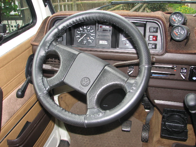

I've had a few questions now on swapping to a different VW steering wheel, so I'll post how I did it here. While I'm not certain about all VW steering wheels, this did work with one from a '91 GTI. I think some earlier models might be a direct swap, but I'm not certain which ones. Just know that the Vanagons have the smaller diameter hub, while the later models use a larger diameter hub.
Swapping to a different VW steering wheel requires three simple changes. It requires a spacer on the steering column, a thin spacer under the steering wheel, and the larger hub adapter.

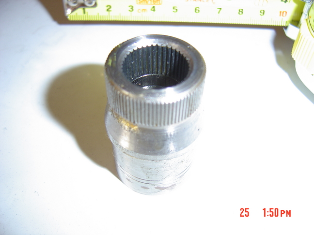

The good news is that all VWs have the small spline like our Vanagons, the later models simply use a pressed on adapter that is easily available at the dealerships for ~ $30. A quick modification of the aluminum adapter (cut off the bottom with a hacksaw) and it's ready to go on.
This picture is from VW vortex and shows the hub adapter.
Here it is again. I cut it off at the neck where it flares out about midway up.
You can read a great thread about removing one of these here: http://forums.vwvortex.com/zerothread?id=2059093
The spacer on the steering column between the metal collar welded on the column and the "ring" that rests on top of it (Bentley 48.2). I used 2 spacers approximately 2mm thick each.
The only other washer rests between the steering wheel and the steering column switch plate. Since this wheel is slightly shallower on the rear than the stock wheel, this thin spacer prevents the wheel from pressing down on the horn contact ring. It's fun to honk at people while driving around the neighborhood, but on every turn is a little much. Embarassed I made this ring spacer from a piece of hard plastic, umm about as thick as one of my DeWalt tool cases - or about 2mm.
It's really simple, no other modifications other than what I just stated. If you're familiar with the steering column design, this change can be completed in a couple hours. Also, since it's a VW steering wheel, the horn and turn signal work exactly the same. The wheel is smaller in diameter (~15 inches I think), but it's not hard to turn the wheel (I have power steering). The thicker grip is nice, the wheelskin makes it nicer still. And the best part is, I'm not paying the GoWesty price for a SA steering wheel ($430! Shocked )
Because I know the question will come up, it does block the clear view of the gauges. However, the old wheel did this for me too, and realistically I rarely look at my gauges as I can hear when to shift and know if I'm speeding or not. Besides, if I lean forward a bit I can actually see them easier than with the old wheel.

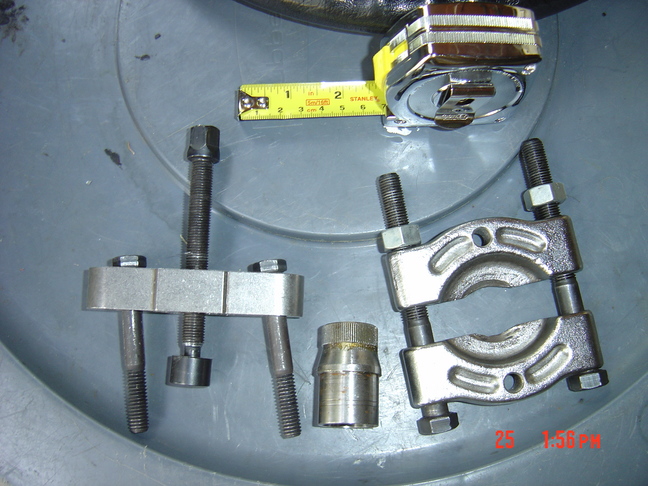

My "new" wheel came with a spacer that was unbelievably tight to fit !!...its now wrecked trying to get it off ( bearing puller would not get it off !)...im gonna have to get another one and cut it down as you described, is it a VW part ?, any idea on the part # ???
Ive already wrecked one steering column and a spacer trying to fit this wheel !!!!!, so any help would be great...thxs

I don't have a part number for you, but you should be able to find it at the VW dealership's parts department. As for the spacers, they'll rest on top of the steel collar welded on about midway up the steering column, and below the plastic collar that normally sits atop the steel collar.
The second spacer is something perhaps unique to my situation, though it may be yours as well. I cut another thin (2mm) plastic spacer to rest between the turn signal housing and the steering wheel itself. My issue was the column would slide down just enough (1-2mm) to cause the horn to blast anytime I turned the steering wheel. Perhaps this could have been by other means, but this solution proved simple and effective. It's not worn down after 3+ years, and I haven't had any issues whatsoever.
The following is one of the illustrations lifted from BenT's Vanagon Cafe site (http://vanagoncafe.com/) with credit to a gentleman named Yoshi. While the illustration is a bit confusing, in practice it's not too bad.
One last thing that will help you considerably is to wedge a block of wood between the floor and the bottom of the steering column to prevent it from sliding down while you're working. It should also help you adjust your spacers to the correct size and perhaps negate the need for the additional spacer separating the turn signal housing and steering wheel.
