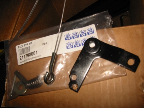

What is the correct way to connect these two pieces?
Should I open the eye?
I looked at Hazetguy's photos, and he used a nut/bolt combo, but his accelerator cable did not look like mine, his had a flat end at the front.
His photos
http://www.thesamba.com/vw/forum/album_search.php?search_keywords=Bus+Accelerator+Pedal+Pivot
(Those holes are pretty close to the edge eh?)

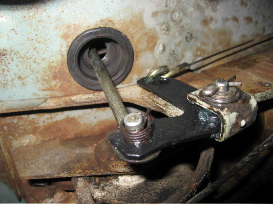

One solution:

My '61 has a cross pin there instead of the hook going through the L-bracket.

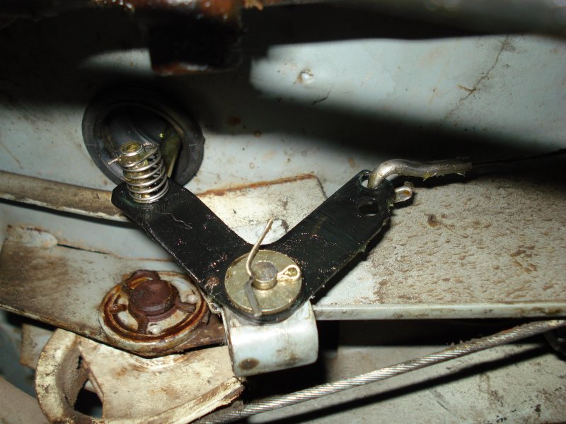

That link never works for me...I wonder why? Hmmm....here's another way from a '67. I guess you older bus guys don't put it inside or they only stay on the outside of the little flap. I always add a washer to the pedal link 'cuz that little crush always wears away anyway.

My bus used to be setup like this until the bracket broke off!
Now it's all better of course! I set it up like my 67.
My 67 was setup like the one EverettB posted.

You shouldn't have to open the eye unless it's been smashed shut. It's a tight fit and you must put it on the ell bracket before installing the bracket. The outermost hole is lower "geared" than the closer hole for foot-to-gofastness.

BarryL, doesn't your mounting method limit "pedal to the floor" travel? (Pedal to the metal) so to speak.

Every Bus I have ever seen had the L-bracket on the outside of the U-shaped bracket on the frame. '67 could be different though, I never looked at a '67.

d_ville wrote:
Thanks for the responses.
You got me worried so I went and looked and tried the gas pedal to see if it hits. Panic: no travel! Then I remembered the engine is removed temporarily so the pedal is already sitting on the metal and hence the picture like that. I've already given myself the Waldo Award so no making fun of me.

I had mine setup like BarryL and then the J-shaped metal hanger that is welded on to the body broke! It was hooked up this way since before I owned it. It is still working but it is weaksauce.
I'm going to fix the hanger and put the L-shaped bracket on the outside like EverettB posted, my Truck and the others I've looked at recently have it on the outside.

Ok. Now I'm concerned. Is there a change in years when this got moved to the outside? The '67 Westy has that crookedness being mounted on the inside and I want to move it back before I put the pan back on. Was there a gas pedal link that was "s" shaped? Sheesh, before hitting "submit" I went and looked at my unrestored one-owner (before me) '67 Kombi and it has it on the outside. If nobody replies then I'm moving the Westy's to the outside. The Bentley shows it on the inside.
