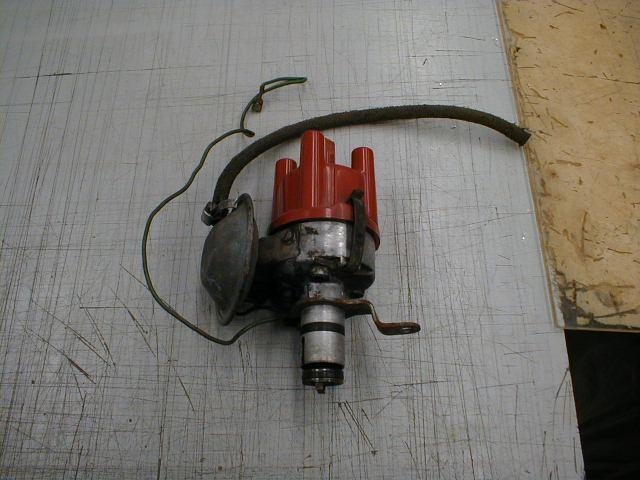

does you dizzy look like this, with that round piece on the side...

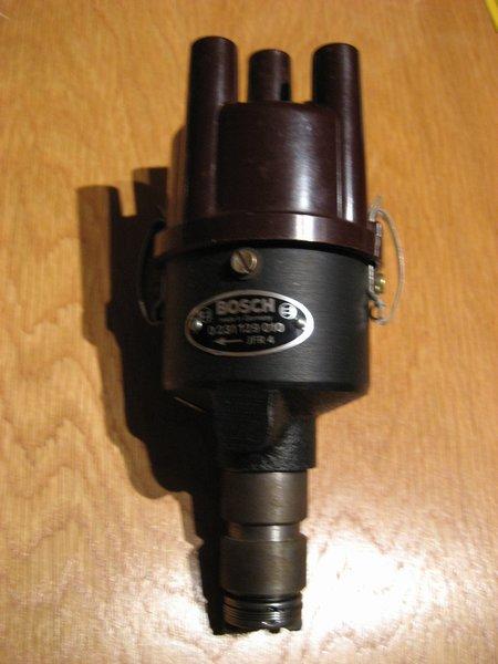

or like this with no round piece on the side...

It looks like the Bosch; however, it is not the original Bosch. I think the round thing on the is a condenser? Either way, my distributor does not have that on the side.

No problem! Laughing Just plug that threaded nut or replace it with a screw, you should be ok. You have a centrifugal advance distributor btw.
