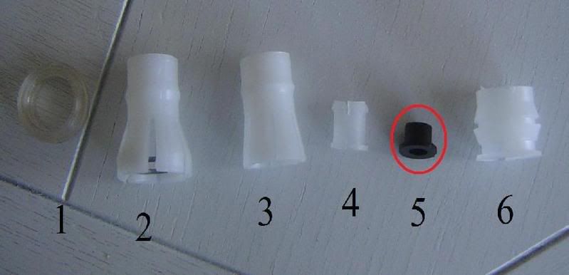

Here is the CORRECT front bushing for the late bay:
http://www.busdepot.com/details.jsp?partnumber=211711182
Part number 211 711 182
A lot of places want to sell you this one, #6 here, as the front one but it is wrong wrong wrong. Part number 111 701 259 A does not fit:
(pay no attention to the red circle!!)
