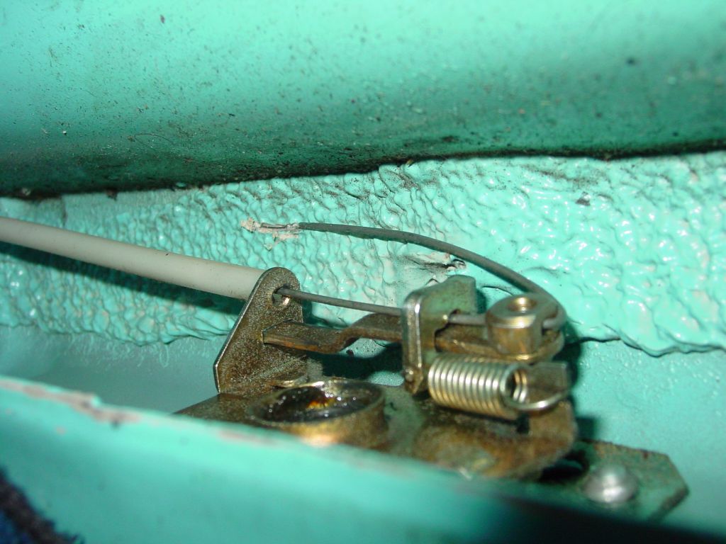

You either remove the (tiny) spring pin from the glove box end or disconnect the cable from the latch in the trunk. I found it easier to disconnect it from the latch.
Sorry this is fuzzy, but this shows the hold down clamp in the trunk. Without it the release will not function very well, if at all. The cable sleeve has to be fairly stiff too.

This pic is from my 74 super. Remove the screw that holds the cable in place (accessible from the top, there's a through-hole next to the mechanism), unbend the cable, and pull it through.

PostPosted: Tue Jun 10, 2008 4:38 pm    Post subject: Reply with quote
The screw is under the hole at the bottom right, you can see it here. It's a Phillips head. You may have to manually move the slider to see the screw through the hole. If the screw head is on the underside you'll have to undo it from there, though I'm not sure why someone would install it like that.
Here's another shot of the underside, might be easier to understand. After removing the screw, unbend the cable and it will slide right out.
See the slider "tab" that's sitting about 1/3 of the way across the hole? That needs to move very freely, that's what catches the hood catch and locks it. It's the same tab that needs to retract when you pull the lever in the glove box. Give it lots of grease and play with it while the cable is disconnected. Make it move nice and easy and be sure the return spring is on correctly too.
This is a shot of the glove box end of a brand new cable. I didn't need to install it in my bug as I managed to repair the existing mechanism. You can see the roll pin sticking up from the end, it's quite small. If you were to replace the cable entirely, you'd press out the old pin using a small punch or nail or something like that, then the cable would separate from the release lever. Then you'd line up the new cable over the lever and press the pin through so both ends are flush using a pair of pliers or vice grips.
The problem with this approach is that you'd have to install it after installing or at least dry fitting the lever in the glove box, and you'd have no slack in the cable and little working room up in the trunk. To make slack you'd want to undo the cable from the trunk release...and if you go and do that you might as well not worry about the lever end. Chances are your lever and cable are fine, they just need adjustment and lubrication.
So unless there's a real reason to completely replace the cable, don't bother with the roll pin end. Just pull the other end off and feed the entire thing through the glove box. Put in a new glove box, feed it back through the hole, and bolt the lever on to the new box (or use rivets, whichever you have). Whatever hardware you use, check that it leaves enough clearance for the lever to move without interference. Spray lithium grease inside the white cable sleeve before installation so it moves freely.
Once it's all installed you will feed the cable back through the mechanism the way it came out. It has to be tight after putting that screw back in! Then you bend the cable back the way it was so even if the screw loosens a little it should still function. After you've tested the lever and tab action, but before you actually slam the trunk and lock yourself out Exclamation remove the hood catch from the trunk lid. It's held in with two bolts. Test fit it into the latch and then have someone pull the release lever. Make sure it releases!! You can adjust the length of the hood catch pin by loosening the lock nut, turning the end of the pin in or out, then tightening the lock nut.
This isn't a particularly hard job, but it does require patience and some tweaking. But you can do it. Just don't slam that hood solid until you're sure it'll work!
