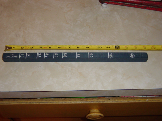

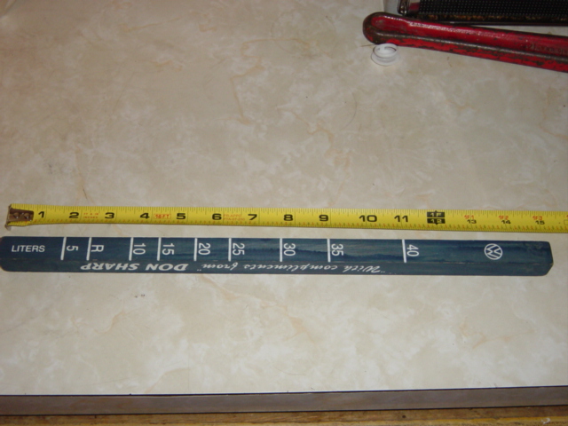

Perhaps these will be helpful:
The gallons measurments are at odd increments as the stick uses the liter system in increments of 5 liters and the lines line up for both sides of the stick.
Overall length is 14 15/16 inches.
5l/1.3 g= 1 3/4 in.
R = 2 7/16 in.
10l/2.6g= 3 9/16 in.
15l/3.9g= 4 5/16in.
20l/5.2g= 5 1/4 in.
25l/6.9g= 6 1/8 in.
30l/7.9g= 8 1/2 in.
35l/9.2g= 8 13/16in.
40l/ 10.5g= 10 13/16 in.

drscope
Joined: February 19, 2007
Posts: 15273
drscope is offline
PostPosted: Mon Jul 14, 2008 5:51 am    Post subject: Reply with quote
Perfect! Thanks tasb!
