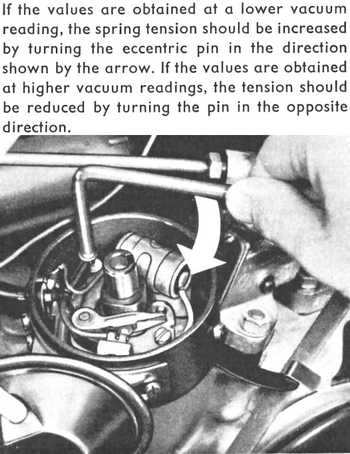

How do you adjust it? You turn the peg the spring attaches to. VW/Bosch had a special tool that fit on it to help turn it.
So you're sure it's 07024 canister then? It will move 5.5mm total?

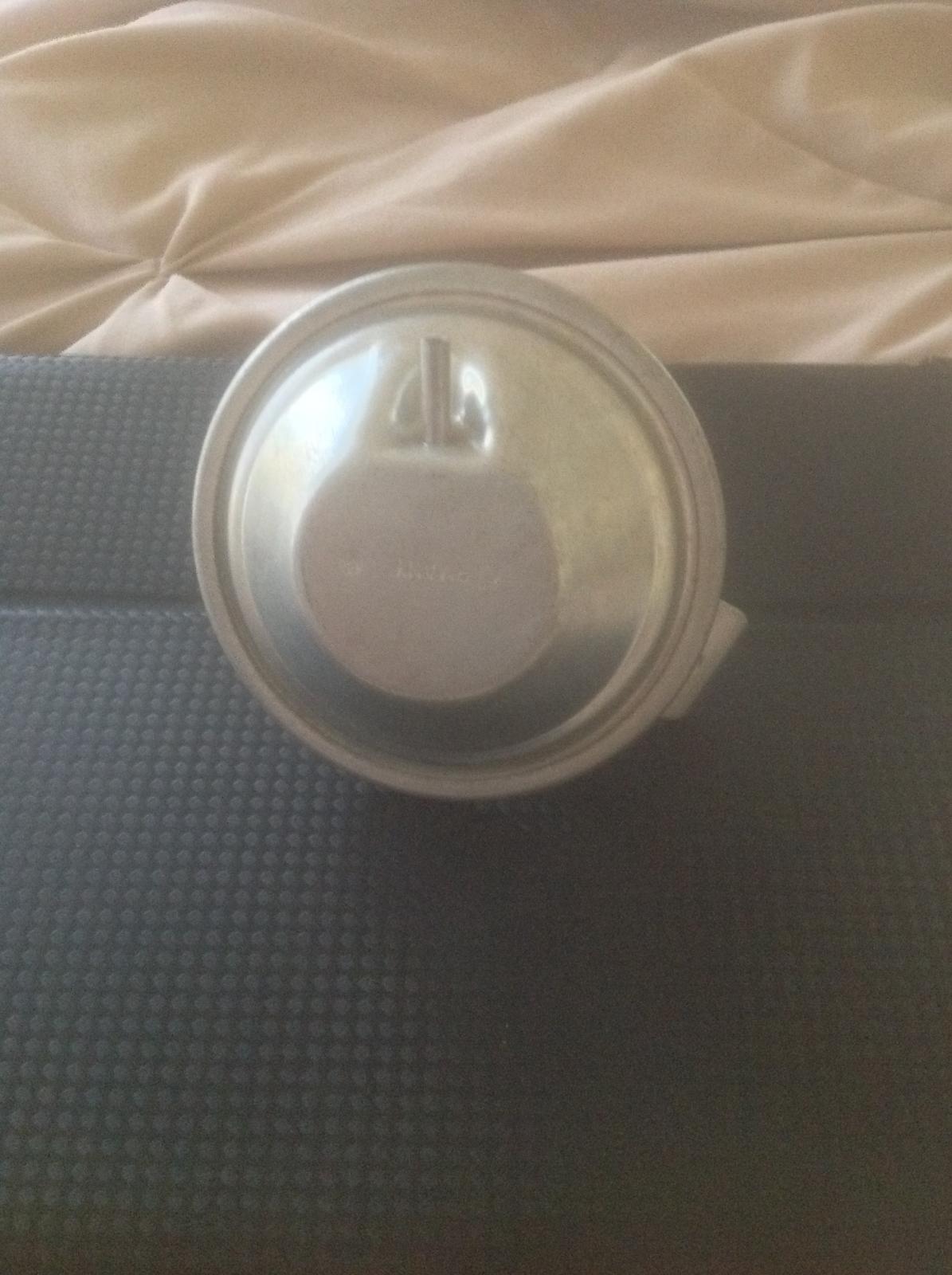

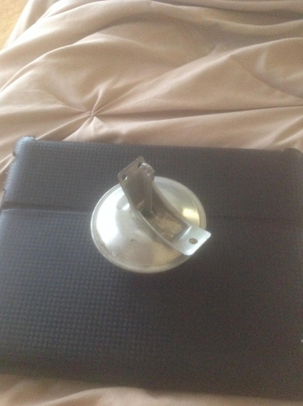

Can someone identify what this can is for? The arm moves 4.75mm and the Germany is up side down from the nipple.

Based upon the shape of the canister and the two mounting holes on one side and only one on the other I would guess 40 hp big cap canister. They were used from 1960 until 1964. They are the most common NOS vacuum canister. I would hesitate to say plentiful though.

Thank you sir. I figured it was the 07015 can but wanted to double verify it. I have three of these, 2 nos and 1 good used one I bought sometime in the past. Of course, I don't have any use for them but do need the cans for the 67 and 69 stock distributors..
Funny you say "so plentiful".. There's several of these in the classifieds and none for the years I need.

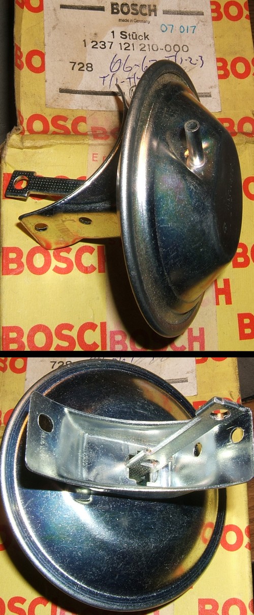

Vac-only canisters don't fail that often. However the DVDA units fail on the retard side all the time!!!
He'll need the 07017 for the 66-67 but the 07024 for the 69 unit. Which I'm sure he knows, as he's obviously read this thread through.
re: star pattern was on the 66-67 07017 cans, replacement ones, like I posted a photo of a few pages ago, don't have it.
https://www.thesamba.com/vw/gallery/pix/576676.jpg
Now, has anyone ever ordered what RockAuto sells for that one?
http://www.rockauto.com/catalog/x,carcode,1351808,parttype,7232
I don't seem to see them carrying one for the 07024 though.
-Andy
