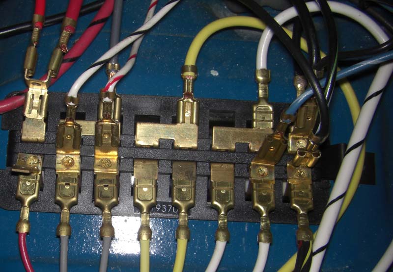

We have been completing rewiring a 1965 bug and all seams to be functioning but we are randomly blowing fuses. I don't think we have the right fuse setup. The only thing that has been added was a Sony CD player/radio. What is the recommended AMP fuses for the following fuse panel:
[img]http://farm4.static.flickr.com/3107/2706915920_920119bf72.jpg?v=0[/img]

16 amp for wipers, brake light, flasher relay, and horn all others 8 amp.

You should already have two "output" prongs on that fuse. If you don't, go to your local autoparts store and look in the electrical section. You'll find some special connectors that turn one prong into two prongs. See the top of the left fuse in this pic
