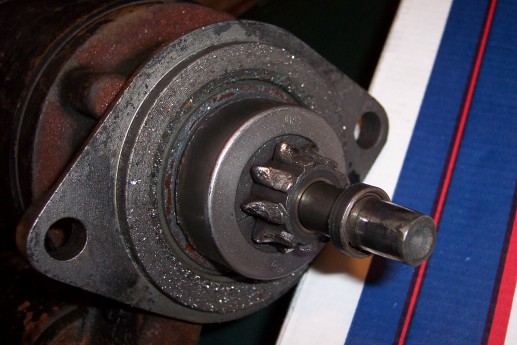

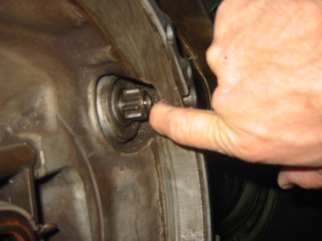

bugninva wrote:
yeah, the autostick starter is "self-supporting" meaning it's housing extends to the other end of the starter shaft... there is no need for the bushing....
Here is what one looks like...
And here is the stock style that needs the bushing... don't mind the chewed up gear LOL Shocked
DrDarby wrote:
You don't need to touch the bushing the auto stick starter has nothing to do with it.
Yessirie.... the autostick starter never comes in contact with where the bushing is...
