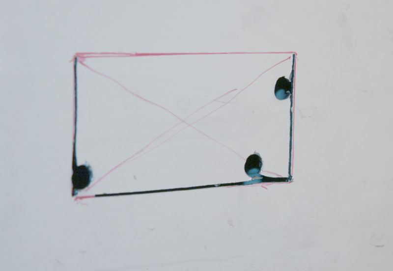

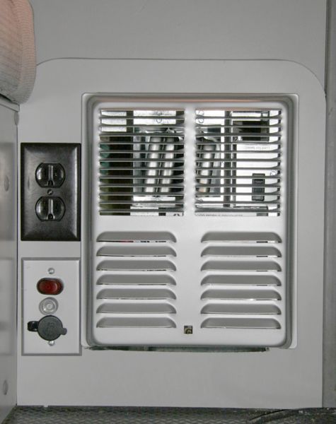

Here's some more pics of the install. Nice work...not mine...photos sent to me by the installer, (Troy) I can't answer any specific questions but the pictures are pretty self explanatory.
The Atwood furnace is a bit longer than the depth of the Westy cabinet so a piece of formica was used as a "frame" to increase the depth....looks pretty good I think.
Here's what Troy sent me with the pics.
I went down to Ace Hardware and picked up a piece of Formica that's fairly close match to the stock. I bought the edging from a place called T-molding on line. .
Here's the hole where the small storage cabinet used to be...to the left of the fridge.....the outlet and breaker are restored to their original positions. (I've never used shore power in my van, so not sure I'd bother putting these back in....rather have the space.)
Note the rectangular hole through the side of the van sheet metal for the vent.
The furnace must vent straight through the side of the van...as the photos show...no options for curving pipes through the floor.
Here's the finished vent viewed from the outside of the van. Next time you see an Adventurewagon check it out.
A bit of sheet metal had to be trimmed from the back of the heater box to make it conform to the shape of the side of the van...as per the markings.
Troy......The blue lines are the actual shape of the side of the Westy wall. I scribed a piece of cardboard and then transferred it to the furnace. Problem is the squirrel cage fan. If one was to actually cut out the exact shape, you would cut into the squirrel cage fan. The most critical part I found was a horizontal reinforcement of the Westy wall, and I had to file out a portion of the furnace to mate. If you look closely at the picture you will see its hollowed out a little bit more in the center. One really only needs to cut about a half-inch off the bottom of the furnace. It's fairly light weight sheet-metal so, maybe five minutes worth of work. You can get to within 1/4" of the stock cabinet wall face.
Looking down from the top into the (former) storage space. Looks like an inverter was installed on the wall beside the heater.
Troy..... In my case, I have a switch, that in turn runs through an inverter
that is connected to power the lower half of the electrical outlet. I also
have a 12 V cigarette lighter installed in that lower outlet box. I did not
want to give up shore power completely either, even though I rarely find
campsites with 110 available.
The finished install without the vent cover.
The vent cover comes in a brown color...which would look OK in a earlier model tan interior...but would be ugly in a grey interior.....so.....
...not sure if this vent was stripped to bare metal ....or repainted silver....but it goes much better with the late model grey Westy interior
The thermostat control.
These photos satisfied me that this is a viable furnace option for Vanagons....at least from an installation point of view. A bit bigger than the popular Propex 2000 but not that much bigger than Propex 2800.
