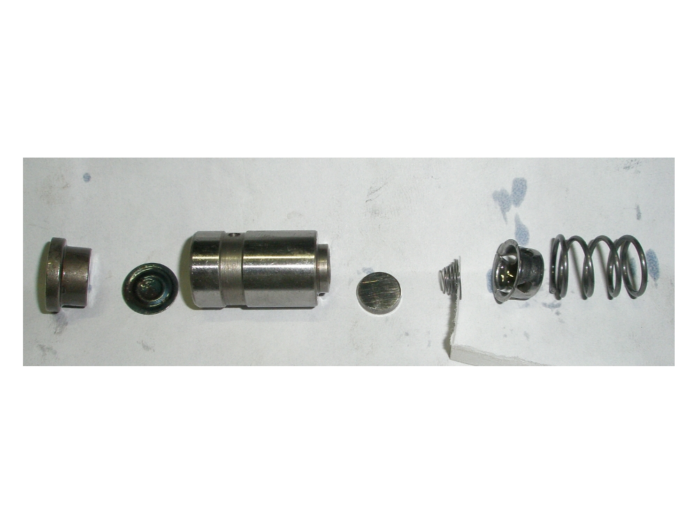

PostPosted: Mon Jul 06, 2009 11:05 pm    Post subject: Anatomy of the Febi Lifter, part two Reply with quote
Curiosity, and suggestion, got the better of me and I'm glad it did.
My assumption on spring orientation was wrong.
I took a few of the lifters apart. The valve housing pulls off quite easily with a pick.
First shot is an exploded view, like loogy's, but one step further. I took out the contents of the valve housing.
You can see the spring and the disc. Notice the spring orientation.
Here's a close up of the disc and the spring. I took four apart to ensure the spring orientation was consistent. Some notes.
The large spring does *seem* to have a tighter side that snuggles up to the disc/spring housing. The housing flares out where it fits on the plunger, and the spring diameter is tight so it holds it in place. It's just a pressure fitting. Whether the tightness is intentional or not I cannot say, it just seemed that one side was snugger. The spring, however, looks symmetrical to the eye.
The small plate (second from the right of the exploded view), seems to just be thrown in there randomly. The way the channels are, I doubt it matters, though I'm putting them back together with the inner most ring raised side facing up.

PostPosted: Mon Jul 06, 2009 11:17 pm    Post subject: Reply with quote
Got a picture of the outer body of the llfter?
The plate is a metering disc to restrict oil flow up the pushrod. Doesn't matter which way it goes in.
