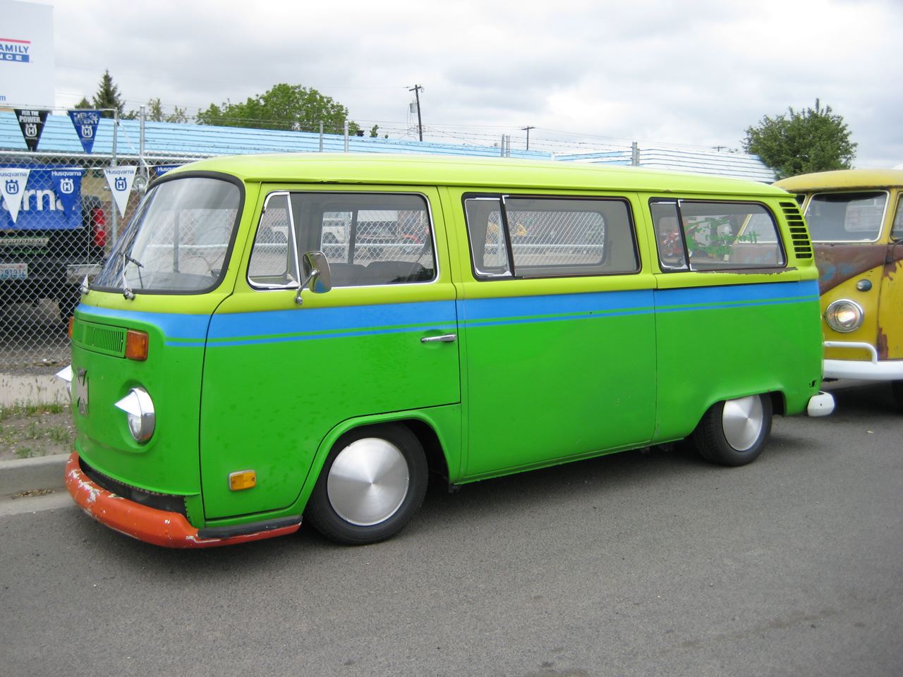

Instead of doing numerous posts or adding to congested posts I'll slap my pics and progress on my 73 here. It's a green apple/lime green color combo that's pretty rare as far as I know. If you or any one else you know has a simular painted bus please post it!! I think that these busses are rediculously ugly to the point that they just need to be saved to prove that, yes they were built (kinda like the golf harlequins? wtf were they thinking?) Progress is going to be slow due to 2 kids, a wife, a mortgage- yada yada....broke as hell....etc. I do hope to have it pretty this year and cross country ready by 2010. Right now I have the engine pulled to put a new set of mounts in and repair 30+ years worth of cooling tin butchery. I got the 1700 running pretty well before pulling so I'm not going to dig into that just yet when there's bigger problems ahead. The doors, glass and seals are all out in prep for sheet metal repair, starting with doglegs.

Nice. Love that color combo Laughing

Very cool. I too like the paint color. Keep us posted.

I think they are some of the best looking vehicles on the road. They look practical and usable. Not like about everything else. Nothing these days looks bigger on the inside than on the outside.

I like that color combo as much as I like the Champagne Edition combo colors and I like Champagne Editions Smile They just scream 70's. Laughing

I love the colours!
Wasn't it called like shamrock shake special edition though? Or something similar?

I cant get enough of that Green. I think i might paint my bus that color this summer...
Good luck on the build!

Anyone have the paint L codes for that '73?

So is that really a factory color option?
That was a 1 year only option.
I'd say the top is Bali Yellow/L62H
The bottom looks like a custom color of a lighter sage green maybe? Don't know just my $.02
