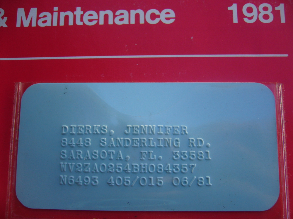

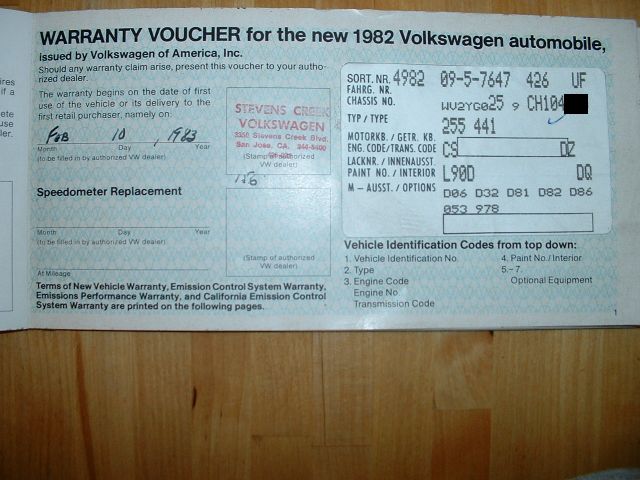

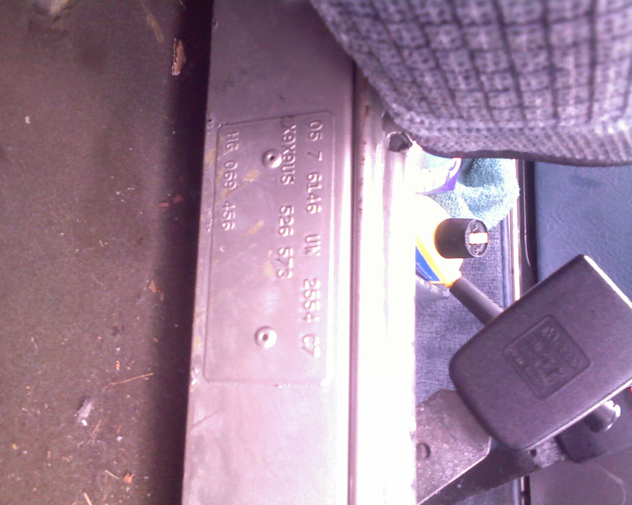

I've been searching the forums and can not find where you can locate on the van a code plate like the vin plate on the inside of the drivers door to list what the van came with from the factory. My van has power mirrors but lack the Power part of the mirror. Probably those blasted wires at the door jam. I have been wondering what else my van came equiped with from the factory that also is not working and or from the PO is now missing. Anybody have any ideas?

taken from Brickyard...
http://www.brickwerks.co.uk/index.php/t3-m-codes/ (this link is no longer valid; use other sources listed below)
Moderator edit:
Other sources:
http://vwt3.com/t3-tech/t3-data/vw-t3-m-codes-options-list/
http://vw-mplate.com/mcode.php?lang=EN&id=6157 (build sheet decoder)
http://www.t3-infos.de/t3-infos_j.html (in German)
Factory options (M Numbers)
These are the numbers that can be found on your extras plate normally under the passenger seat,on the sticker by the drivers pedals or on the sticker in the front page of the service book. They are known as "M-numbers" and are factory fitted options. Aditionally you'll see some "S" coded ones, these are for Special editions generally.

I've a feeling the US spec Vanagons don't have them.
This is the plate that came on the 81 Vanagons service manual:

PostPosted: Wed Feb 11, 2009 9:29 am    Post subject: Reply with quote
Oh, they have them. I am holding the original warranty book for one of my 1982 vans in my lap. Page numbered 1 has a sticker on the right half with everything, including the M codes. Paint code, engine code, tranny code, VIN, etc. The other half of the page also has the VW dealer info where it was purchased, in Calif.
The metal ID plates are riveted in place under the drivers side seat. The last 8 digits of the VIN are there as well as M codes for some features. My 82, 86, 87, and 90 all have the plate.
My 84 Westy with the swivel seats doesn't have the ID plate, just 2 empty rivet holes where the plate would be. The swivel plate would block the ID plate if it was there. The Westy has a sticker below the fuse box. The sticker faces down so that I have to be on the ground looking up to see it.

PostPosted: Wed Feb 11, 2009 11:50 am    Post subject: Reply with quote
The plate is under the drivers seat mounted to the side wall toward the passenger side . You have to push the seat all the way forward open the 2nd battery hatch and look again its there .
Sorry there sideways.

PostPosted: Wed Feb 11, 2009 12:01 pm    Post subject: Reply with quote
Ok, here are photos of the ID plates and stickers. The riveted metal plates would be hidden by the welded in swivel seat base plate and so may not be present on factory swivel seat models. My 84 Westy has no plate there under the seat, but does have a sticker under the fuse box as shown in photo. The 82 warranty book page 1 shows a sticker that was put there at time of sale from a document package that came with the vehicle. Looks like the sticker on the 84 Westy, so maybe the 84 sticker was placed by the dealer?

You can tell a lot from a plate
L90D = your bus was painted pastel white and laquered
C. chassis built in Germany between 1st Aug to '81 to July '82
H. from the Hanover factory
255. It started life as a caravelle (Bus)
CS 1,6l 4-cyl. Upright Diesel from '81 to '87 37kw / 50bhp Shocked
DZ gearbox
produced in July '82
ratios
1st gear = 3,78
2nd = 2,06
3rd = 1,23
reverse = 3,67
Final drive = 5,86
