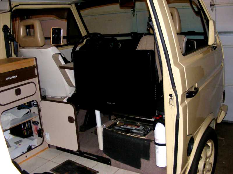

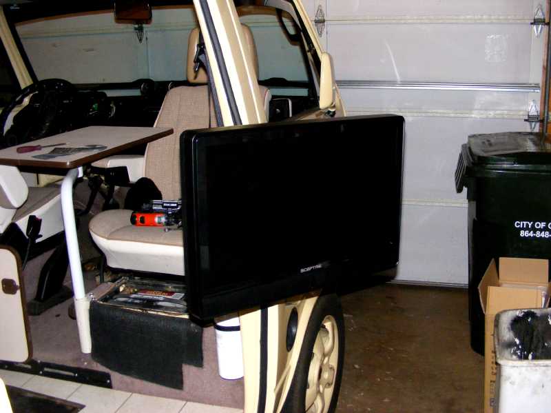

OK, so I got too much time on my hands...
Long story short, I found an excellent buy on a 23" HDTV / Monitor over at www.newegg.com. Kind of an off-brand name, but I took a chance and turned out to be a great deal for $200. Good picture, tons of connections from coaxial all the way to HDMI and a nice size.
Most of the time it’s going to reside in my bedroom on a shorty wall mount arm. Even found a nice little 'compact DVD player' with HDMI output that I'm make a custom mount to hang off the bottom of set.
Got to thinking about it and thought... "Might be nice to be able to watch a movie after dinner at the campground without huddling around my laptop"
Looked around and found a nice 15" articulating arm wall mount from Peerless that's fairly inexpensive if you do a little searching with google
www.peerlessmounts.com/dyn/Products/BrowseProduct.aspx/tn/39/u/t/categoryID/195
Decided to mount on the B-pillar behind the passenger seat. Had nice access thru the 'fuzzy vent' and even thought it looked like it had some stout metal behind it for the seatbelt mount, I decided to back it up with a piece of plate steel

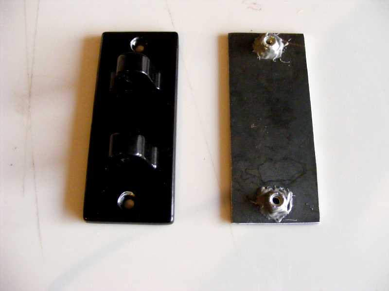

So here's the mounting plate and the backer plate with the nylon locking nuts JB welded in place (didn't want to have to maneuver a wrench inside the B-pillar)

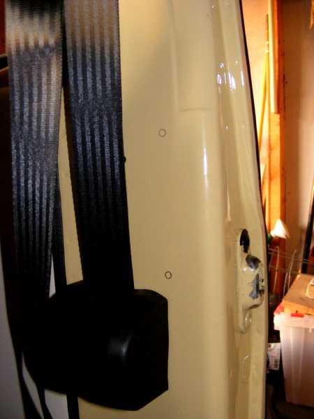

Here are the markings for the holes I had to drill in the B-pillar and a look inside from the fuzzy vent
Decided to put some JB weld on the backer plate to it would stay put if I ever had to remove the outer mounting plate

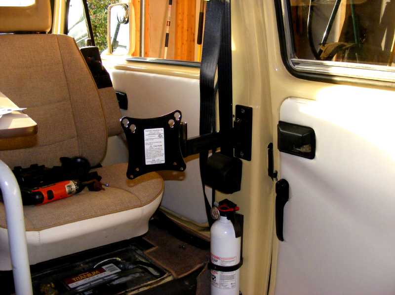

Here’s the plate mount and the arm mounted on it

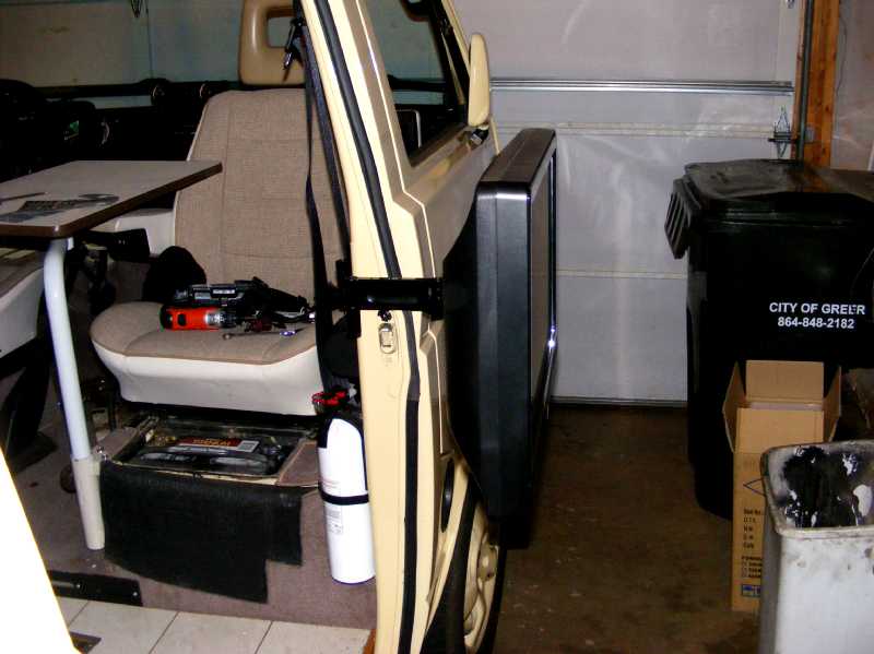

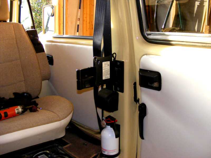

And this is with the TV mounted in place
I also found a nice little mast mounted HD antenna that I’m going to fab a pole mount for.
http://reviews.cnet.com/a-v-antennas/philips-mant940-hdtv-antenna/4505-6509_7-32023898.html
Something simple that will sit on the ground and use one of the jack points and something to grab the rain gutter

I usually don't like TV's installed in cars but I really like this setup I really like how it swings outside like that.

Great work as well as a great write up.
I really like the way you set up the passengers side table!!!
From what it looks, its just the same sort of bracket thats behind the drivers side seat well.
Is this correct.
I gots to keep an eye out for an extra bracket.
You didnt run into any issues when drilling the screw holes did you ??

That looks like a sweet setup! I like to watch movies in bed, so when I go out in my Westy, I always bring a portable dvd player. Also, I sometimes camp where campfires are prohibited, so when the sun goes down, what else is there to do?

PostPosted: Sat Mar 07, 2009 1:12 pm    Post subject: Reply with quote
tds3pete wrote:
Seems like you kinda cheaped out with the 23"
Why not go for a 52" with added rollers top and bottom and you could have replaced the sliding door with it................
Don't think it didn't cross my mind...
just didn't like the idea of all those wires hangin' on the outside
... and damn hard to spin around so you could use it inside or out
LOL
But seriously, this is "Use-B" for the set, not its primary home
(..."most of the time it’s going to reside in my bedroom"...)
Camping in the great outdoors isn't the only thing I do with my Westy... tailgate parties, car shows, etc ...
just seemed like an easy and nice mod
Not sure how well the deep cycle battery and inverter will like it
but that's why I'm always keep an eye out for the nearest outlet
and carry a 12 gauge / 100' extension cord

82 WESTY MAN: Hey that brand of TV you got, SCEPTER, is a decently good TV. A friend of mine has had a 32 inch version now for over 2 yrs now with absolutely no problems.
I had considered putting a 12volt TV in my Westy, but decided that my main excuse for camping is to get away from technology, so I opted out of having the bus full of techy doo dads.
But I must say, that is an Awesomely clean install. Nice how the TV Swings outside the door.
Can your Pass Seat be facing forward with the TV mounted there, or do you have to remove it?

That's a great spot for it, really cool you can flip it to point outside. Now all you need is a vanputer. Very Happy
BTW I'm typing this from my van in a campground, wifi antenna on the roof, about 500 yds from the ocean. Just waiting for my buddy to get up.
