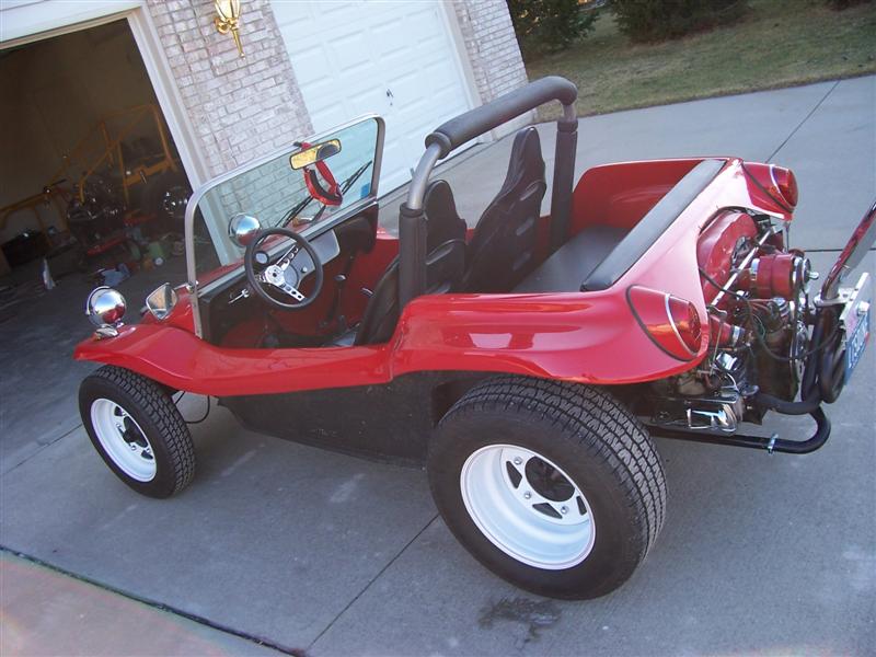

15x10 rears with 295/50/15 and 15x7 fronts with 225/60/15..eventually I wanna get 15x12s Twisted Evil

These are 15x10 with 275/60/15 and 15x7 with 235/60/15
