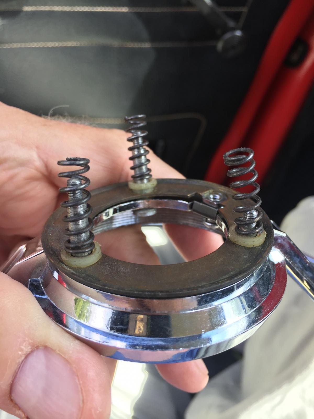

These images from a recent similar thread may help explain it.
This photo shows the metal inner "ring" inside the steering column with the horn ground wire coming through it:
That ground wire comes through and attaches to the outer horn ring shown here:
Then the horn ring attaches to that inner metal ring with those 3 screws, BUT those springs around the screws keep the horn ring separated from the inner metal ring, so the ground circuit stays broken until you push the horn ring (or horn button) inward. When you push the horn ring inward, it touches against the inner metal ring and completes the ground circuit firing the horn.
This is also why if you overtorque those horn ring screws down, the horn will constantly sound because the horn ring will constantly be touching the inner metal ring. You just want to tighten them down enough to where the horn ring is secure but still separated from the inner metal ring via those springs.

PostPosted: Wed Oct 04, 2017 12:04 pm    Post subject: Re: 69 Horn issue Reply with quote
Marleybus wrote:
That I understand. The issue is what contacts the steering wheel to the brass race behind it? I Understand the horn ring makes the momentary contact connection.
Horn ring is attached to the brass contact ring just in front of it by a screw that also holds the end of the ground brown wire that goes thru the steering shaft.
The brass ring on the front of the horn ring is what contacts the brass ring cast into the steering wheel.
