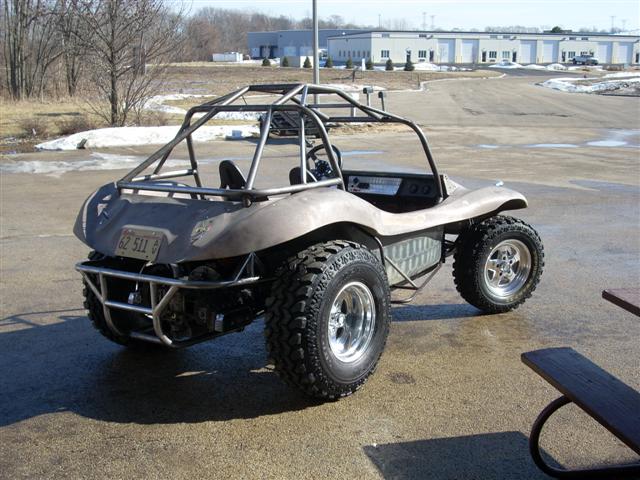

PostPosted: Tue Apr 07, 2009 5:07 pm    Post subject: Reply with quote
here's a pic of some swamper radials (SSRs) 28"x9.50

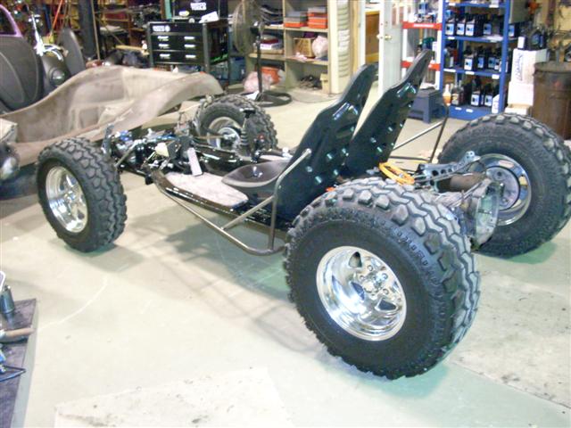

Here is a comparssion of tire sizes:
L to R
Stock 165 X 15
700 15 on 4.5 X 15 rims
31 10.50 on 7.0 X 15 rims

Here's the Interco SSR's, 28-9.5-15 front and 32-11.5-15 rear. 7 inch rim front and 10's on the rear.
