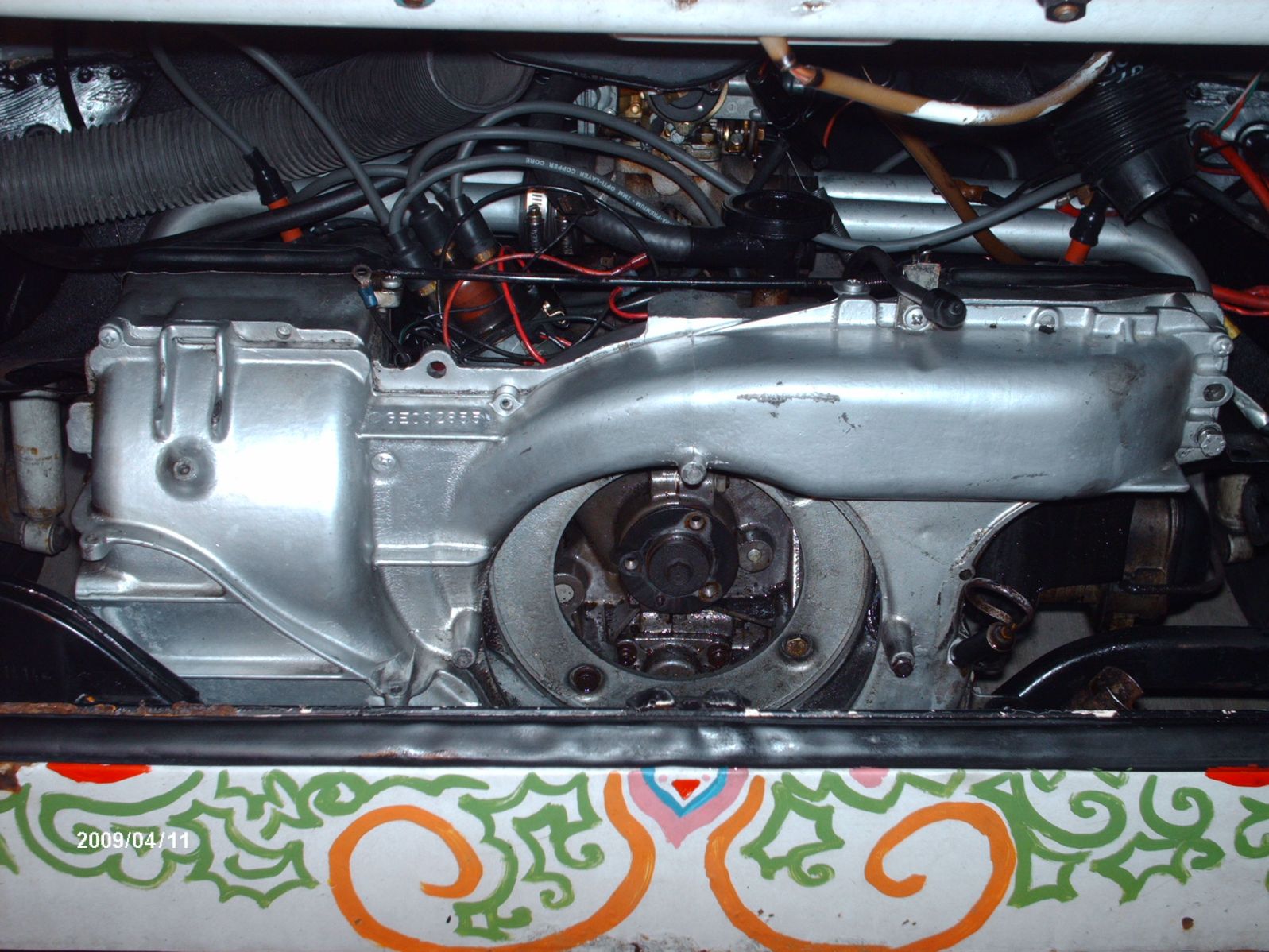

Hi all,
I have had a pretty terrible oil leak for some time now and I finally decided to do something about it. After searching TheSamba I concluded that my leak was either oil pressure sender unit or oil cooler seals. I replace the oil pressure sender and it didn’t fix the leak so that left the oil cooler seals. In the search process I read several posts saying you had to drop the engine to replace the seals and several saying you didn't have to drop the engine. I didn't drop the engine and here are a few pics documenting the process. These are the only pics I took, I didn’t feel like cleaning up and stopping to take a pic every time I made progress. This is my first "how-to-ish" post so hopefully it helps someone out.
Just for kicks...before pics:
Removed the bumper:
Removed exhaust:
Removed fan, alternator, and coil:
Removed fan shroud and oil cooler:
The culprits:
It was a pretty simple job. I even found a few things that needed some attention in the process. Best part of it all is that it doesn’t leak oil! Well...it doesn’t leak much oil at all! 60 cents for oil cooler seals and about 5 hours of my Saturday sure beat the heck out of paying my mechanic $350 to put them in. If anyone is considering this job, do it.
-Shane

Dang that is one clean engine bay. To be honest, I was expecting a mess until I got to the picture with it open. Nice bus!
Yeah, not too dirty- I guess you fixed it before too much mess. Just think about all those Busses we've all seen, completely covered in grease. That stuff doesn't just happen overnite , you know....... Smile
Good save !

Thanks guys. I learned the hard way about how a VW engine should be treated so I vowed to keep this one in great shape. Unfortunately for it but fortunately for me this was my first and only car, I have been daily driving it for about 4 years now and I have learned a lot.

Funky breather on top of the case. Is the motor from something else, not like a 78 bus that I know of?

Ah, I should have made note of that. Good eye. It's from a Vanagon, I think one of the pics had a picture with the two dipsticks in it. I took care of that too while I was in there.
