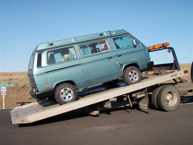

I was on a recent trip, 3 hours from home on a brand new, broken in tencent motor when the unthinkable happened. Saw my coolant light start flashing, and temp start to climb. Pulled over thinking a coolant hose came off when I saw something a little surprising, I was missing a head stud nut!
Shocked
I called tencent and told him about what happened. This was 5:30 on a friday night, by the way. We talked about what to do next, and while I was waiting for the tow truck, he did a little research and called me back while I was getting a tow to the home depot parking lot.
Gotta love the look on the dog's face! Laughing

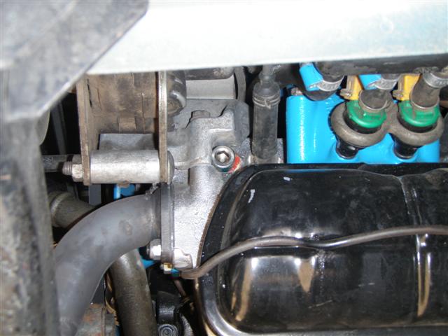

Tencent called me back and walked me through what I needed to do to patch the head so I could limp home. Turns out a 1/2" tap fits the hole in the head perfectly. This was discovered by tencent on a head he had at home, less than 20 min after my call. I picked up a tap set, socket to fit the tap, and some high temp gasket maker.

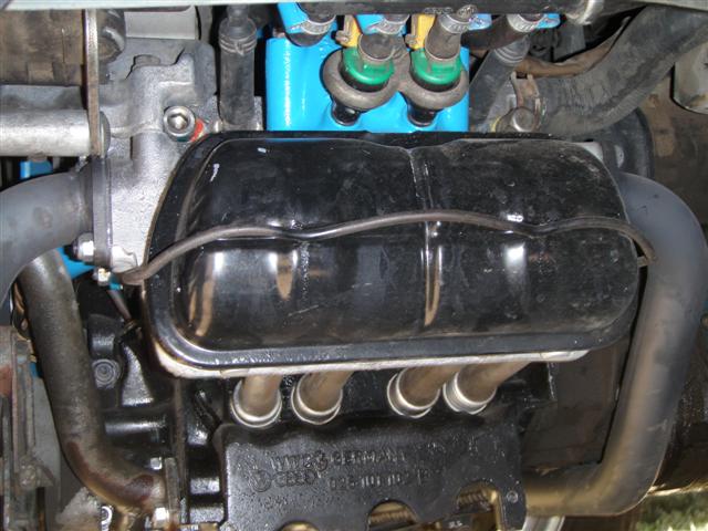

Here is what turned out. (upper left corner)
This worked to get me back home (after a couple days of camping in hood river)

What were the results of the post mortem? Did the stud break and fall out of the engine taking the nut with it?

stud snapped next to the case. Took nut with it.
Worked out for me because the stud was not in the way for threading the head for a bolt.
I think Chris might have kept the culprit as a souvenir...

Why was there a head stud missing?
Well, hell, it was there when I built the thing. Now where did that thing go?
The stud broke off down at the root in the case. It's just a risk you take when rebuilding this old stock. There aren't any credible tests established to assess the head studs (although you can be damn sure I'm trying to figure one out!); you inspect them for corrosion or damage, and run with them if they look OK and take your chances. The alternative is to replace them all at over $200 the set, and an easy full day's labor to R&R, if you're lucky. That would raise the price of an engine $500, for every one, whether it needed new studs or not. I don't think I would sell many engines if the price went up $500 but there wasn't $500 more performance, so this is just one of those calculated risks one takes in business. Lots of things are this way; you'd be surprised. The only downside is you have to be prepared to deal with the consequences should they arise.

To tenc, i sometime test the strength of the stud by putting a very strong metal bar with a hole in it across the water jacket, put the stud in the hole and over torque it to 42-3. On a old case that i didn't care about i was able to but 55 before the stud stripped.
By the way noza, i see normal hose clamp on those injector!!! And i see original hoses on the injector.... you don't want that beautiful engine to burned down!
