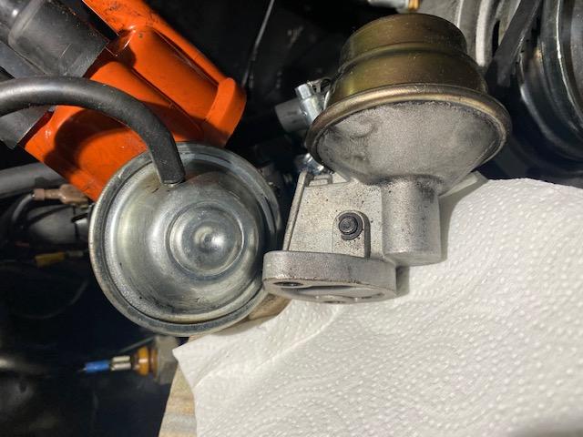

I have a 71 Westy with a 1776 upright type 1 engine, using a Gen style fuel pump with the correct 108mm rod. I have dual genuine Weber IDF 40 carbs, and everything has 5000 miles on it. The bus sat for a week and it emptied the gas tank into the crankcase. I performed an experiment by putting clear tubing on both carb fuel inlets and filled the tube and float bowls with gas. I also pulled the fuel pump and placed a clean paper towel under it to monitor for leaks. After an hour or so, it's clear that the driver's side carb is leaking down and the pump is dry. I'll pull both carbs and clean them out and inspect the needle valves. The question I have is in regards to the mechanical pump. Should it allow gas to gravity feed through it to the carb while sitting? Should I replace that fuel pump as well?

Fixing the needle/seat in the carb or replacing it should solve your problem. No check valves in the fuel pump.

I removed the tops of my brand new Webers to find the float bowl widely out of adjustment. The float would basically go all the way to the top without seating the needle valve. These carbs went through an optional setup process from the vendor, so I didn't bother to check before installing them. Lesson learned there.
Still thinking about a square top Pierburg pump that has the integrated valve since the Webers sit 2-3 inches lower than a center mounted Solex, and the float line is below the tank bottom.
