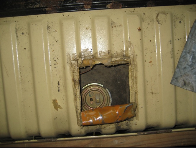

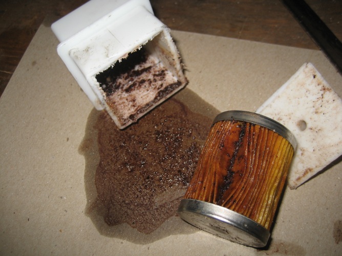

OK, I promised pics...
I picked up one of these handy little fuel hose clamps at Schucks. Very nice. I filled up a big bucket of gas, didn't spill a drop - well... just a couple drops. Snapped a lid on the bucket and set it aside. If you have a rusty bus, get one of these clamps!
Here's what I found inside the filter! This is WAY worse than the one I removed in front of the shop. So far, my theory seems accurate. They blew out a blockage, and now all kinds of crap is getting out of the tank. So far so good...
"Thanks" to the PO for this handy little hole above the fuel sender. I will be cutting this out a little cleaner and installing something nicer as a cover. Maybe an over-sized piece from a donor bus, cut with nice rounded edges as a cover plate.
At first I was just documenting for you guys, but it turns out that my little camera was pretty useful for seeing just what's going on in there. This is the view looking toward the filler (pass. side). That rust is bubbling up from the bottom of the tank. Looks like I won't be camping this weekend.
Here is the view to the driver's side. That rust is all loose.
I guess I know what I'm doing this Sunday.
Oh, and about that shop... the thing that drives me nuts is. Why didn't they stick a damn flashlight in that sender hole (I told them it was there), and see ALL THAT RUST and just tell me my options (1. Try to clean it out 2. Take out the tank, etc.). It would have taken 10 minutes, saved me $250, and I could have had my bus back A MONTH AGO, and NOT had to push it home (late for tacos!) because I was told that it was fixed. I mean that is pretty freaking obvious. But no, the SIT ON IT for a month, and then change the fuel filter. Awesome. They have a very good reputation, and they are NICE GUYS, so I'm going to try to forget how freaking knuckle-headed they were on this one.
So this leaves me thinking about moving forward:
- An Evapo-rust soak/rinse maybe? But no way to re-coat it afterward...
- What is that little "box" in the tank anyway? Kinda keeps crud out?
- In the end, I will probably pull the tank.
