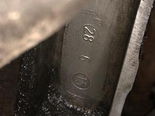

The original photos below are dead so here is another example of the engine case stampings:
Right side case half, on left side of generator stand:
This stamping is:
3 5 16
indicating
3rd day of 5th month (May), production shift (1), year (6)
so this case half was produced during the 1st shift, May 3rd, 1956
Left side case half, to the left of the oil pump:
This stamping is:
3 5 36
indicating
3rd day of 5th month (May), production shift (3), year (6)
so this case half was production during the 3rd shift, May 3rd, 1956

As I understand it, it is in the form of day month (shift)year.
19 = day
12 = month
22 = year (2nd shift) 1952
0 = 1950, 1 = 1951, 2 = 1952, 3 = 1953, 4 = 1954, 5 = 1955, etc

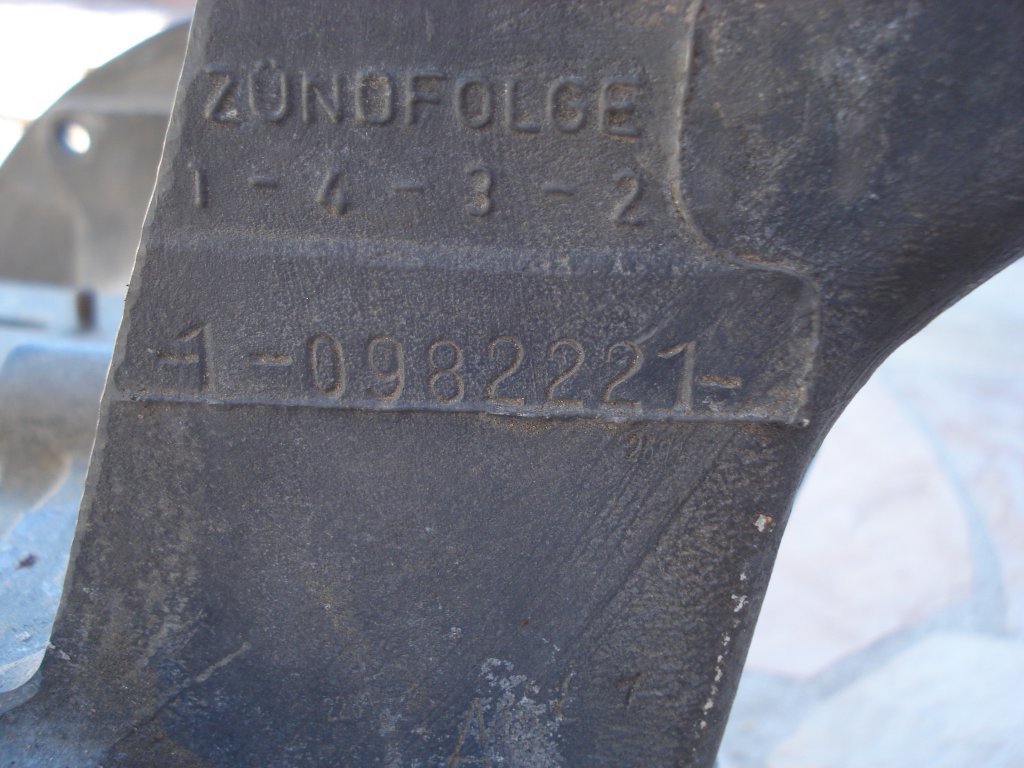

PostPosted: Sun Oct 04, 2009 11:29 pm    Post subject: Reply with quote
These arent much but its all I can get.

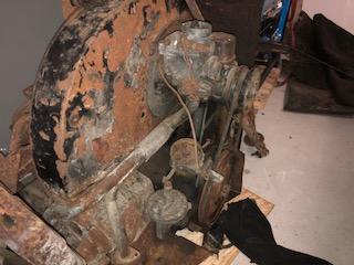

This is my block that I have for sale. I thought it was a 36 hp. What are the differences visually between a 36 hp long block and a 25 hp. The reason I ask is that the numbers stamped on the case identify it as 25 hp but there is also a stamp underneath the numbers that say it has been rebuilt. Just want to make sure I am listing it correctly.
Damn I am ignorant on these older smaller motors. Embarassed

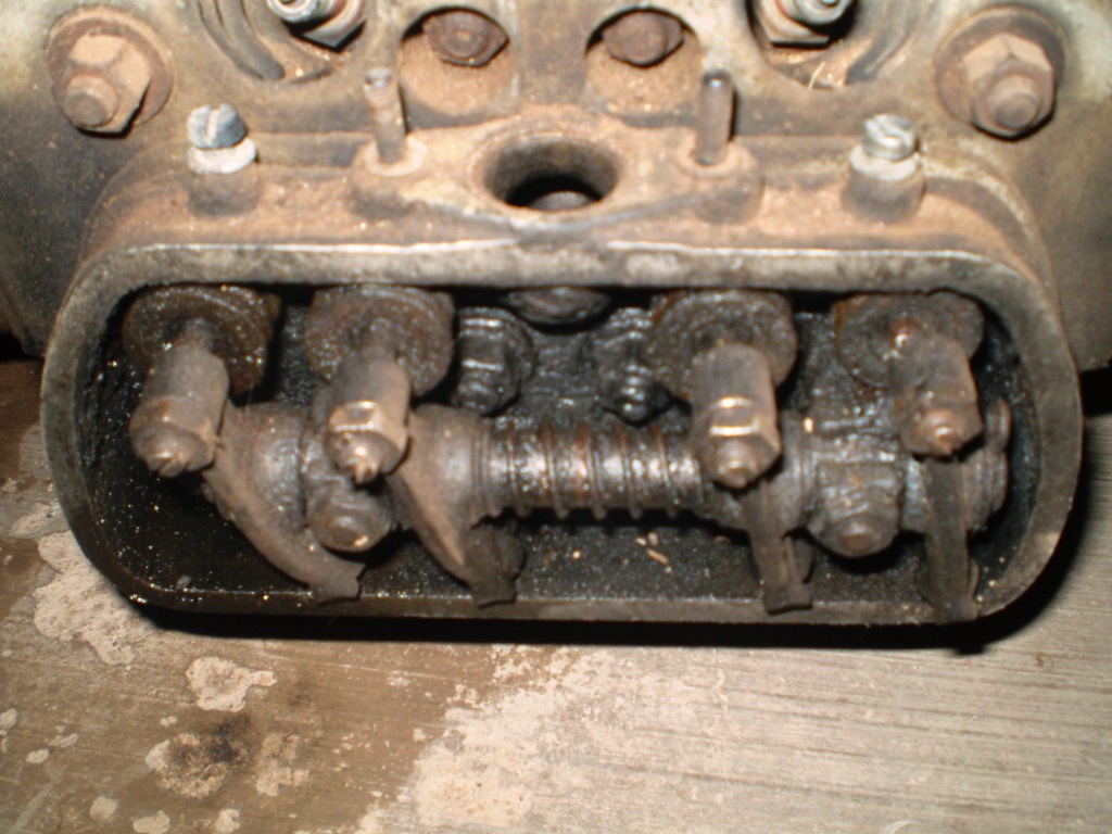

Here are some pictures I just snapped. The first is the engine number. You can see below it that there is a very faint stamping. I believe that is says factory rebuilt, but the letters between the f and y are really faint. I can't seem to get a non-blurry pic with my POS camera.
The other pics are to help everyone identify whether it is a 25 or 36 hp block.

That block has Jan 1951 serial number but it has 36hp heads and the bottom appears to be 36hp as well. The block could still be 25hp with the cylinders bored out for 36hp pistons and heads.

I think we're looking at a 1962 crankcase, not 1952. It has the larger, 40hp sump plate and the spacing of the "1-4-3-2" is much closer than earlier blocks, but the lettering does not appear as large as the mid-'60s cases.
