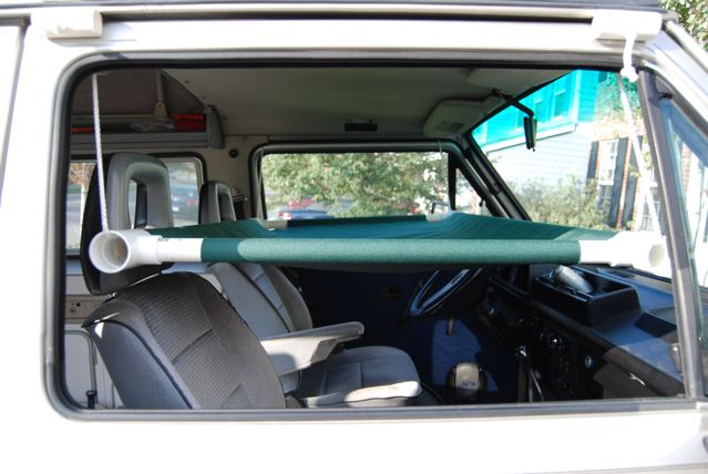

Here's a few pics of a cot I made for my van. I used 2 inch pvc pipe for the main span and 1.5 inch for the cross pieces. Sewed sleeves in the fabric and slipped the pvc through and connected the pvc together. Then ran rope through the long pieces and through a hole in 1.5 inch pieces that are used to prevent the rope from slipping back through the door closure. Store it in the pop top gap up top when not in use. So far, the 6 year old loves it. Now we can sleep 5 comfortably.

clever! thanks for sharing.
(just remember not to open the doors when there's a kid sleeping...but you've already considered that). You could also use rubberized hooks and hang it from the drip rails. That would allow you to open and close the doors.
With only one todler, I figure I've got at least 7 years to work out something similar. If I do the math on the likelyhood of me having 3 kids, this project may never see the light of day.

That is totally kick ass! How much weight do you think the PVC frame can handle? What kind of fabric did you use?

This looks exactly what my parents describe as the device they used to put me in while DRIVING when I was a baby - except it conveniently went from front to back. More of a launch pad than a safety device.

I really like your idea-especially having the toggles out the door for support. Does the plumbing come apart for easy storage while driving?

I think the pvc will hold a fair amount of weight, certainly enough for someone small enough to fit comfortably in that space. I bet it could easily take 150 lbs. I used cordura fabric, the stuff backpacks are made out of, and "outdoor" thread found at the fabric store. I think it's just a little thicker than regular thread, but regular would have worked. The only thing that might have to be improved to handle heavier loads is some "stays" or pieces similar to that on the doors that hold the ropes in a fixed position so the cot doesn't slide up or down on the ropes.

I just have the plumbing pieced together and it could come apart and be rolled up. It really just depends on how tightly you sew the fabric sleeves. I leave mine in one piece as it fits nicely in the top.
And another bonus is that it makes a nice gear loft during the day...

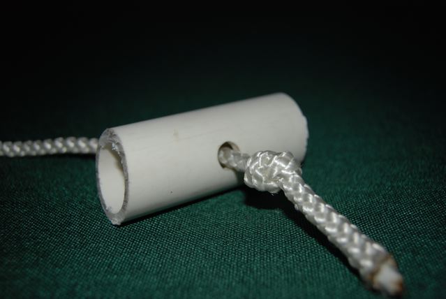

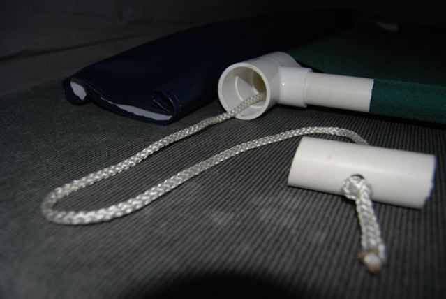

The rope I used is one piece and runs through the long tubes. On each end there is a "stopper" made out of smaller pvc sections that provides more support for the bed on the door and makes for quicker setup. I simply drilled holes through the "stopper" pipe, threaded the rope through, and then tied a knot.
heres the pics:
and
If I recall correctly, the pvc long pieces are about 50" long and the shorter pieces are about 29".
I didn't use any adhesive as the friction of the fittings holds it together just fine. If I did glue it, I'd use the standard pvc pipe glue found at home depot with the pipe. I imagine in a few years (if I'm still using it....my youngest is only 11 months...so probably) I will have to glue it as I am guessing the joints will loosen. Having it glued in one piece shouldn't be a problem b/c I've just been storing it up in the top bunk all put together.

One improvement you could make- use a piece of radiator hose instead of PVC for the "stopper" that goes outside the door- it won't mar the paint. I have bow straps for my Kayak that use it to secure the straps under the hood and rear hatch.
