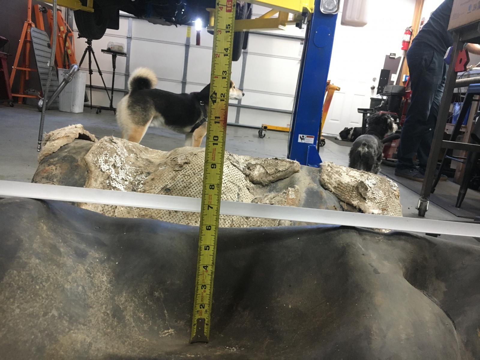

Starting to round up parts for a tdi conversion in my syncro.
Anyone holding a syncro diesel tank that they would like to sell? Anyone have directions/measurements for reshaping my current tank aside from “one guy does it with a bowing ball?”

This is the way the diesel tank is shaped to clear the starter.
Anyone know the depth/width of the indent and location measured from one side or should I start counting pixels?

I know of the concerns with using a DOKA tank (fill the existing filler hole location, different size vent nipple on the top). I have tabs on one of these semi-locally and seems like the best option with the risk of reshaping the tank. The seller has also expressed that he has previously successfully patched the DOKA filler hole using VW HDPE (from a Passat or Jetta tank) and a plastic welder.
I would like to stick to using the diesel starter and the diesel bellhousing and not using an adaptor plate (personal preference, parts on hand).

Seems like the DOKA tank will be my best bet and then re-selling the gasser tank to someone that is collecting parts for a conversion.

As long as you can seal the Doka tank fill neck hole and get the new fill hole correct, seems like a good solution. I’m remembering waiting a couple years for one to come along. I had a WTB add running here till Karl reached out to me.
I have a 2nd generation TDI engine in our 2wd camper with a diesel bellhousing. As far as mounting the engine, I don’t see an advantage over a quality adapter plate. I would need a very custom oil pan to take advantage of the diesel bellhousing. I have a torque mount to take some strain off of the bell housing. 1st gen TDI with a diesel oil pan, the diesel bell housing would be the way to go.

Got a diesel syncro tank from austria for €130 shipped.
Figured I would document the size and shape of the indent for the starter with the diesel tank next to the gas tank for posterity since no one could answer the same question a few months ago.
Heat and squish away.
