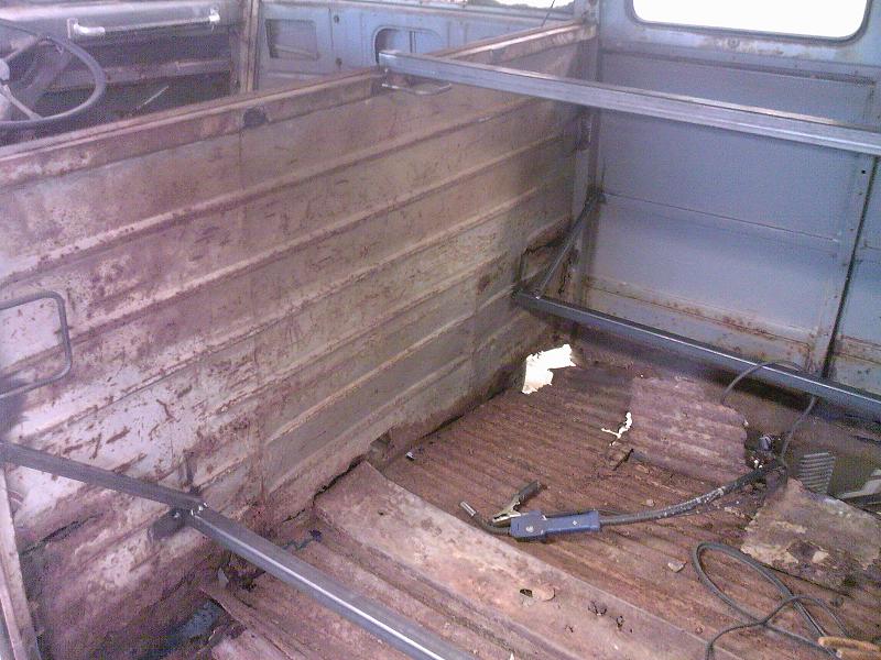

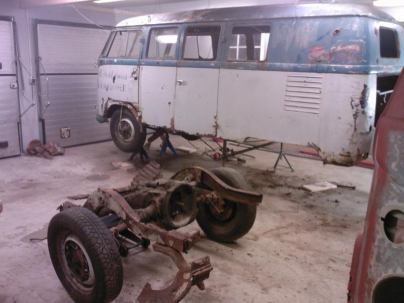

I just realied that I should put my 54 on here. I have posted a bunch of pictures to the gallery but never collected them in a forum post...
Ok here goes:

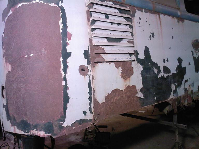

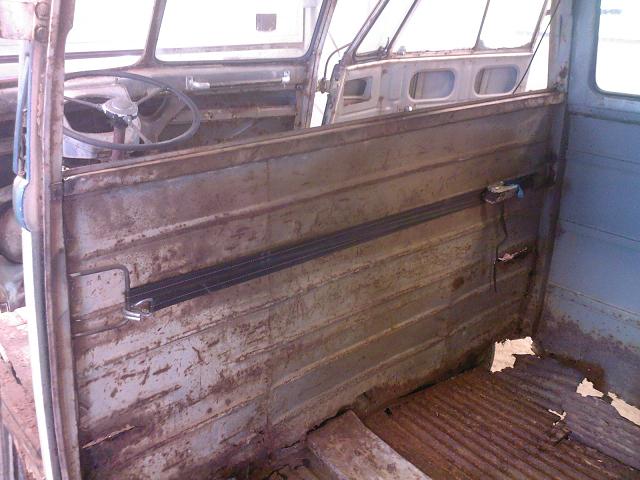

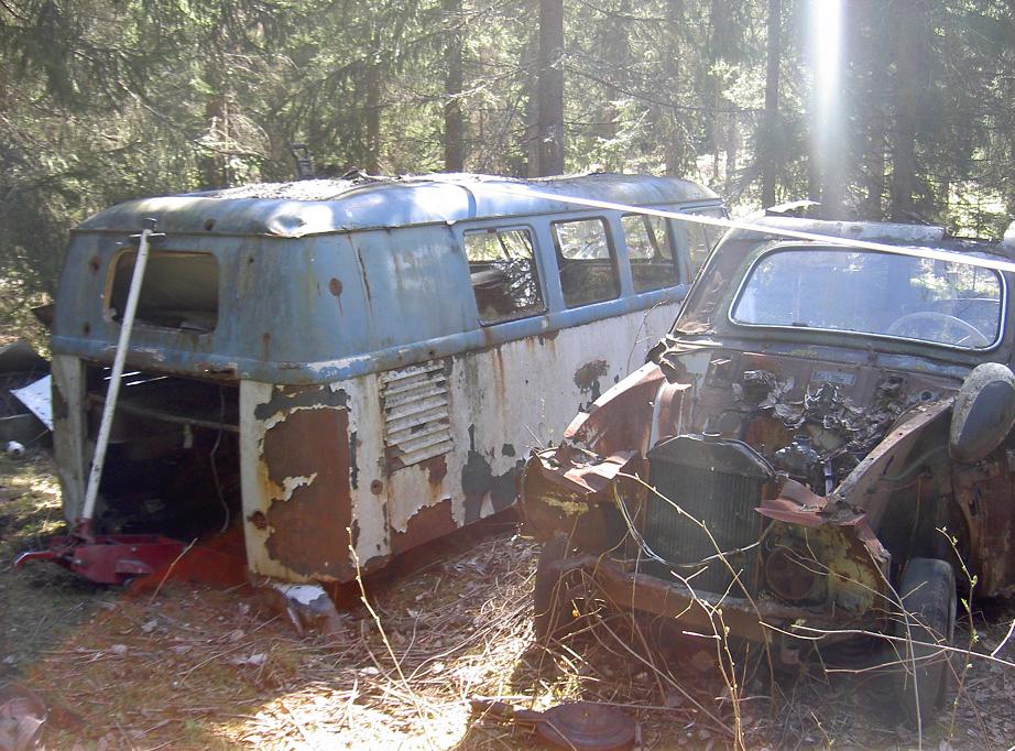

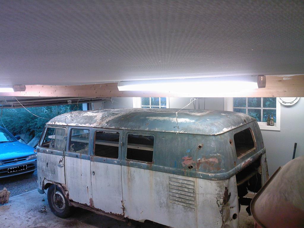

as we found it:
In the garage with the roof sorted.

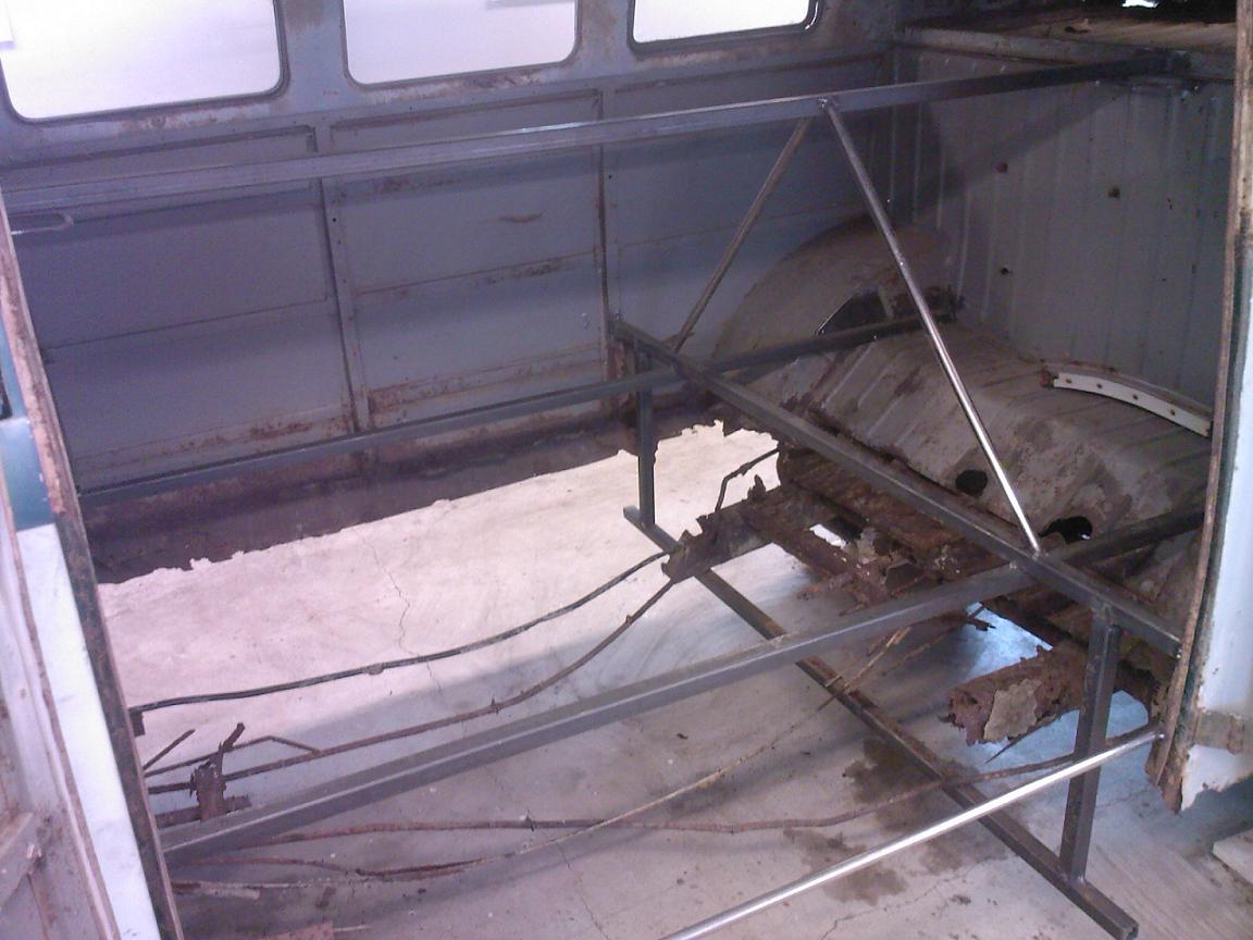

Getting some basic measurements back to were they should be...

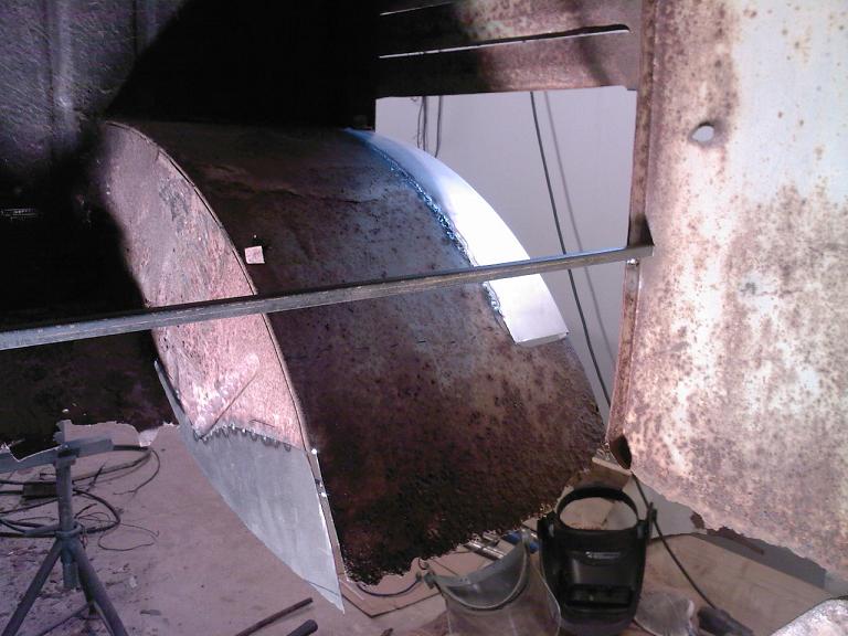

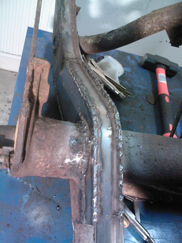

Supports welded in:

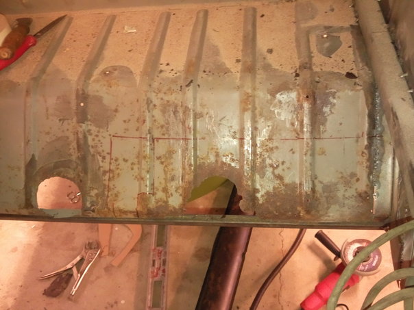

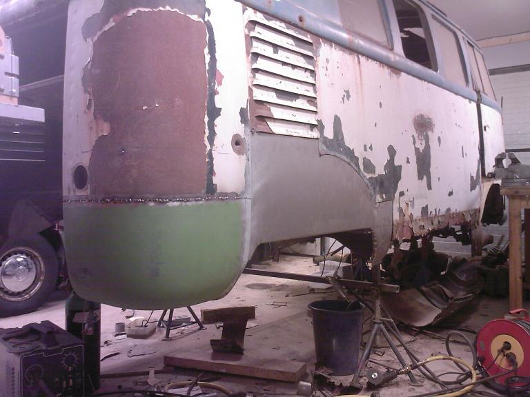

Out with the old floor pans...
Oh no... The rear stayed on the ground as the bus was lifted up in the air...

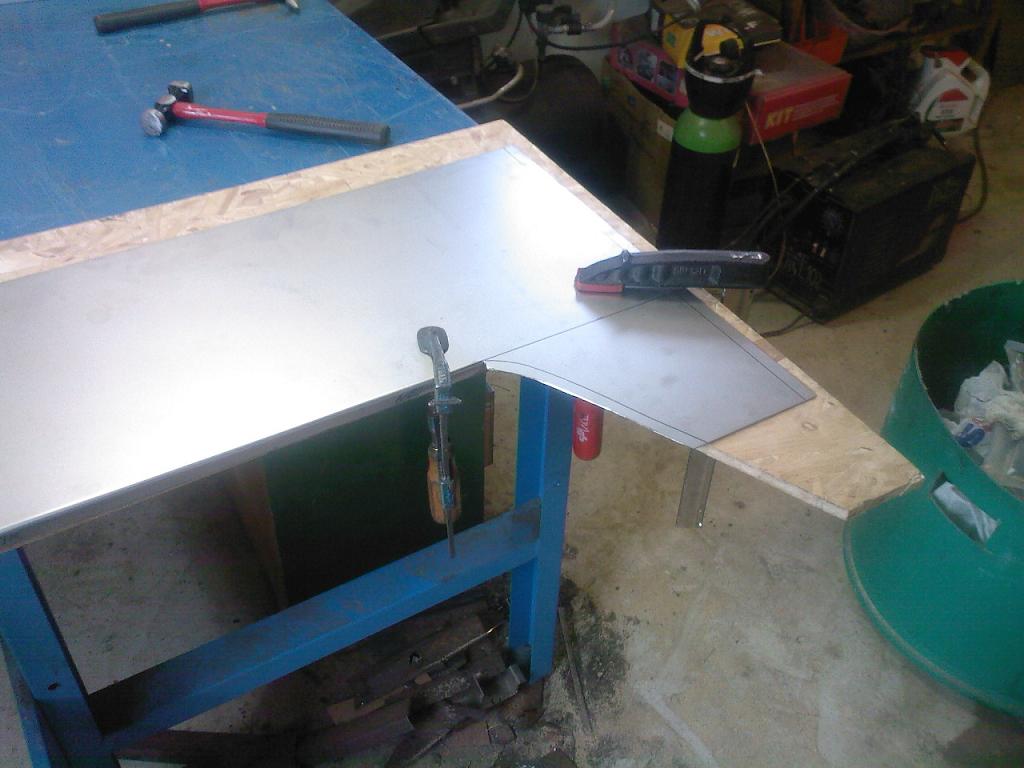

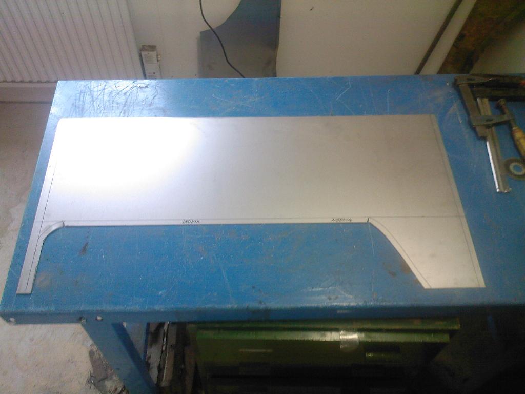

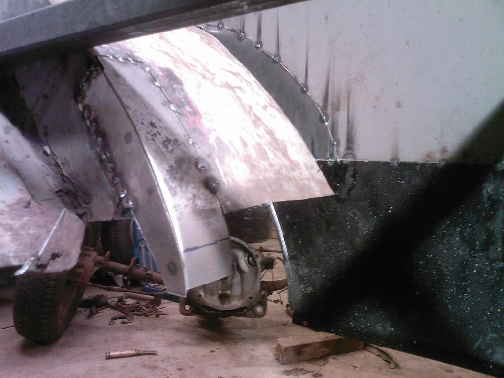

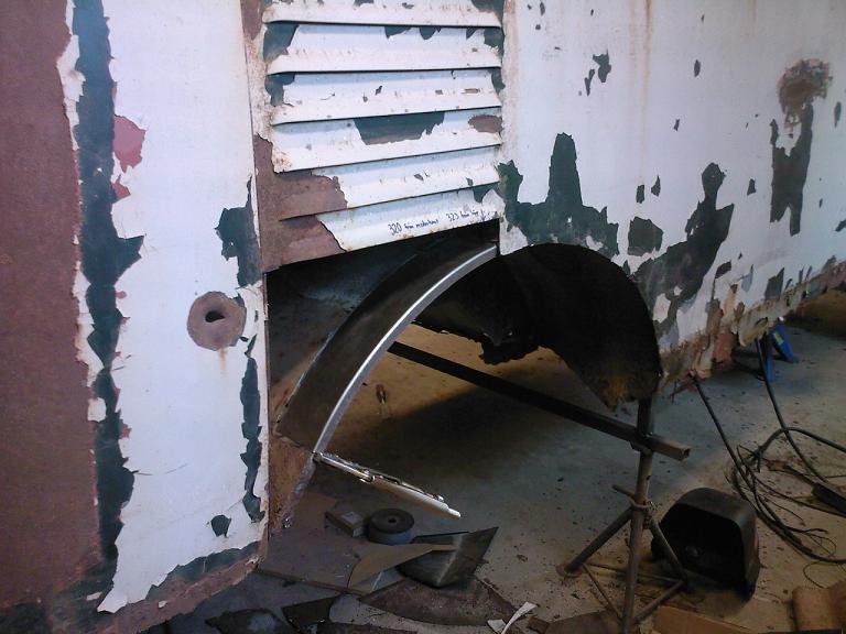

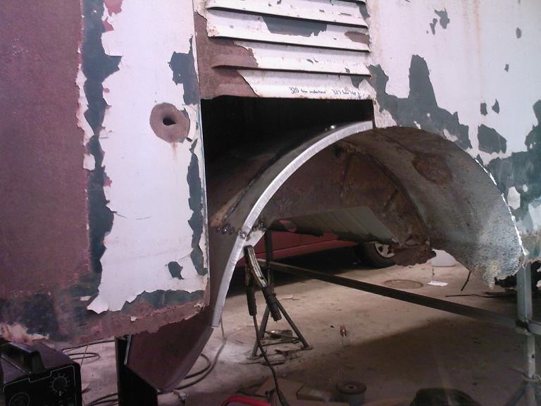

Making my own side panel...

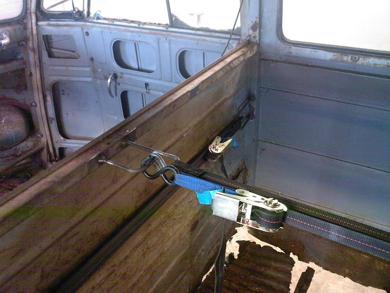

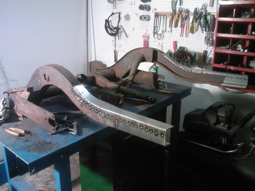

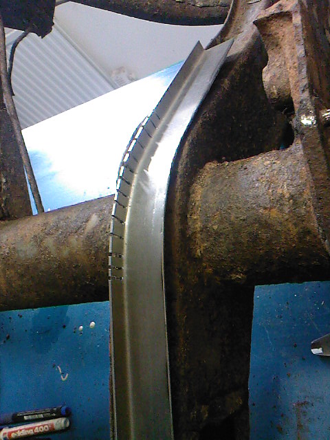

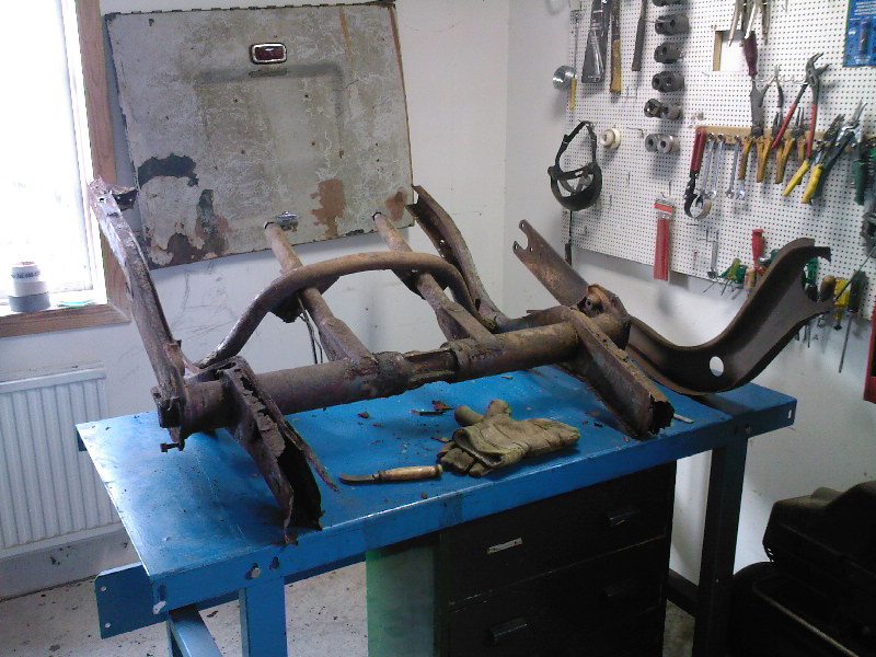

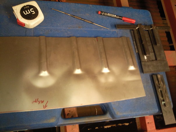

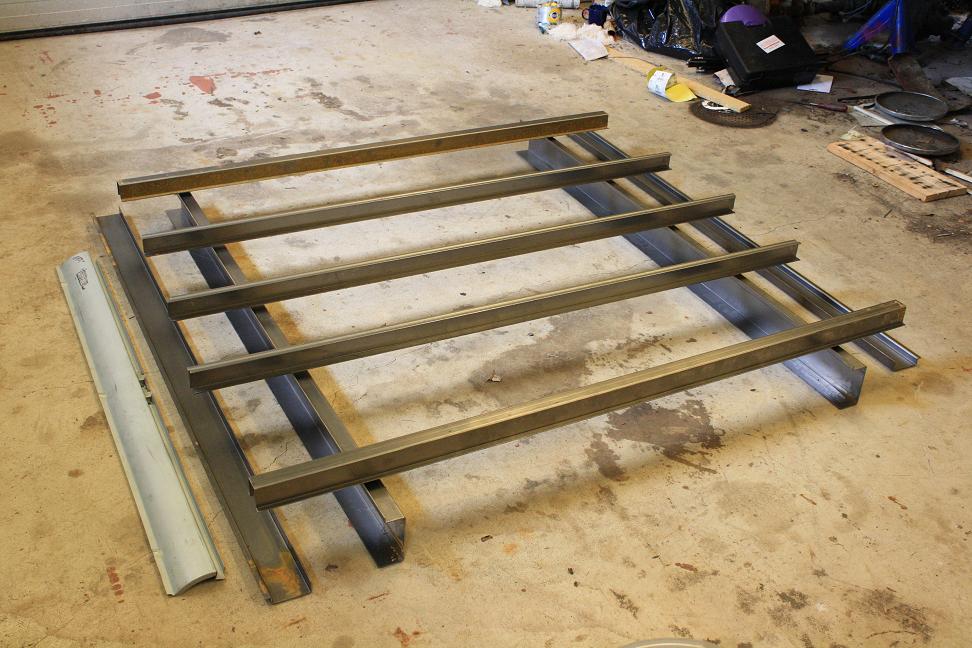

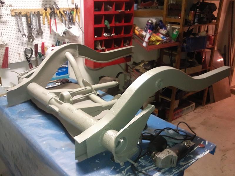

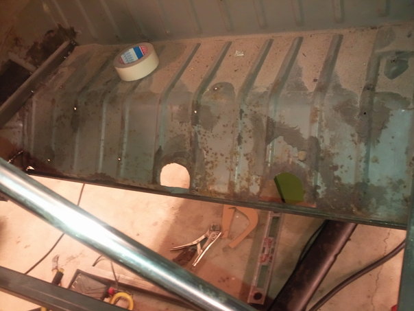

Collected some material for the chassis.

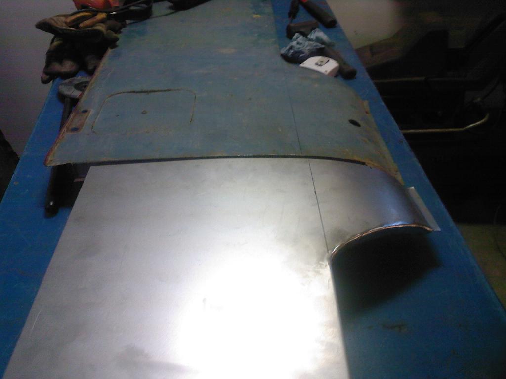

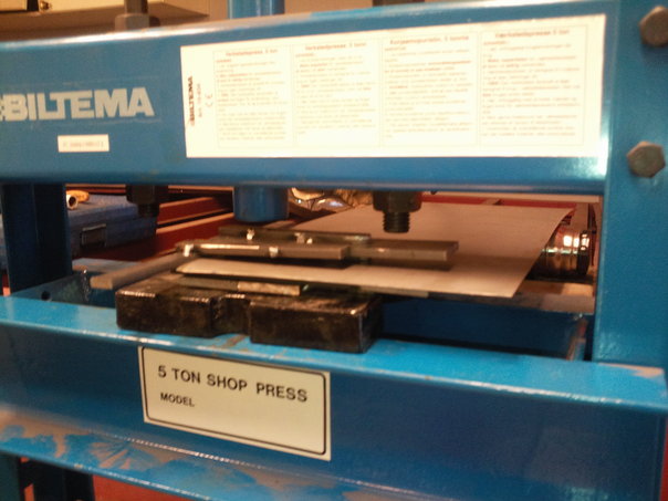

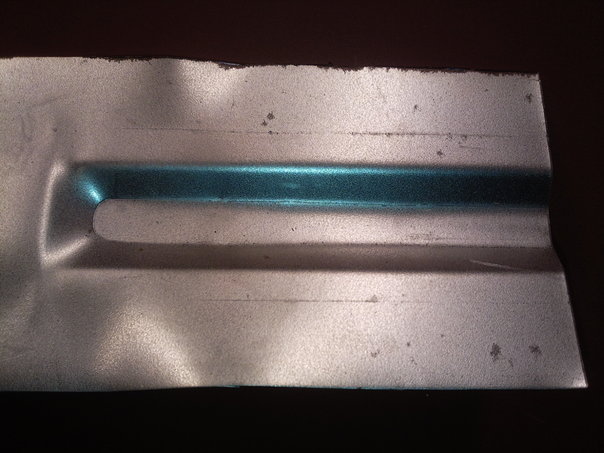

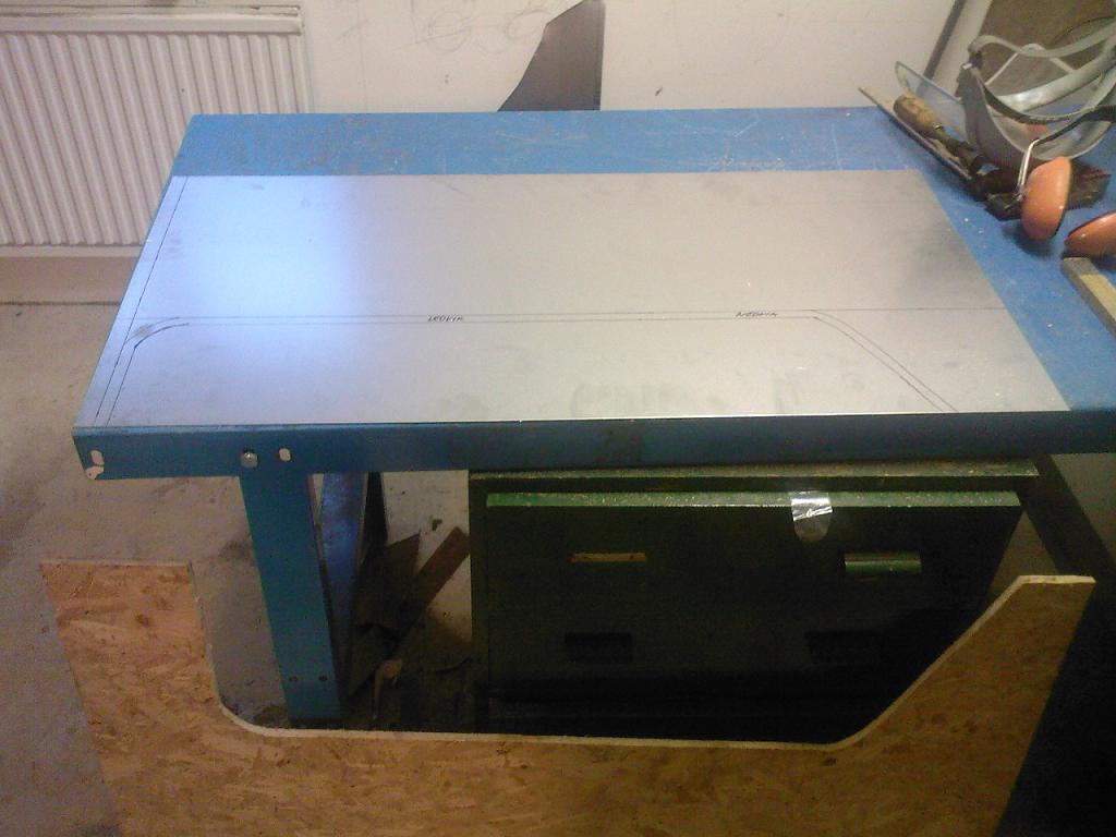

I need to replace the bottom of the metal between the engine compartment and the loading area. I made my own pressing tool for this. I hope it will work. The pressing procedure warps the metal a bit but hopefully I can address that somehow.

Nothing said against Gerson, his stuff saves a lotta buses and I have seen the quality, but it's cool that you build it yourself !!! Try to use a 'shrinking disk' on the warping, it's a stainless steel disc that you use on the angle grinder, applying heat to the panel while softly touching it with the disc. It works very well, you get them on ebay.com.

djfordmanjack wrote:
Yessss, very good job on the pressings. that keeps me going on in my totally rusted out projects, thanx!
Thanks for that idea. Will look in to that.

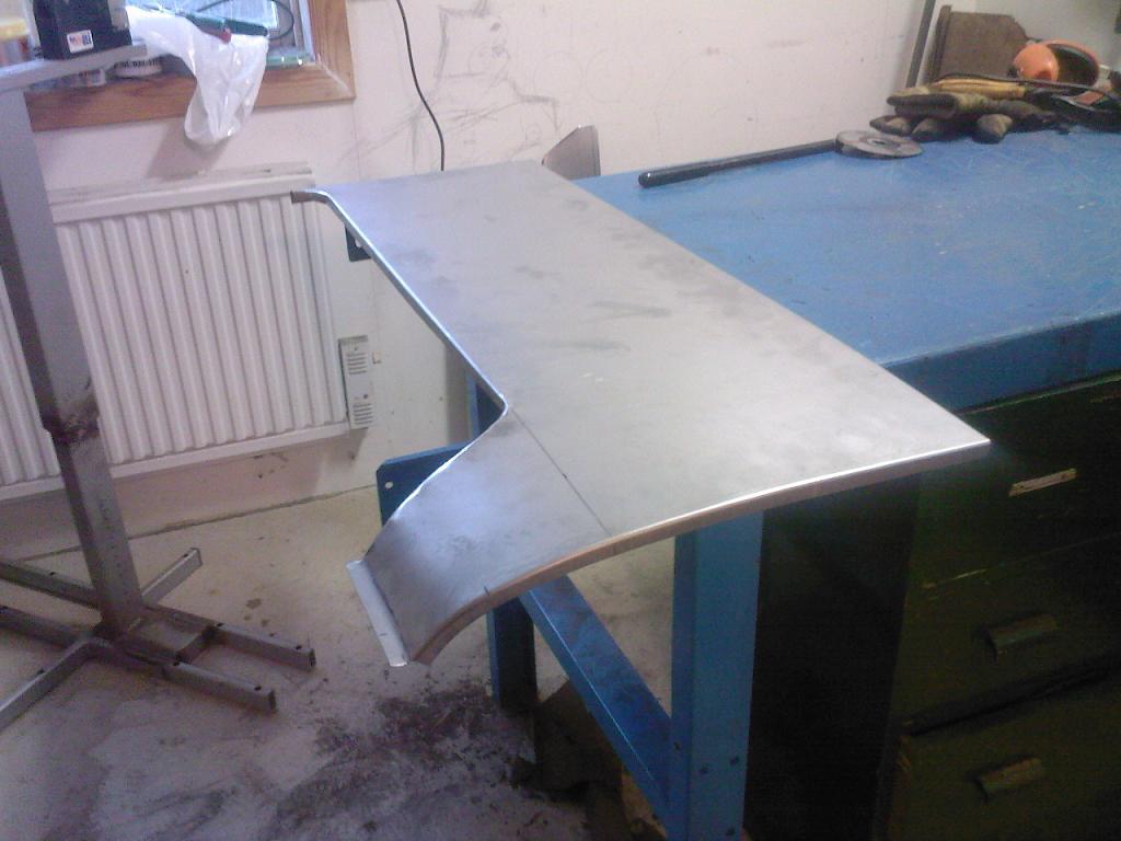

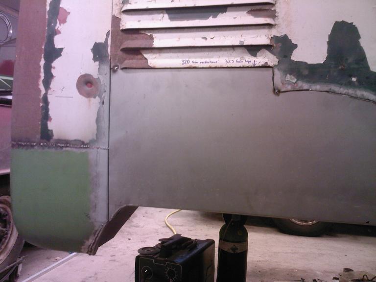

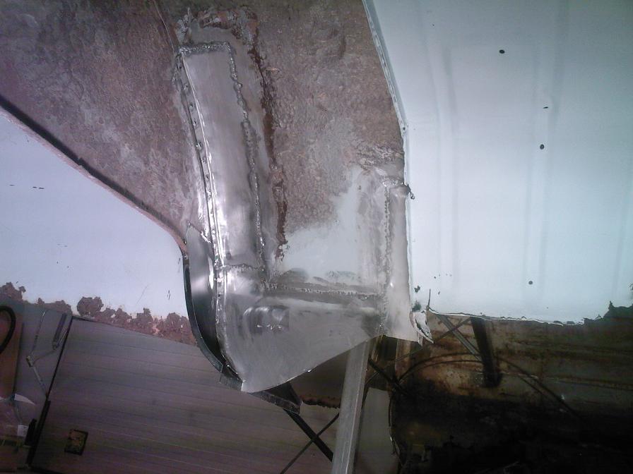

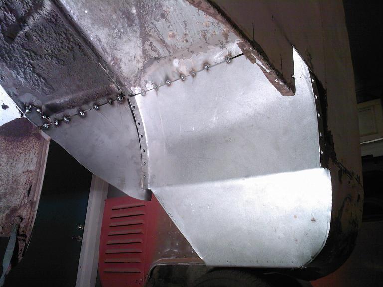

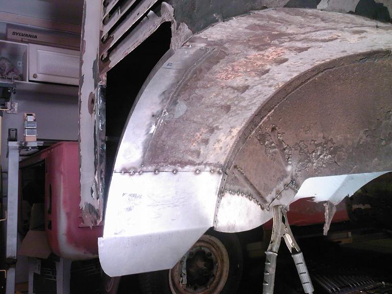

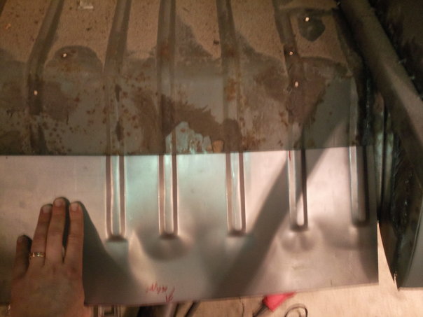

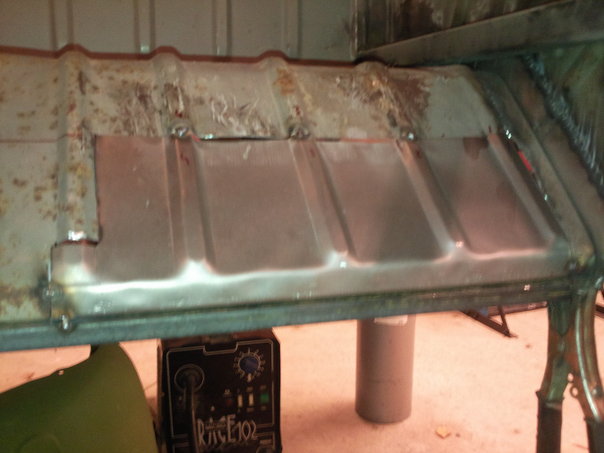

Worked with fitting my home made panel today. It was not easy since I had to get rid of the warps in the metal. I managed to get rid of almost everything by using my shrinker and stretcher. Now most of the warping in the metal is on the down fold were the floor pan is going to be attached so that will not be visible anyway.
Before cut...
Finally in place but only by a couple of spot welds so far...
More to come.

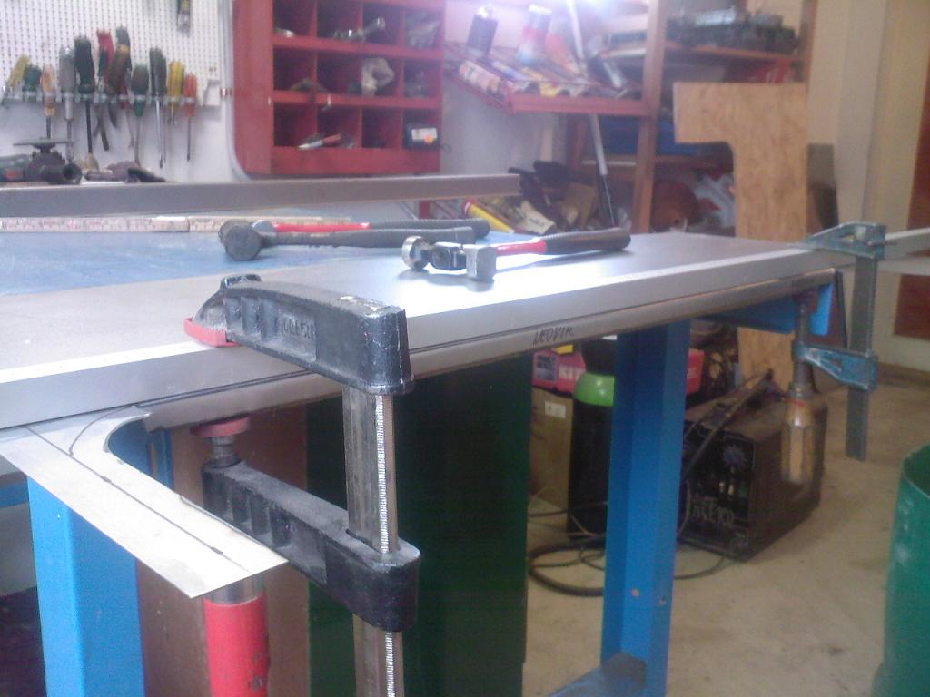

I am very interested in hammer forming and want to try this myself. Can you post pics or explain what technique you used to get the radius in the side panel after the initial flange was hammered? Thanks and keep up the amazing work!

ovalteen wrote:
Hi, I absolutely love builds like this. Especially ones that save vehicles that would have been thought to have been beyond repair and scrapped.
Its not difficult at all and when you get god at it its so much fun. But you need some good tools. You need a shrinker and stretcher to shape metal in an easy way. The panel above had its curve made by the shrinker. By using the shrinker on the flange I get the whole panel to curve.
Check this out on Youtube:
http://www.youtube.com/watch?v=1_LuzEjbhdc&feature=fvw
