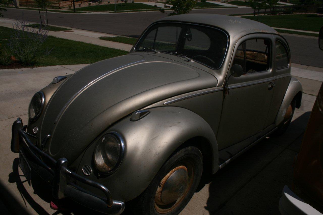

Yes it was ... here's a picture of a '59 I had last summer for a short time, and the fender closest to you was an original one. I looked for better pic's of the fenders and couldn't come up with one.
