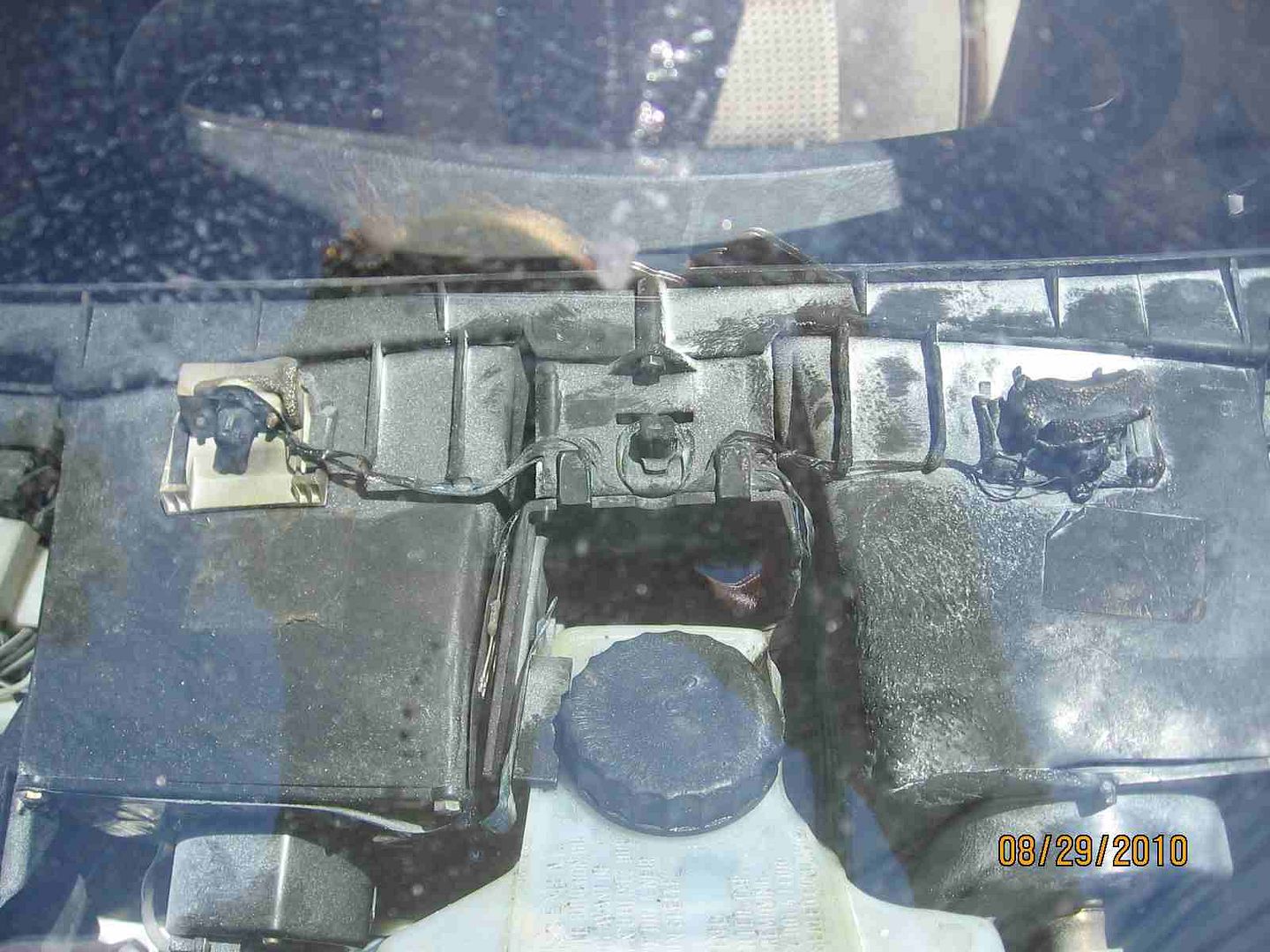

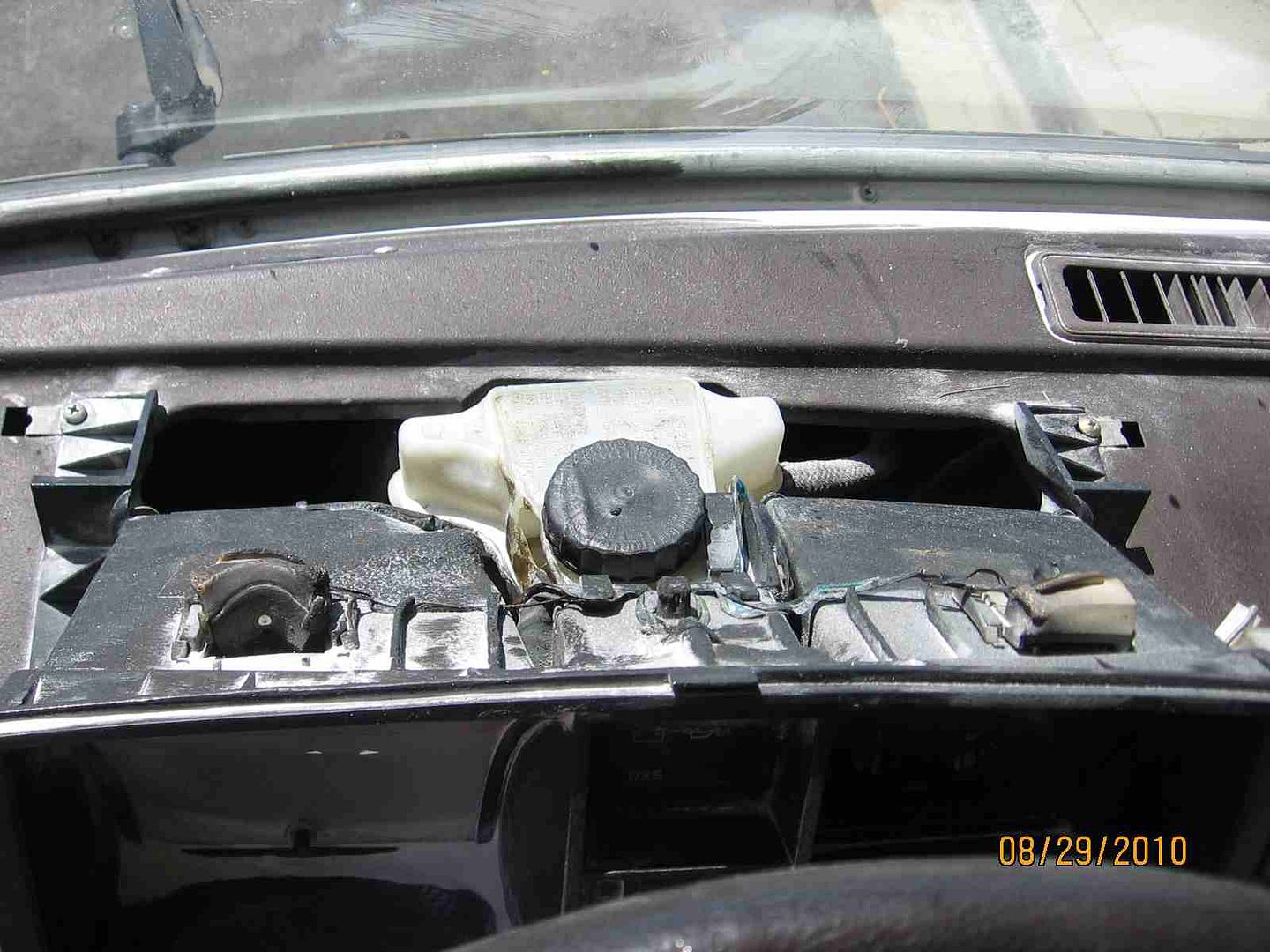

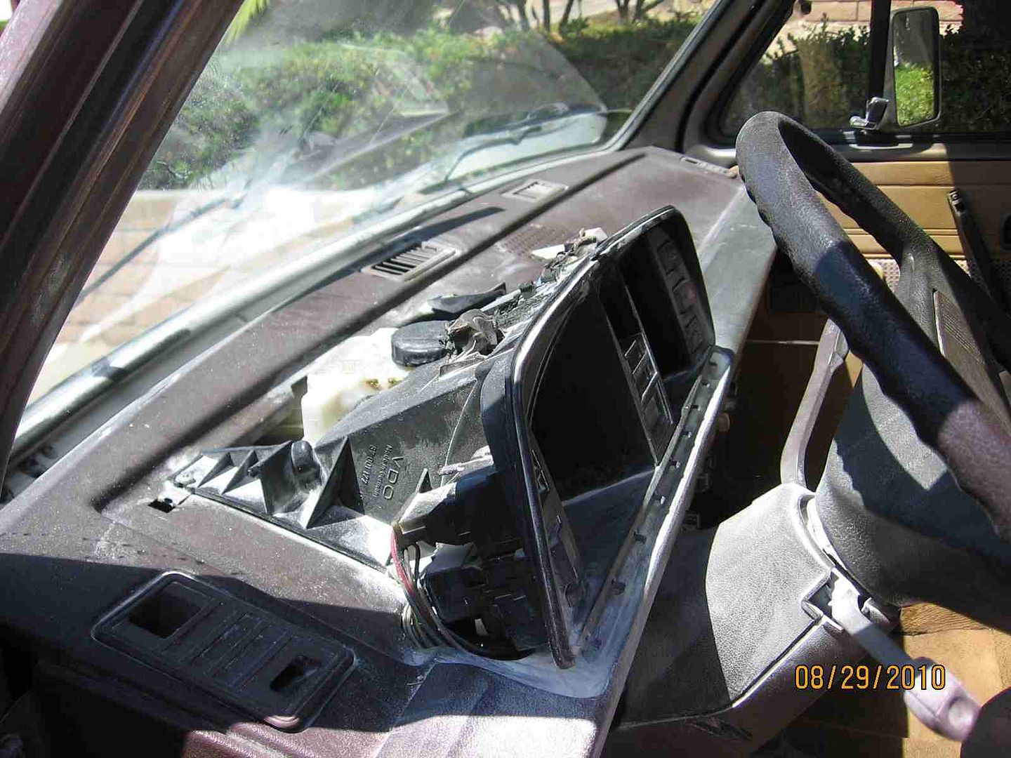

Here's an update with new pics. The Vanagon is being towed over to my house right now. I'll get back with more later.

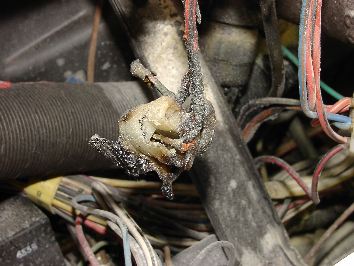

You mean something like this?
I just got my first hour in on the Vanagon and spent most of my time blowing out dry chemical dust.
Found all the wires going to one of the brake switches on the MC all burned through. Still looking

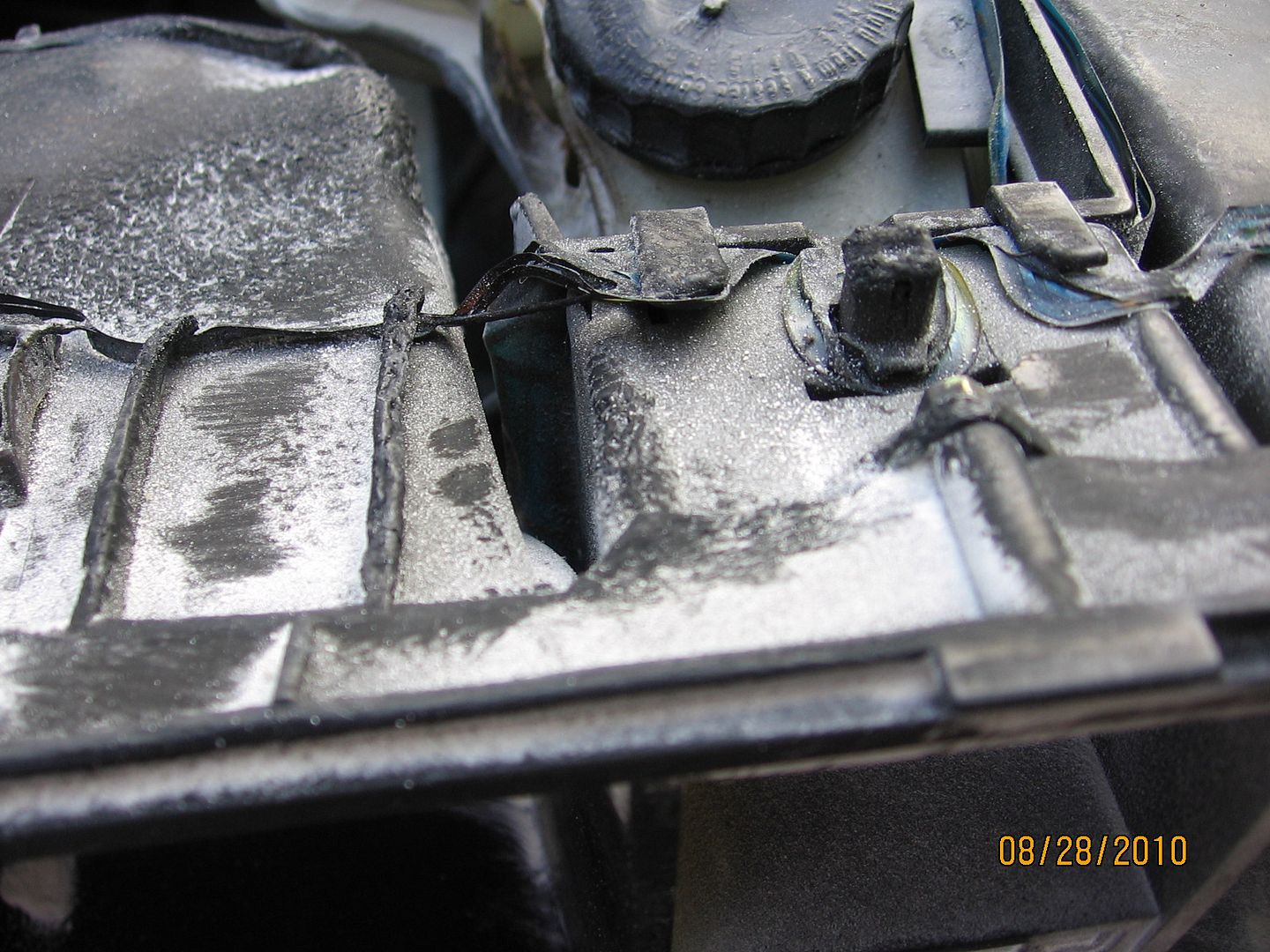

You can see that the fire was the most dense and/or the hottest of the front left edge of reservoir. The source might have been below that or that is where the most material that could burn was.
Because the powder chemical makes such a mess and because its a 12V system, could one use water if one had water handy?. Less after mess and water dries.

It looks like the melt down started at the most forward brake switch connector on the master cylinder. Those wires got hot and started flames which melted the brake fluid reservoir which dumped brake fluid onto the fire. Not sure whether or not the brake fluid ignited.
The wiring repair looks fairly easy. I've replaced both brake switches and now just have to splice in some new wire to them. Piece of cake. Yesterday I was able to order most of the parts needed from thesamba classifieds. All I can assume is the the brake switch somehow failed internally which caused a dead short. This circuit must be hot with the key off but I'm just assuming that right now.
I've cleaned a lot of the dry chemical up but was wondering how corrosive this will be to the dash and wiring. Is there something I can use to neutralize it?
