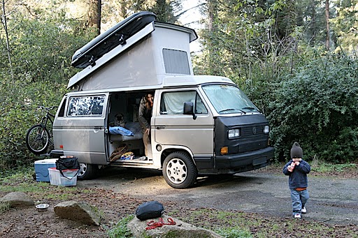

I have a friend with 16" wheels and the Yokos on his van. He really loves them. I've ridden in the van and they are nice. They are tough but much quieter than the BFG's. I'm going to consider them for my next set. I don't think you could go wrong with them. I'll see if I can find a picture to post.

Here's a couple pictures. Geolander A/T 215/60/16"

PDXwesty,
Do you know what size those are?
I love my BFG's but I find myself back looking at 16's again...

joetiger wrote:
PDXwesty,
Thanks
I'm pretty sure they are the 215/60/16 A/T-S. Went through Baja with them no problems.

PostPosted: Wed Jan 27, 2010 2:58 pm    Post subject: Reply with quote
I went with the 215/60R16 Yokohama Geolander AT-S. I really like them but can't compare to hydroedge other than a few drives in someone ese's van.
If you want to jump to my write-up in the tire sticky it is on the bottom of page 33:
http://www.thesamba.com/vw/forum/viewtopic.php?t=2...;start=640
