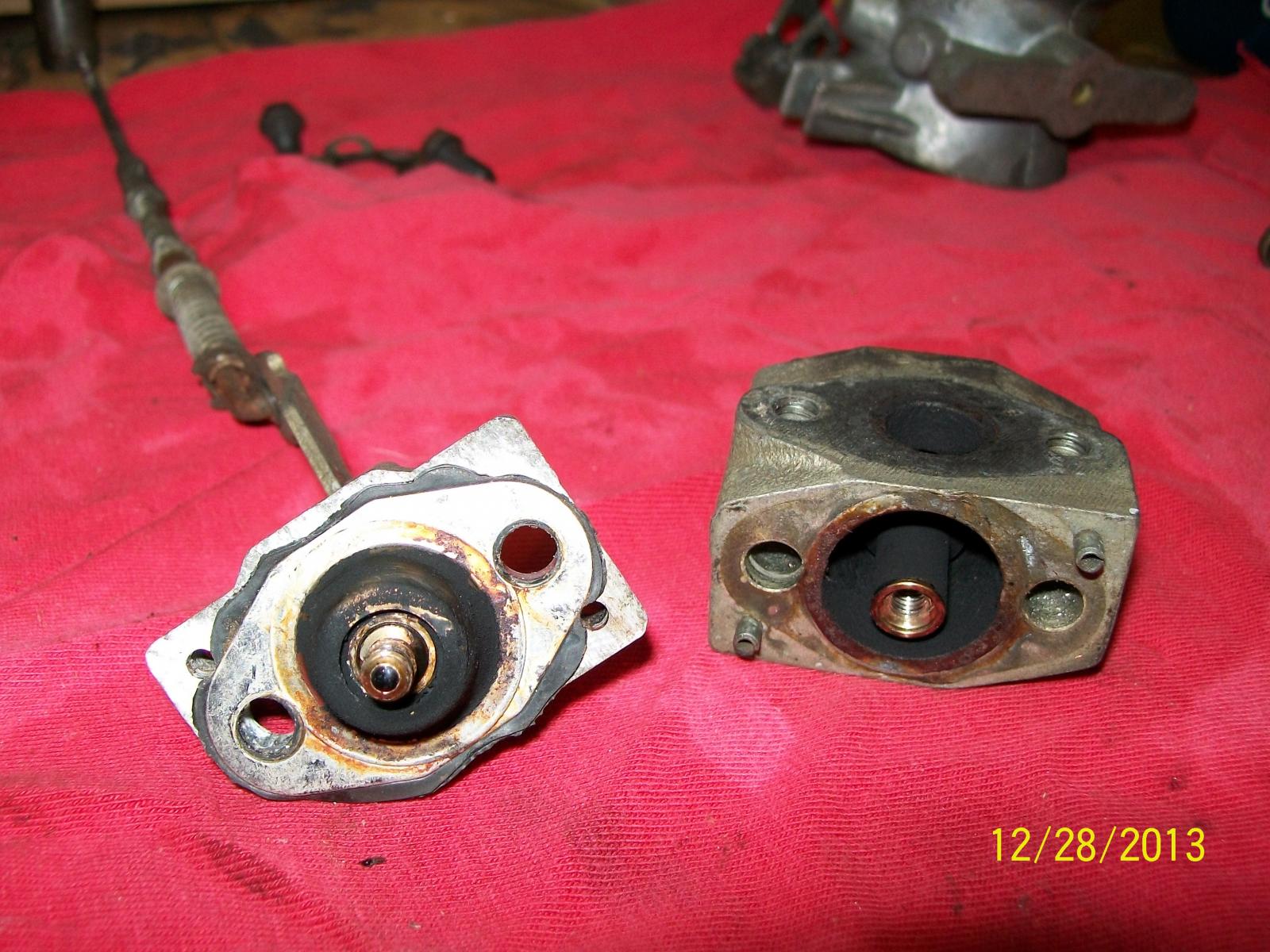

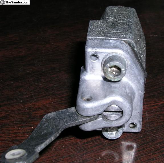

But you say the tubing is disconnected... this is in a way to eliminate any of the exhaust gas to flow into the plenum, or what? If this is indeed the case, then take a look and try to figure out if a bent control arm on the EGR valve is causing some other issue with fuel/air mixture.
EGR gaskets from SGKent:
Does your EGR valve look like this? (thanks to Tcash)
Here's what mine looked like after I disassembled it from my 1977 bus:
