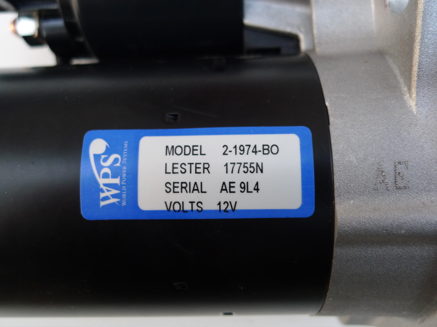

PostPosted: Wed Feb 17, 2010 1:04 pm    Post subject: Reply with quote
Just to close this out yes this ebay starter motor
http://cgi.ebay.com/ebaymotors/ws/eBayISAPI.dll?ViewItem&item=300277150519
is a WPS(WAIglobal and Transpo Electronics) Unit
they are sourced from http://www.wai-wetherill.com/
looks like they also have an online partplace http://www.wpsparts.com/
and its part 2-1974-BO aka the SR0409X
http://search.waiglobal.com/partsearch/partnum.aspx?part=2-1974-BO
interesting is that 2-1890-BO spec is 1.8KW aka the SR0408X
http://search.waiglobal.com/partsearch/partnum.aspx?part=2-1890-BO

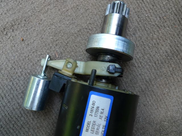

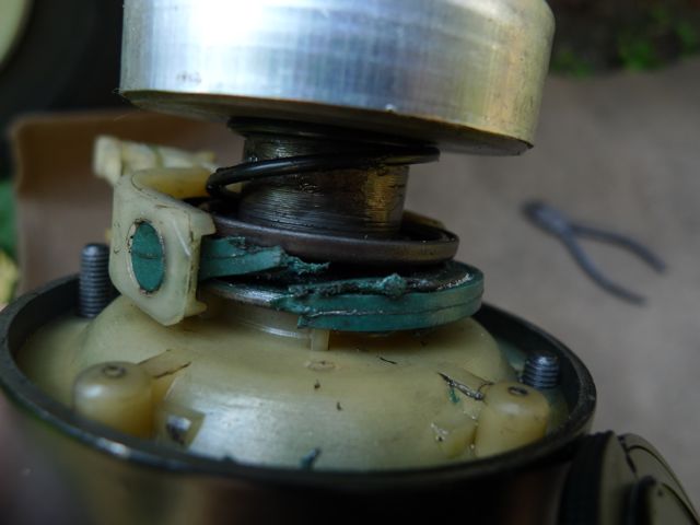

tclark
Joined: November 21, 2005
Posts: 926
tclark is offline
PostPosted: Thu Feb 18, 2010 1:57 am    Post subject: Reply with quote
wcdennis wrote:
I just bought one of those eBay starters and the Westy Ventures adapter I will report back after I install it.
Any chance you might want to take the starter case apart b4 you install
and confirm the 'design flaw' that buffbuh claims in this thread
(Also he did not get the 2KW model he claims to of got 2-1890-BO 1.8KW)?
http://www.thesamba.com/vw/forum/viewtopic.php?p=4395099#4395099
and take pics so the collective sambanistas sp ? can weight in in this on this China junk theory ?

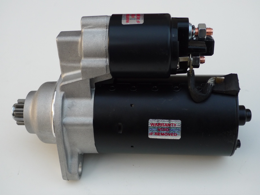

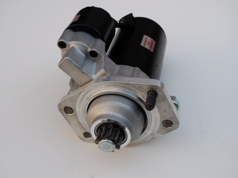

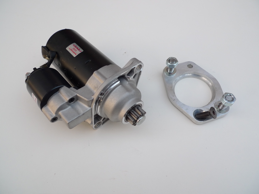

PostPosted: Fri Feb 19, 2010 4:49 pm    Post subject: Reply with quote
Here are some photos of the eBay WPS SR0408X starter and WestyVentures adapter:
Here it is with the adapter plate:
Here is the adapter mounted on the starter:
Here is the testing video:
All I can say now, is that it works. I haven't decided if I will try to take it apart before I install it and see what the internals look like.
Just FYI that is not a SR0408X
http://search.waiglobal.com/partsearch/partsearch.aspx?part=SR0408X&Submit=Go
its a SR0409X 2Kw
the SR0408X is this one 1.8Kw
and FYI again buffbuh bought the 2-1890-BO
might not make a diff in build quality but he did not buy the exact same unit
