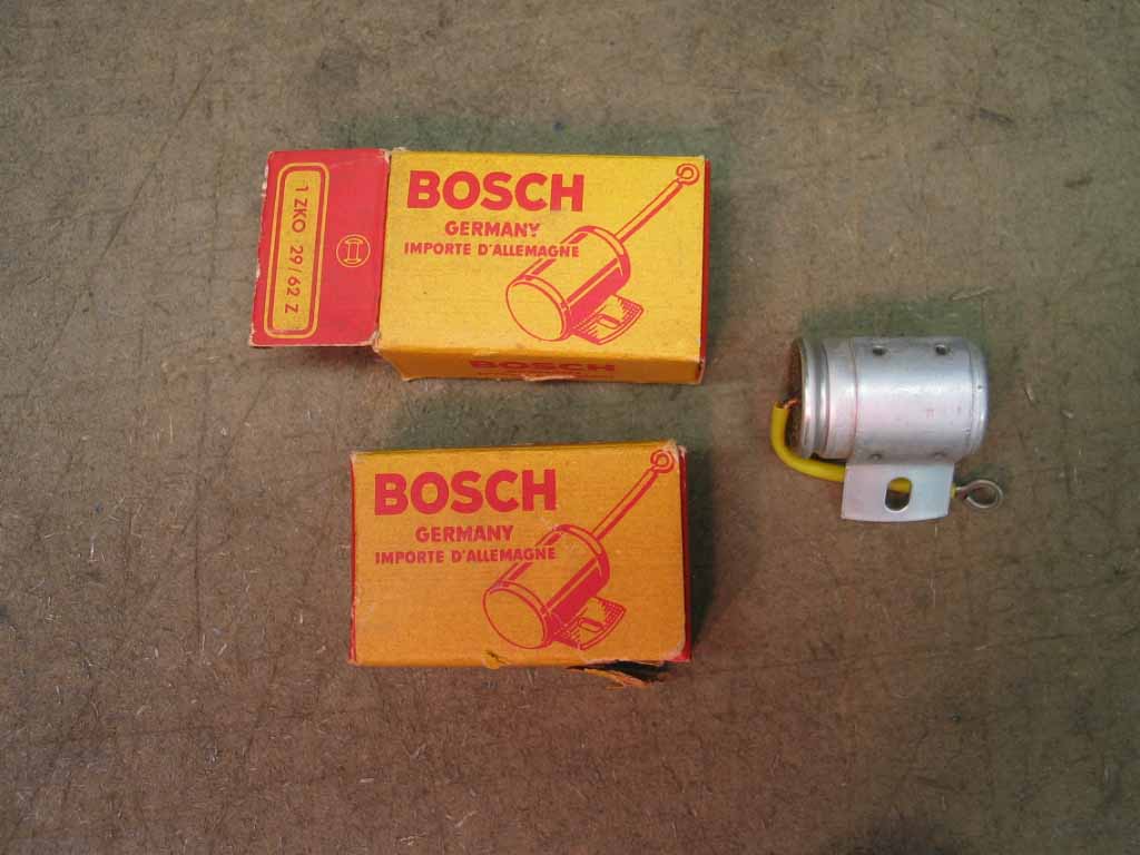

The earliest condensers were originaly yellow wire versions. Later condensers used a green wire. Top left is the unit used on the 010 and BR 25. It requires a bracket that holds the condenser to the body of the distributor. Top right is the model installed on BRS 383, 019 and BR 8's. These have the mounting brackets that are permanently attached to the condenser.
The next example is similar to the 010 model above. They were installed on early cast iron 40 hp distributors. These condensers have a machined end rather than simply a bent wire as above. These parts were mounted inside the distributor requiring a small bracket different from the one used on the 010/BR 25.
The middle condenser in the pic is used on the late aluminum bodied 40 hp through the 1500 cc distributors. The round white plastic plug mounts to the underside of the distributor. A male connector attaches the points assembly inside the distributor body. There is a rectangular tang that mounts on the vacuum can attachment arm.
The early 1600 condensers are similar to the earlier 1500 parts. The lead wire going from underneath the distributor body to the condenser itself is a little longer. I have found that the earlier condensers will work just fine.
The pic shows two later 1600 condensers. The tang is gone and a bump replaces it. The male terminal is bent to accept a 90 degree angled condenser lead. There is a square plastic lug that mounts to the exterior wall of the distributor. The last condenser shown has a lead that mounts in a metal bracket and screw arrangement as shown. There were several variations on this plug and wire attachment arrangements.

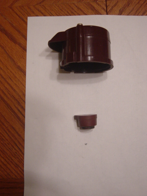

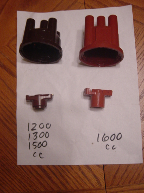

The cap and rotor for the late aluminum bodied distributors and the 1300-1500 cc distributors are short compared to the earlier and later versions.
The 1600cc 113 series M and T as well as later distributors used the same cap and rotor found on the ubiquitous 009's.
Here is a comparison of the late 36 hp cap and rotor next to the 40 hp version. The late 36 hp caps are very similar in appearance to the later 1600 caps. The easiest way to distinguish the earlier caps is by the half round cutout found on the distributor body mating edge of the earlier caps. The cutout accomidates the lead wire bolt that passes through the body of the distributor.
The cast iron 40 hp distributors had a much wider body as the condenser was mounted inside the housing. The "big cap"and rotor are used on these cast iron distributors.

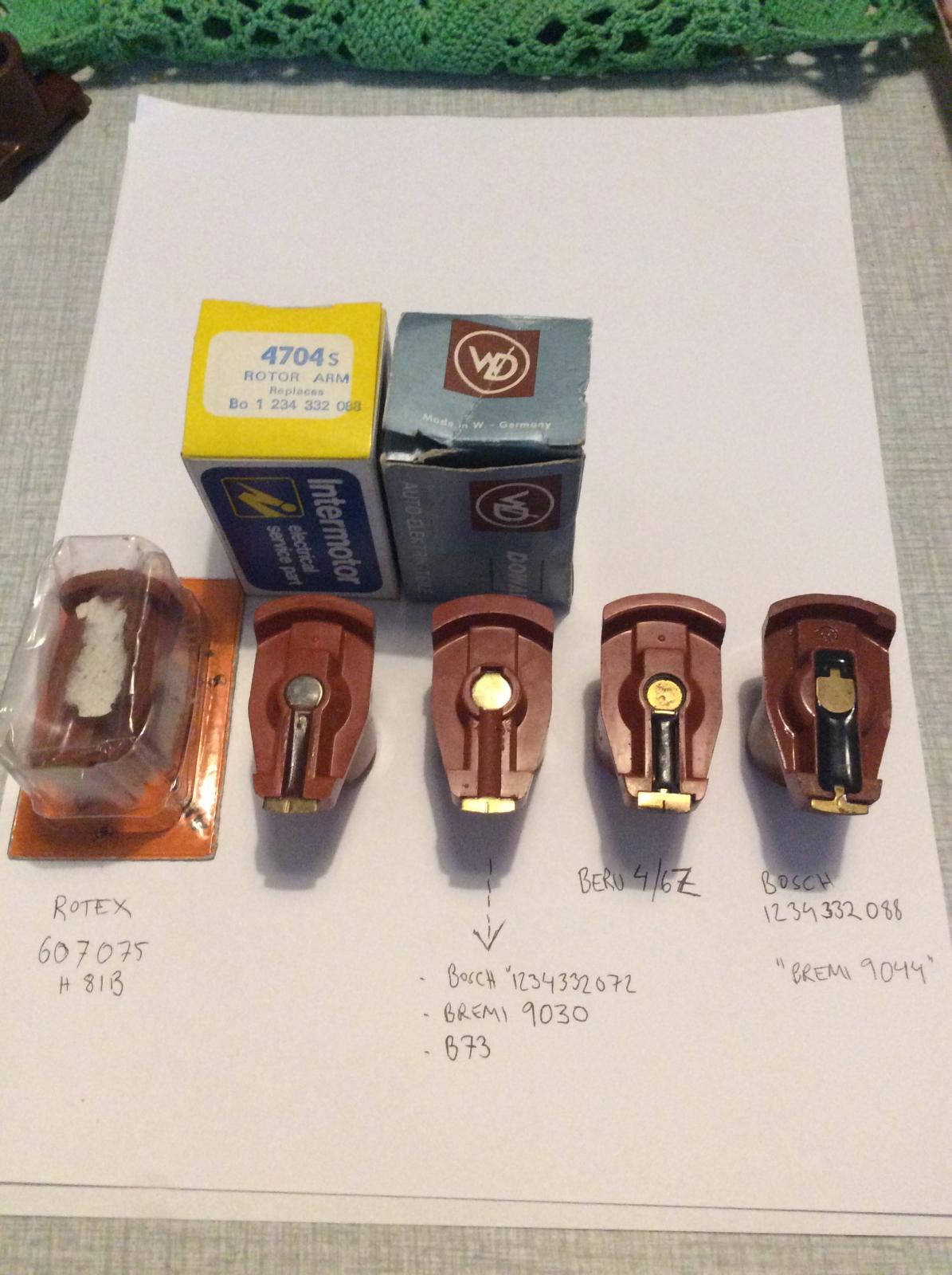

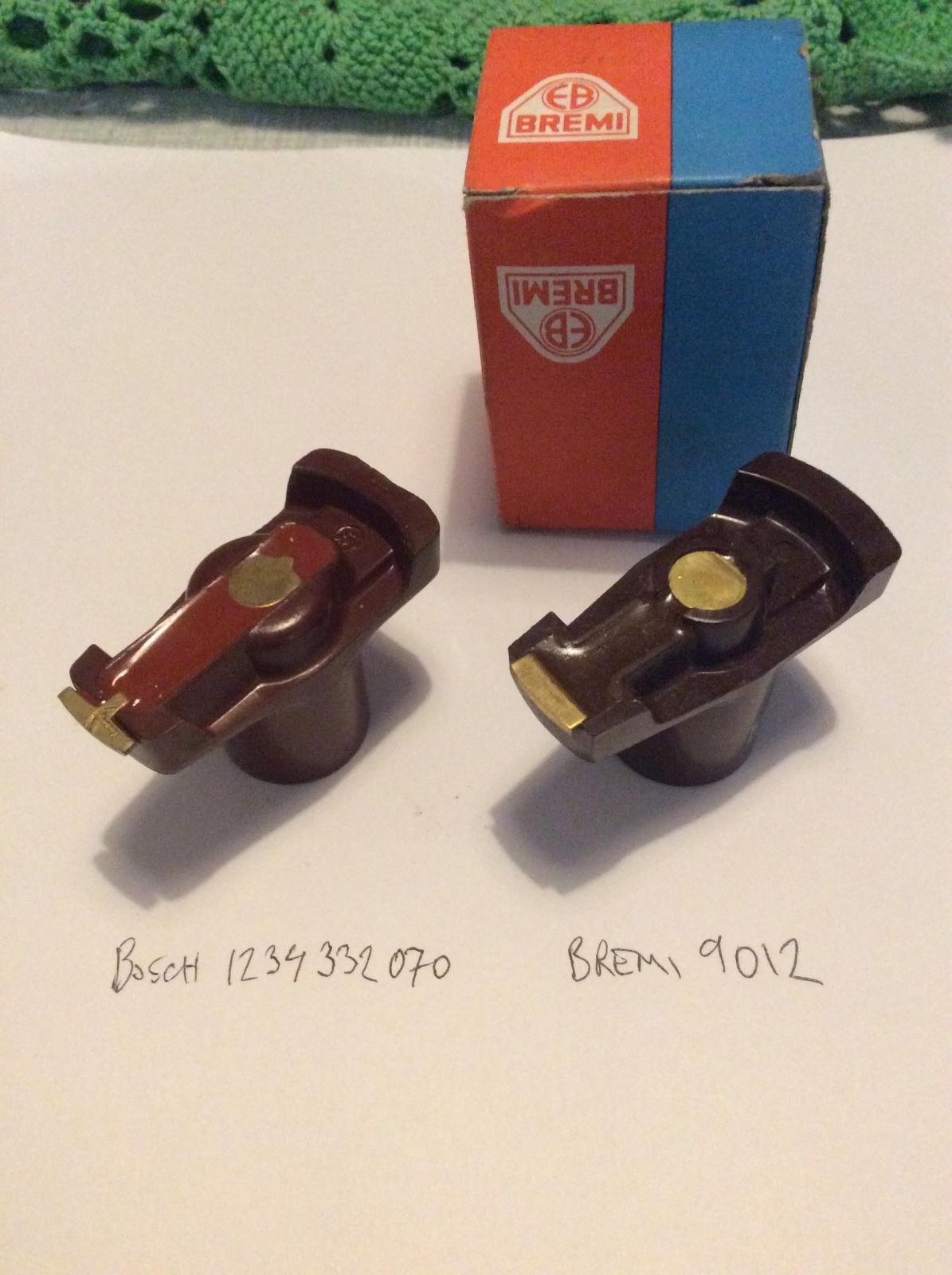

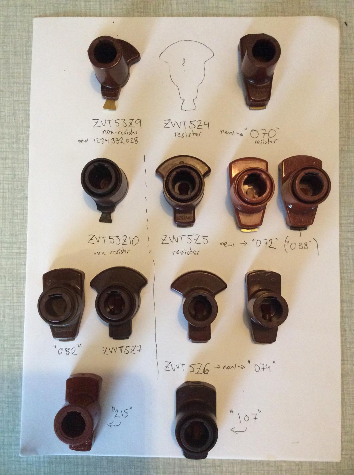

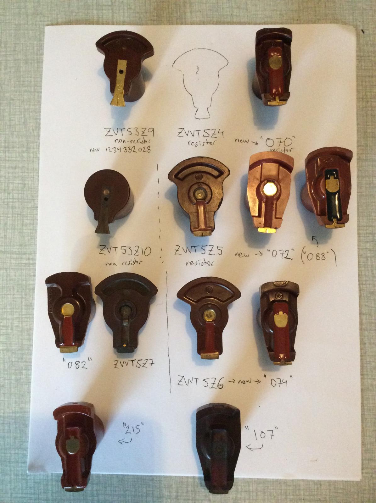

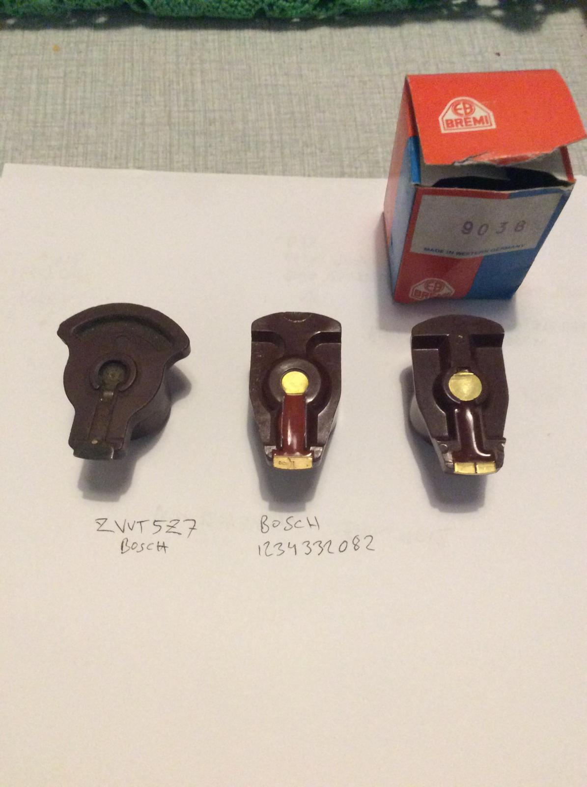

Didn't know where to put this but is sorting out my tune up parts and did a comparison of rotors. (Shorten down the 1 234 332 "..." in Bosch part numbers in the picture).
Top row is "36hp" rotors and a straight "family line", zvt53z9 non resistor and zvvt5z4 resistor version of "the same" rotor (old bosch part numbers) and 1 234 332 070 the new part number (and rotor) for the resistor version. In the next row (also "36hp") the new part number for the resistor verision zvvt5z5 is 1 234 332 072 (it's accually a dowal brand nos knock of in the picture, but the box was labeled with Bosch part number). I'm not 100% sure about this row, but to the right as comparison is todays often used replacement 1 234 332 088. The picture below explain the difference of the two rows of 36hp rotors. Second row of rotors have a grove in the bottom of the shaft for dust shielding.
1 234 332 082/zvvt5z7 (new/old) is the common "short" rotor used in many distributor mid 60's. 1 234 332 107 is a common late 60's/early 70's rotor, my 1980 Bosch parts display sign however show the 1 234 332 074 as replacement rotor (old number zvvt5z6) and again it appears as they (107/074) are dust shield vs non dust shield rotors? But dust shields also changed in design, the 1 234 332 215 rotor (common mid 70's rotor and replacement rotor) doesn't have any groove but was used with it's period dust shield as it just "fits" in the center hole.
