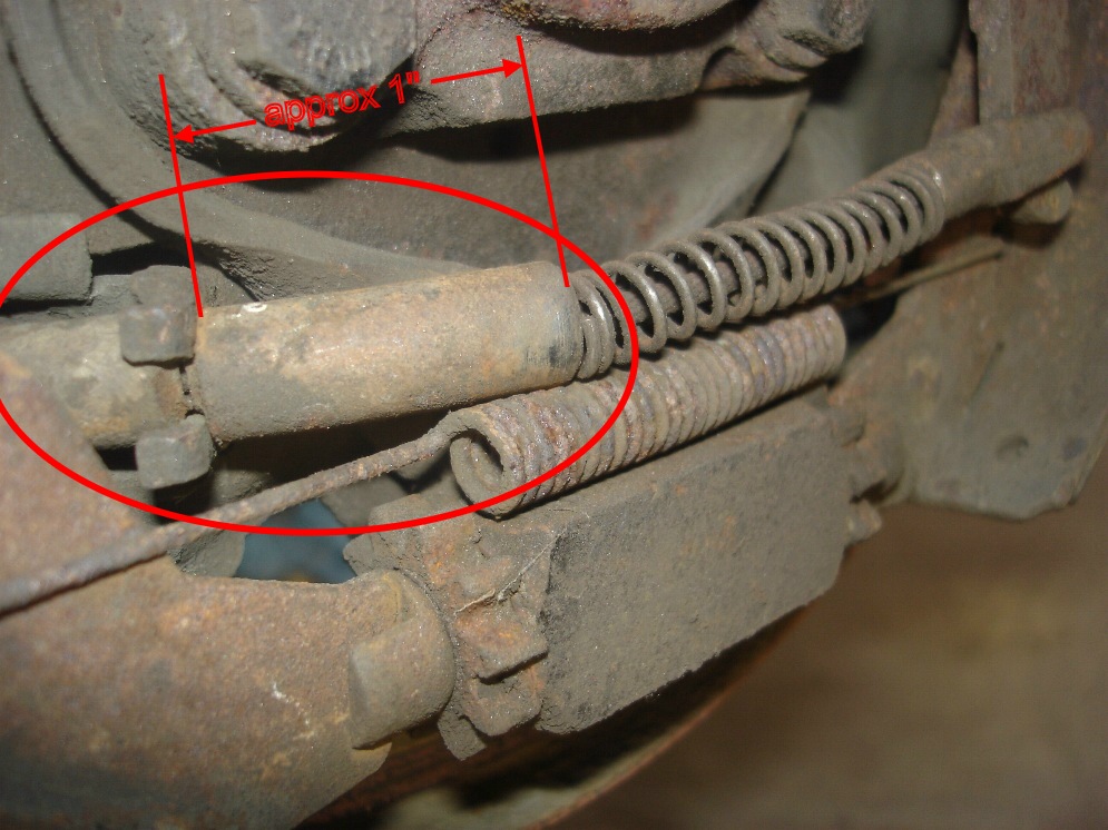

Do a search for "emergency brake cables" in the forum: I have a thread in there on how to modify the later model rear brake plate so you can use the earlier emergency brake cable. It is easy to do. Put the old brake plate next to a newer one and you will see what you have to do.

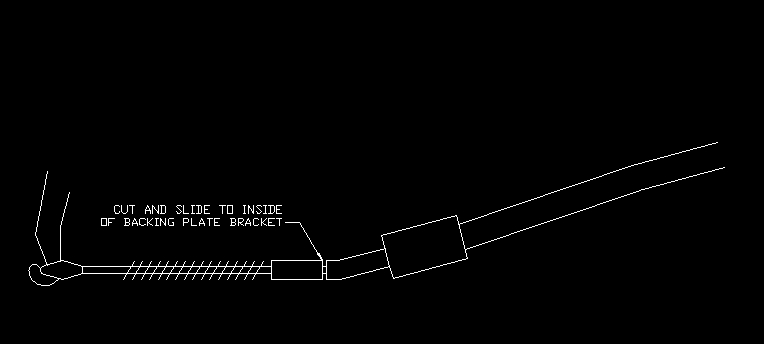

I modified the 58 ebrake cable to fit the later backing plates.
Why buy what you can build.

^^^ That looks like the best/easiest way to get this done. I like Cameron's idea, too. I will be doing this soon and have already bought new later cables since that was the only way I knew. Guess they will just go into the spare parts box now.
Going back to the idea of shortening the cable, does anyone know how much has to be cut off? I just figured that, for future reference, an actual length in inches (cm ?) should be posted. It would come in handy for a future search if someone is in a pinch for time/lack of proper parts.

Since it is easy to do, I think that fixing the brake plate so it looks like the older one is the way to go. The four spot welds holding the platform on the outside of the brake plate (the stop for the cable's housing) have to be ground down so it can be removed, the hole in the plate lengthened (look at the hole in the older brake plate), the axle end of the hole bent to the outside, then a hole drilled in the brake plate where a small bolt and nut will hold the cable stop that you use from the old brake plate in place. This method allows you to use the old style (shorter) emergency brake cables and it keeps the stock look.
Don't splice the cables.

Jeremy's setup would be pretty simple to replicate on the roadside, too. Just need something to cut the steel housing with.
Modifying the backing plates is nice because it allows use of the later, and more readily availabe, e-brake cables.
