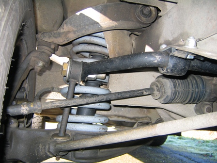

j_dirge wrote:
Anyone use the bigger swaybars in tandem with the H&R/GW springs?
Yep.
