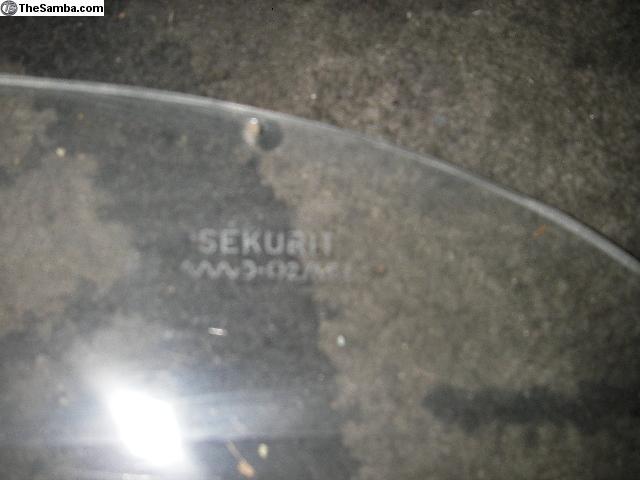

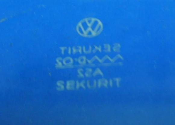

If you have any Oval-Window glass information, please add it to this thread, which is now in the FAQ.
Information posted by FRK in the past:
'56-'57 oval two small logos with ~D-02/AS2 in between (Lower logo backwards under the first logo)
Late '53 to end of July '55 big logo with ~D-02/AS2 under SEKURIT.
July '53 and older logo has a large SEKURIT and nothing else.
Kjell Roar

I just checked out the manufacturers "logo" on an original used Oval sedan windshield that I have stored for back-up use on my Sunroof if ever needed. Here is a shot of the logo:
Does anyone have any idea what type of glass and era (years) it is from?
Thanks!
Bill

PostPosted: Wed Jan 27, 2016 7:55 pm    Post subject: Re: Oval-Window Glass Reply with quote
I have a piece of rear glass & don't know if it's sedan or vert & have been unsuccessful looking through the other glass threads.
Single large SEKURIT with the squiggle / D-02 AS2 underneath... so I believe that's 54-July '55.
Width: 26.5" (~675mm)
Height: 10.75" (~275mm)
Convex high point (when laying flat): 1.5" (~40mm)
Thx,
e
aka: Evan
