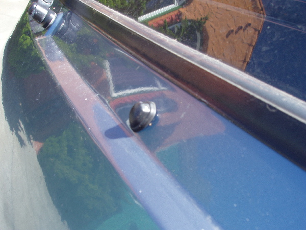

I have tested the 2-way washer jets from a 76-85 Porsche 911 and they fit without mod. The jets of water can be adjusted to hit the middle of the windshield at the extreme position of the adjustment. You should really adjust it so they hit the top of the windshield at stationary and then the water jets will hit the middle of the wind shield when you are driving at speed.
Cost is $8.25 not cheap but worth it. I have tested only the ones from Pelican parts so nozzles from other vendors may be different. Part number is 914-628-203-11-M78
http://www.pelicanparts.com/cgi-bin/smart/more_inf...1976-85%29
Edit:
The Porsche nozzle stands 6mm above the body panel and the OE nozzle stands 18mm above. So the jets are shooting at the glass at a much lower angle than the OE jets. That make it difficult to adjust the jets as a little angle change will results a big movement of where the water land on the windshield. The van I put the Porsche jets on has the chrome plastic insert and it stick out above the rubber. The water jets just barely clear that molding. You need lots and lots of patience to adjust the jets but you only need to do it once.
Also, the Porsche jets has a smaller base than the OE jet, so it will not cover up the old markings made by the old jets. The ends that goes into the body is exactly the same as the OE jets.
Have you driven the van at freeway speeds and verified that it still works? This is the reason why the cheap 2nd gen SMART car nozzles aren't a good solution.

Yes.
I installed one on the driver's side. If anything these squirters spray too high and they have to be adjusted down almost to the limit.
Works nicely, though. 6 months or so now.

So, it looks like a narrow window to clear the molding and still hit the windshield? Easy adjustment? The $60 ones sold by another Sambanista rise like 3/4" to clear that molding hurdle. Comments? Also, how do we find that squirter? Thanks for the update!
Exactly.
Yeah.. it takes a couple trial and error adjustments.. but you'll find the zone.

With only one dual jet installed, how can you stand it with one side of the windshield can be washed cleaner than the other side ?
