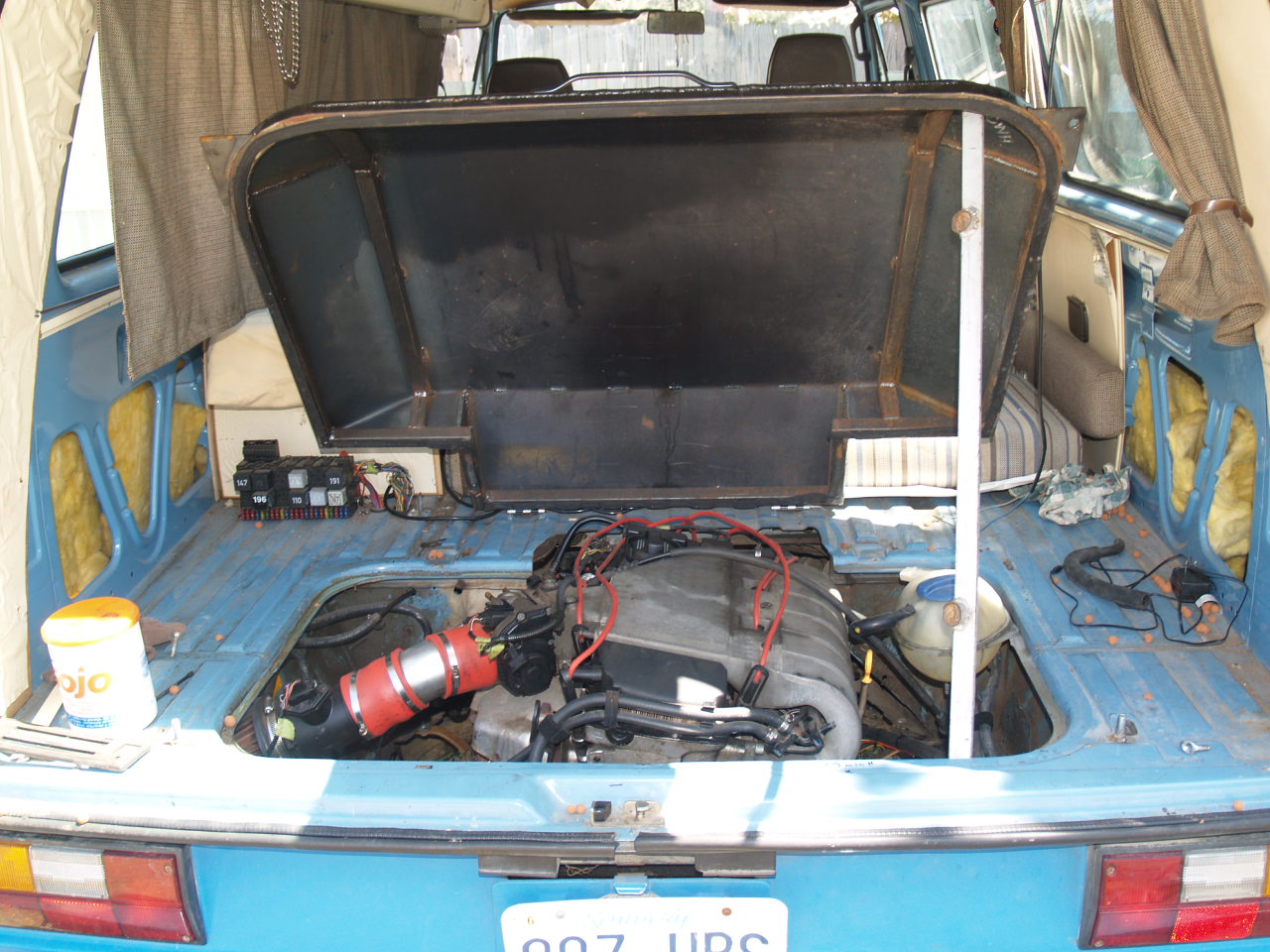

This has been done in a Syncro.
There is a Blue Galvanised Syncro (built by a factory worker) who installed a VR6 motor into the Syncro (with stock petrol tank).
It's now owned a friend of mine in UK. I'm sure he won't mind me putting up a couple of photos and I'll see if he's around to come on and help out with any questions asked...
One thing I do remember him saying is that it's a bit thirsty! but goes well!

Posted: Mon Jun 21, 2010 7:39 am Post subject: |
That's still a raised engine lid.
it's always been a loose opinion of mine "if you have to ask, it's probably no" but then that's a tad harsh.. and one has to ask in order to learn.
but looking at these if anyone could manage the skills to remake the intake system on these that's most of what is ABOVE the engine lid anyways.
sure you won't likely recreate the tuned intake signal that the factory engineers and computers did, but you may be able to sleep in the lower berth. make a tube intake log with the T-body orientated towards the PS tailight for an aircleaner.
In our I5 conversions we lowered as much as possible, but still removed the engine lid material just above the intake manifold, but it does NOT protrude above and only makes slight contact when the hatch is loaded with firewood.

danfromsyr wrote: |
but looking at these if anyone could manage the skills to remake the intake system on these that's most of what is ABOVE the engine lid anyways. |
It's not the stock VR intake that requires the raised lid. The red arrows point to the valve cover, and this is what makes the height an issue. No way to shrink that down.
As you can see (Green arrows) the throttle body and intake runners are flush or below the top of the engine. The blue arrow section of the intake that runs across the valve cover is only about 1.5" high, and this is running in a recessed area of the valve cover (which is again as low as possible).
Now to shift the valve cover lower would require lowering the whole engine. This isn't an option as the oil pan would then run way too close to the ground. There just isn't a way to get around a raised deck.

I guess the engine could have been mounted lower in the shell but as with all syncros, ground clearance is important.
I've managed to get a 2.5TDi 5 cyl into my Syncro 16 without having to raise the lid and without losing much ground clearance. I only dropped it an extra 20mm from stock.
The roof section at the front is a factory piece and came on late Westfalias inc the California and Atlantic and is meant to work with a sunroof. They're supposed to good for more mpg. I had one on Limey when I first fitted the roof but wanted the more storage space and was prepared to sacriface the mpg.
