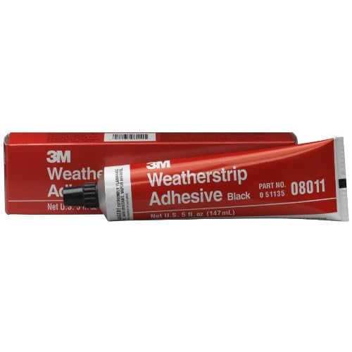

Urethane is not the right adhesive for a Vanagon. It has a roped-in windshield seal.
The right adhesive would be:
It's not even required but I would recommend it. Only put it on the metal-rubber side and not on the glass. _________________ 1986 Vanagon Westfalia EJ25
