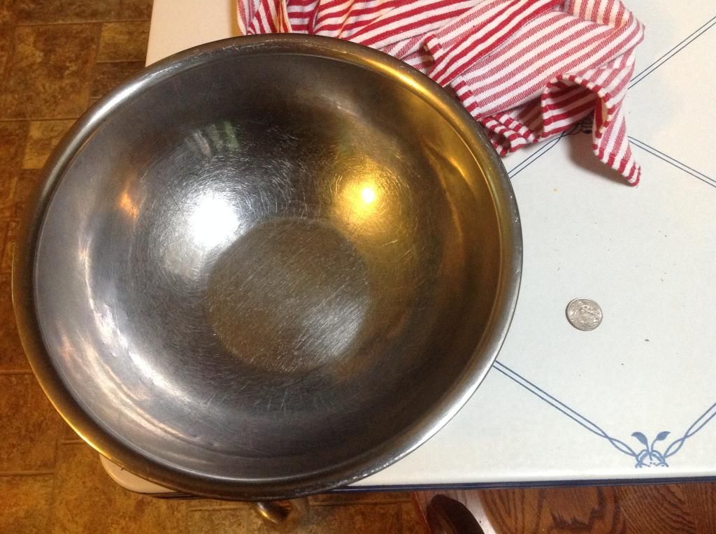

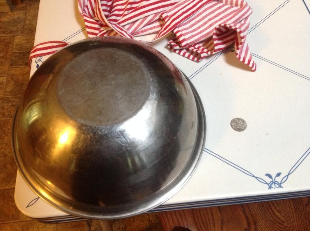

My major stumbling block is a small reasonably priced sink. Bar sinks are the front runner right now.
How about a deep stainless bowl? Otherwise, there are sometimes RV;s at junkyards, bet a sink could be had cheap there. I got one from an scrap boat, from a friend for free. Now to get around to that cabinet....

Hmmmmm.......
Just noticed my wife's stainless Steel bowl!
........sink..........
A hole in the bottom for a drain........... Think
(Thanks to msewalson)
Looking at hopefully making this sink.........and maybe the cabinet only more narrow.......... Cheap!!! $$$$. Shocked
