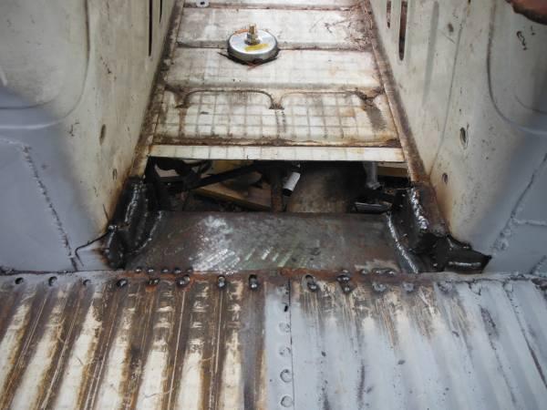

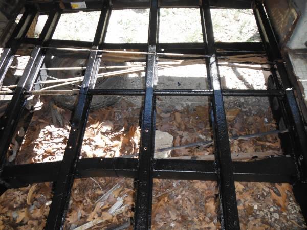

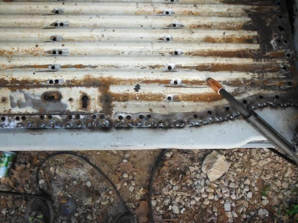

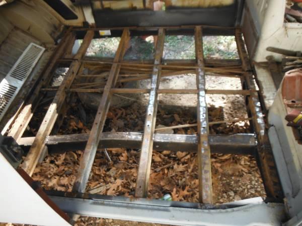

This is our thread about our restoration project (Fairsbanks) on a 1973 VW Bus Riviera. A little about this bus, it was purchased in Juneau Alaska in 1973, then moved the northern Mishigan in 1979, and now to Pacific Missouri in 2010. Our plan is to restore this bus back to a semi-rust-free van, we know you can't get then all, but we can get most. I know people say this bus will take way to much time, just find another one. Just keep in mind that time is not money for me. This time is something that I can learn from, and have fun doing no matter how difficult it might be.
So, this bus has already had one big project done, he is the thread; http://www.thesamba.com/vw/forum/viewtopic.php?t=423099&highlight=. This is our thread about the camper top restore, here a couple pictures of the finished product.

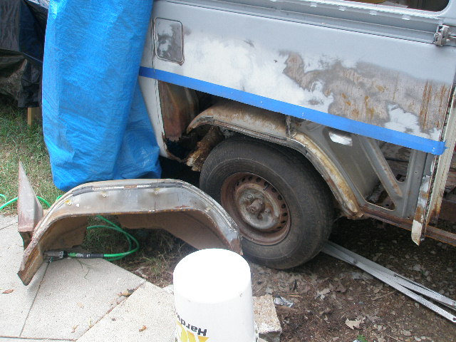

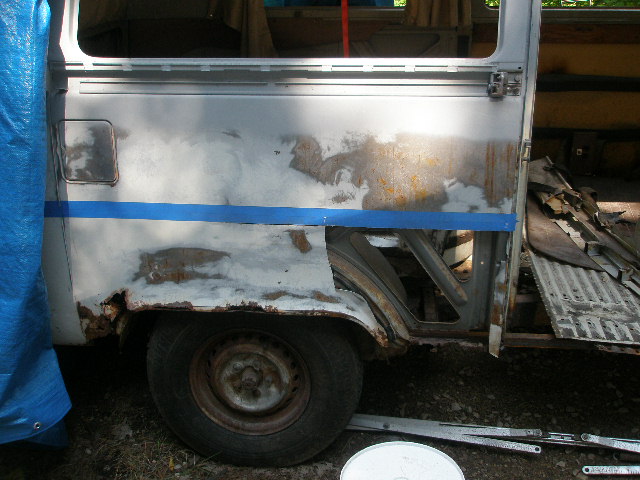

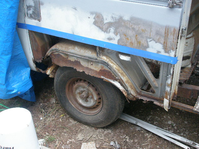

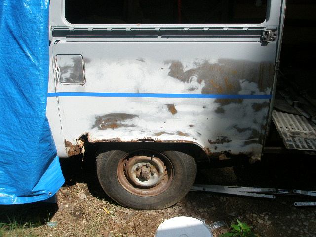

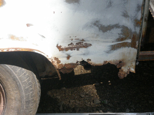

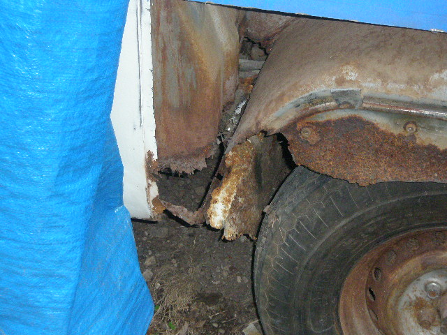

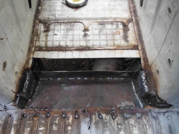

Now we are onto the project at hand, fixing the rust problems on the passenger rear of the bus. Here are some before pictures;
Need to cut below the blue tape
As you can see, there is a lot of rust on this bus, most likely the rustiest bus you will ever see.

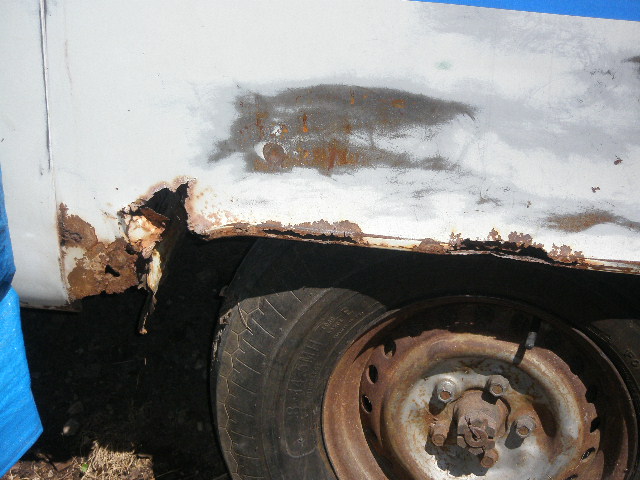

Here are some pictures of the removing of the rear wheel arch section.
Some cutting
Small section removed
Another view
The rear section, going to need a battery tray and maybe a new corner
Now the fully removed skin
The donor wheel arch from the juck bus we got

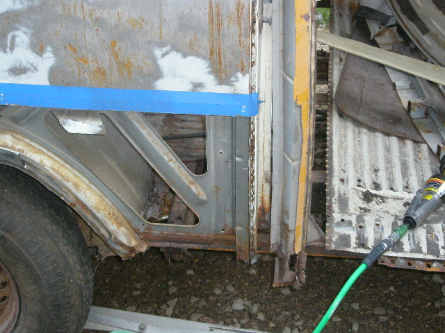

We are also going to be replacing the c-pillar on the passenger side, which we also got from the donor bus (will post a picture soon). Long story longer, we're going to be placing a big section of the rear wheel arch, then replacing the b-pillar, next onto the door track assembly, to the c-pillar, onto the rear wheel skin, and then the finishing touches. More pictures to come.
By the way, this is "Project Fairbanks." |

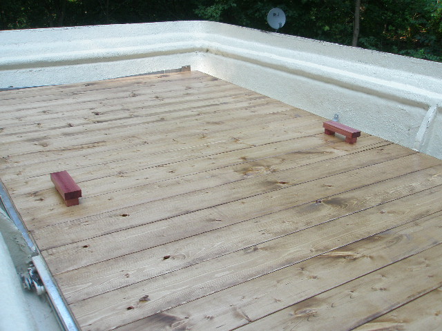

Are you re-inforcing the top? I have a riviera top on my bus and It's got a bit of sway in the middle If you're going through the repaint process please detail that for me. I still have to remove my top for some repairs. I'm thinking of lining it with some oak strips with stainless ribs (like an old truck bed) and building an overhead console to make my Dvd screen look a bit more finished out. _________________ One day as a lion, or a lifetime as lamb

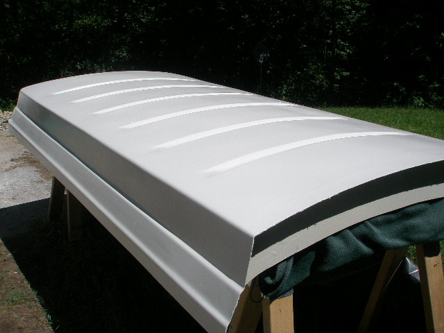

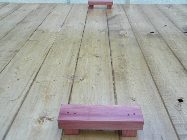

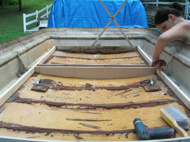

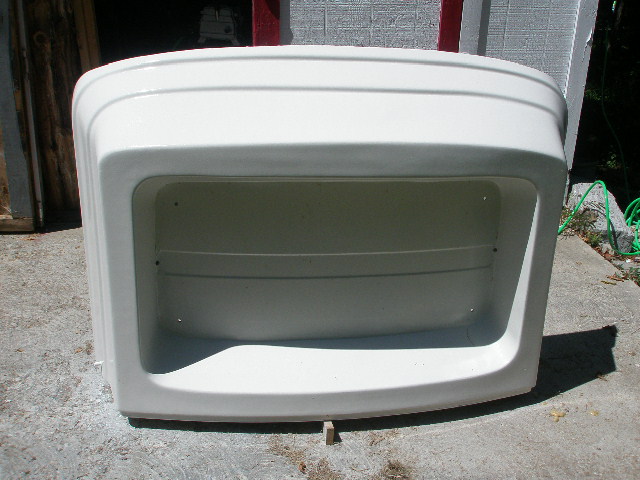

Yes the top was re-inforced by some 3/4" hickory wood that I had left over from a woodworking project. Actually you can check out the forum at the top of this thread, there is a link that takes you to the camp rebuild, but here is some infomation. I take one end off of the camper to use for a mold.
Bad picture, but here are to new arches for support where we had a crack
The arches are under the wood-slat top, and are where the new handles are going to be placed.

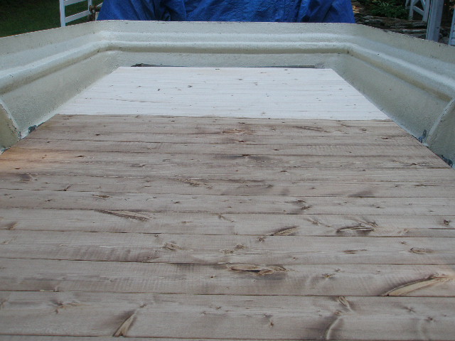

With the painting, I lightly sanded the entire fiberglass camper, filled and sanded all holes. We used an normal automotive body paint, but it was an enamal paint (don't mess up). I've heard of people using boat paint, but we went with an auto paint, has instructions on the can, and there is no instruction that can help you, you just have to do it. Let me know if you need more information and I can type something up on the other forum about the painting process. |

Chaz79, almost forgot, after screwing the new arches in place. I used two, not one, but two tubes of Liquid-Nails Construction Adhesieve to make sure that the arches were glued in place. We have moved the newly paint top a couple, including standing it upright on the side, and the top had no play in it.

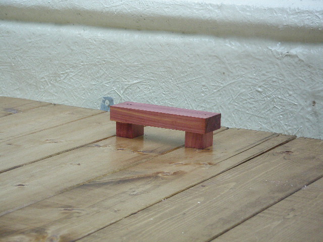

I didn't get much done today, the wife was doing laundry so I couldn't get any welding done. But on a brighter note, I was able to make two custom cedar handles, once again from some left-over wood from a previous project.

if u are going to be pulling and pushing on the handles u will want to use screws ceder in not the strongest wood. so be sure to pre drill _________________ currently 71 super auto-stick, 73 ghia, 71 yellow ghia , a 68 square w71 fi, a 77 bus station wagon deluxe. and finaly finaly a 74 riveria with volvo pawer .ITS AN ADDICTION!!! |

I actually have wooden pegs going through the center of both the handle and the block under it, and the block under the handle has a screw running through it attahing the the supports undern the wood slats. The handles "shouldn't" come flying off, but you never know. |

That top looks great. Did the wood planks add any extra weight? I would be concerned about the springs being able to hold it up.

I think with the two extra supports and the slat wood, I "might" have gained an extra 5lbs at the most. From what I remember about my top, I'm pretty sure that I took quite a bit of pulling down to get it to come down. I "think" that the extra wieght should be fine, but we'll find out once we get the new seals for it.

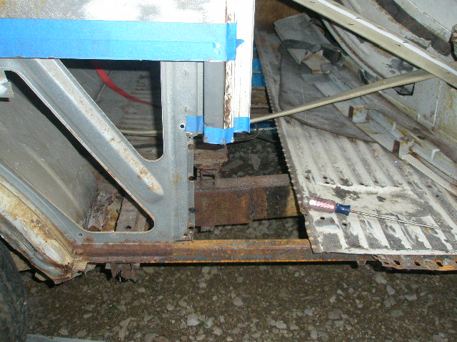

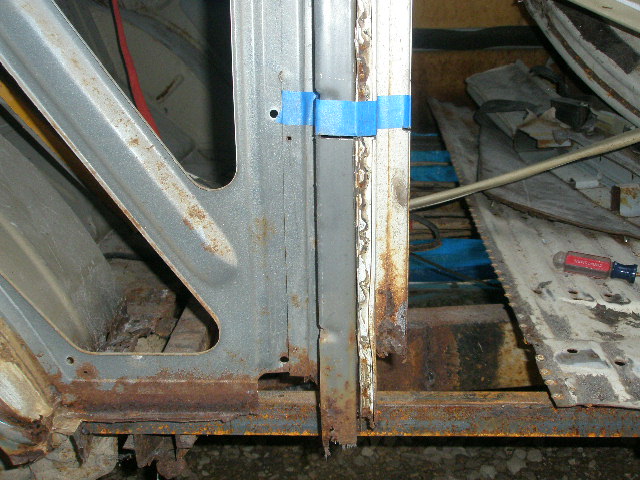

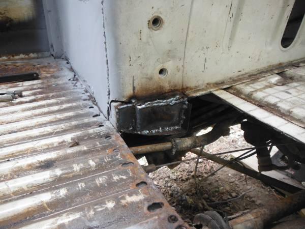

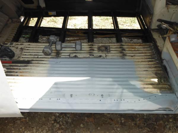

Si I had about an hour to work on Fairbanks tonight, not a ton done, but a c-pillar removed. This is going to be the removing and soon install of the slightly used c-pillar from a 34 year old donor.

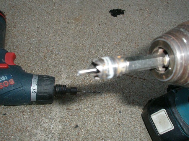

Before cutting out the rusted c-pillar, I have to remove the spot-welds from the cargo area of the bus. I use a cheapo Harbor Frieght spot-welder cutter bit. I start by either using a punch and a small drill bit the center a hole on the spot-weld. Here's a picture of both.
Before the cut, will be cutting below the tape again.
After the cut
My next task will be removing all the old metal from the donor c-pillar, pictures to come soon.[/img] |
