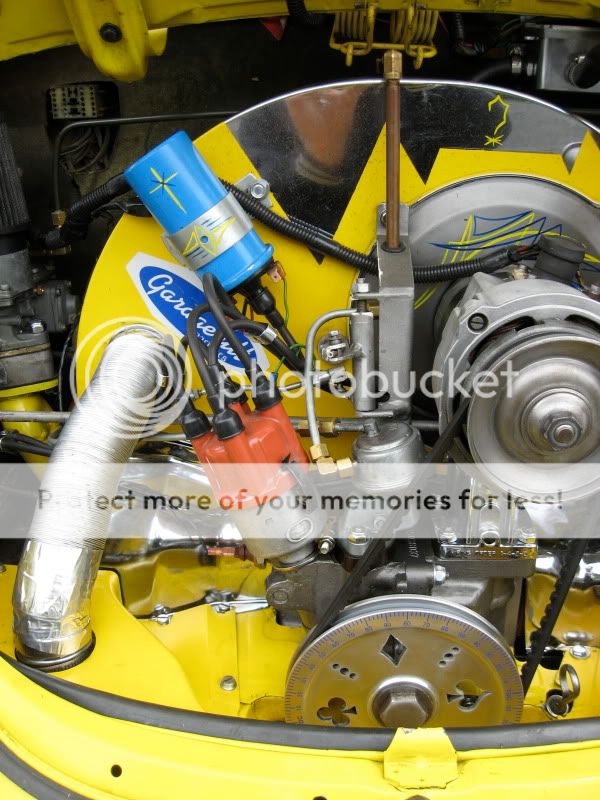

made my own with compression fittings -

Mike, keep a careful eye on that set up. BrasS don't bite in to steel very well.

It'll probably hold just fine, but you're right about stainless being a much better choice.

with as tight as the ferules sunk in round the steel line, leakage/seepage wasn't really on my radar, but will watch for it.
