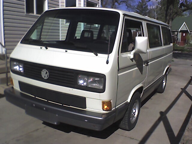

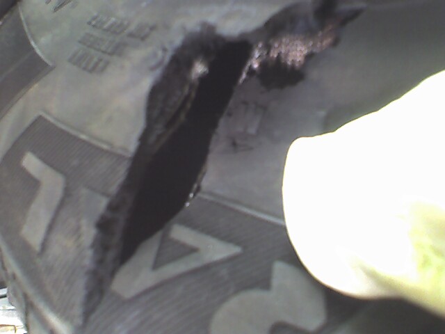

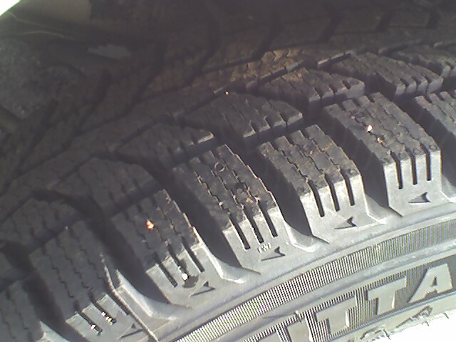

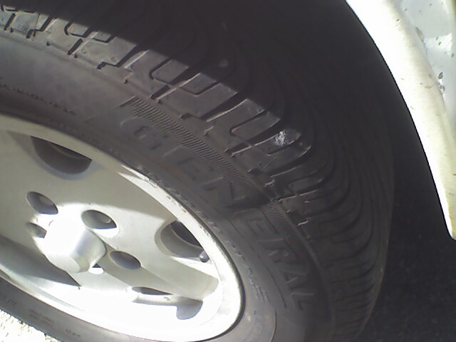

I bought my current van with a set of Nokian Hakka 205/70/14 tires on it. Those were the best handling tires I've ever had on a vanagon. Very stable and assured when cornering. Those nokians exceeded the load rating for vanagons. They were wide with a very squared off profile like this:
When I replaced them I cheaped out and bought the General Altimax RT 205/70R14 tires. They have a more rounded profile, and despite being advertised as size 205/70/14, I could see that they were not as wide as my Nokians. They also did not handle very well through corners. I had to seriously reduce my speed because I got that sort of wallowing "marshmallow" feel while driving through corners or in sidewinds. After a few thousand miles two of the General Altimax RT tires developed strange indentations in the sidewalls that hinted at something structural changing beneath the surface of the tire. Looked like this:
I told myself, "Self, you'd better put some different tires on that van before you have a blowout." But before I got around to it my rear tire blew out while driving on the highway. (Blewout on the inside of the tire--facing the transmission--not the outside where the depressions appeared.) I can't say for sure what caused the blowout. I was on a highway with no shoulder, and since I had to drive on the damaged tire (at low speed!) to get off the highway I don't know how much of the damage was caused by the initial blowout, and how much was caused by driving on it. Here's how it looked:
So I bought another set of Nokians from Van-Cafe. I bought whatever they had in stock, which was the 185R14 hakka snow tire, designed for vans, load rating 102, good snow tire. Tread looks like this:
So here's my subjective evaluation, based on a sample size of 1. (That's me, I'm the single test in this experiment.):
Nokian 185R14's are good tires, handle relatively well. Not as good as the 205's did but road handling is acceptable, and appreciably better then the General Altimax. The Nokians give me peace of mind knowing that they can handle the weight of the van, can handle snow and mud, not showing any wierd deformations in the rubber.
Nokian 205/70/14's were excellent handling, very stable tires, far preferable to other 14 inch choices. The nokian website does not show them for sale anymore and I don't know if you can get them anymore.
General Altimax RT 204/70R14 were inexpensive, and that's the only good thing I can say about them. I was not satisfied with the driving characteristics nor the longevity of these General tires.
Did you get the Hakka c or the Hakkapeliitta c's?? I thought the Hakka c's were more of a summer tire and the Haakkapeliita's are more of a winter/mud all season tire.
oh I can see the lettering on your picture-- looks like Hakkapeliitta is written on your sidewall.
i'm not nit-picking, i just mention this for clarification.

PostPosted: Fri Sep 24, 2010 1:44 pm    Post subject: Reply with quote
They are Hakkapeliitta's. I didn't realize there was another version called "Hakka," I just shortened the name because I didn't want to type all those letters.
I'm having the exact same problem with these tires. The PO had bought them they have about 10k on them. I'm going to replacing the General Atimax RT this week.
